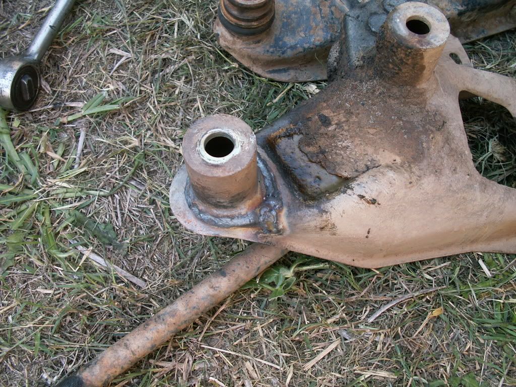

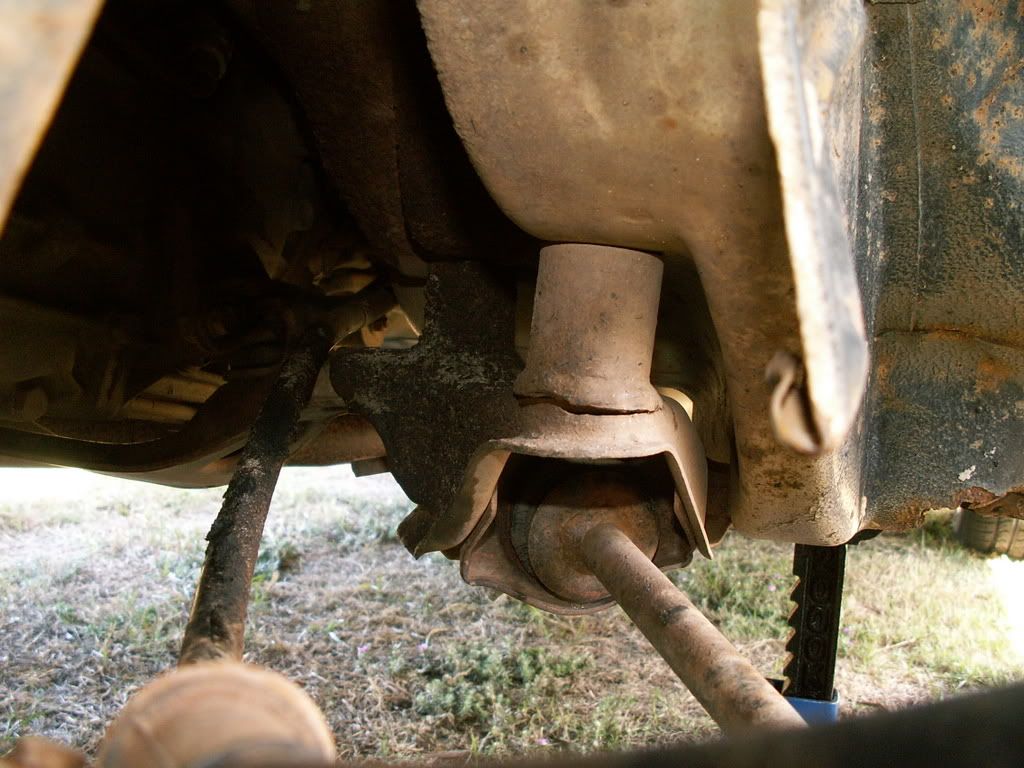

Post by Subafury » Tue Oct 23, 2007 10:23 pm
i was just after a couple on how you solved the problem at the front end, not
so much any more but for the thread.
i got mine mig welded up today. see finished pics. i hope they will be alright because the repairman said he never wants to see me again (bitch of a job coz of the thin chassis rails). although i had to brake harshly on the drive home during which i heard a clunk. like a bolt boppin up n down :s. although i should say i didnt need to recapture a new nut for the gbox x member one as iit already had an extra nut on top of it(stripped captive nut) since the beginning of liftkit.
see pix below
theres some blurry before shots where i had just stick welded the plates on.
tuff welds - i hope
