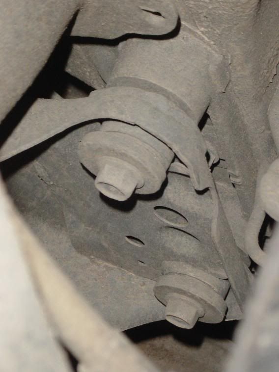

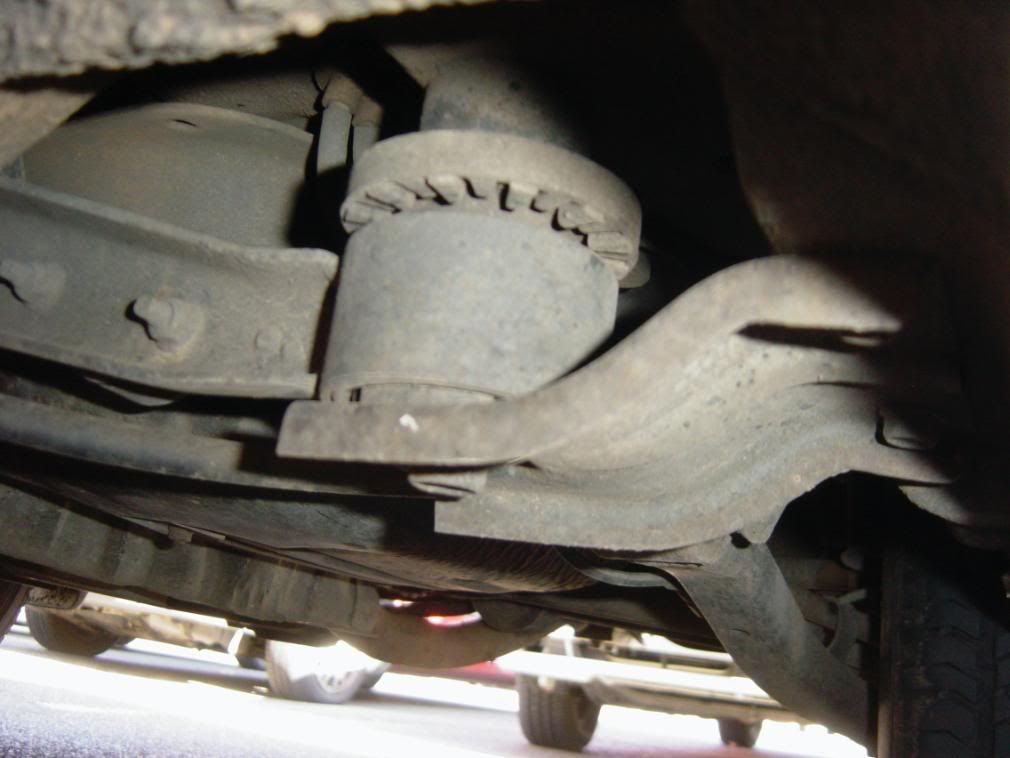

Post by AlpineRaven » Fri Jun 06, 2008 7:54 pm
Okay,Yeah I get it now, Yeah my liberty is showing like this \-/ and the tyres are lampy on the outside section.
There is no adjustment bolts for camber.
Only problem is, if you install them on the rear then you will need bigger hole for the adjustment.
But I've thought of something better, is to install blocks on the diff carrier to same specifications as Outback then that will improve the negative camber.
That only affects on lifted Liberty. So I will make the blocks over the weekend or next week and install it to see if it does improve or not.
Post by AlpineRaven » Fri Jun 06, 2008 7:56 pm
Oh.. this is similar what I am planning to do but make my own blocks for that -
I need to get the measurements off from outback and get the block made up. These two photos are from Outback.
I am so sure it will solve all camber problems.

Post by 00outback » Sat Jun 07, 2008 11:02 am
AlpineRaven can you let us all know if this solves your camber problems.
