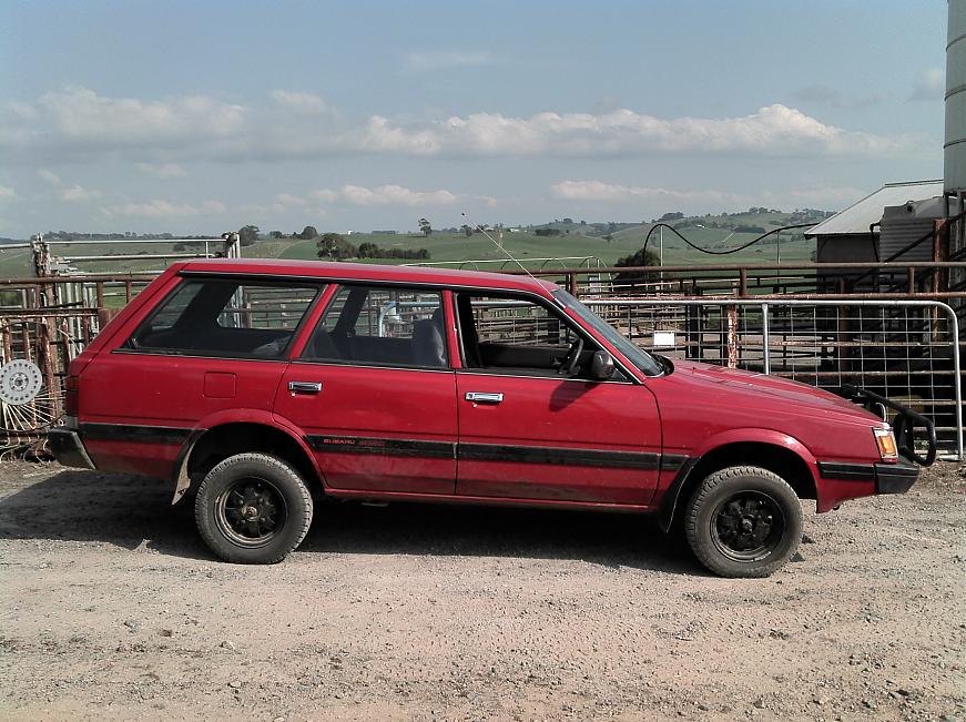

Post by skrewd » Sat Mar 19, 2011 4:26 pm
well what a day, but alls good 5.5 hrs to fit the whole kit looks heaps better now. thanks for your help and will post pics soon
skrewd
Posts: 83
Joined: Thu Jan 27, 2011 8:38 pm
Location: Drouin, Victoria
Post by skrewd » Sat Mar 19, 2011 5:28 pm
there ya go, thats it lifted just gotta get my new wheels now

Post by Milla » Mon Mar 21, 2011 4:28 pm
nice work, 2" all round i take it? who did u get the kit from?

Post by skrewd » Mon Mar 21, 2011 4:42 pm
Milla wrote:nice work, 2" all round i take it? who did u get the kit from?
thanks Milla, just need a set of 14 inch rims now and i'll be set. i bought the kit through this site from a dude named Fatz from Tassie.
