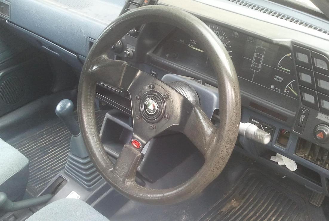

Post by alx92 » Mon Dec 12, 2011 4:03 pm
at last the correct boss is here and the sports wheel is where it should be... definitely an improvement i think
