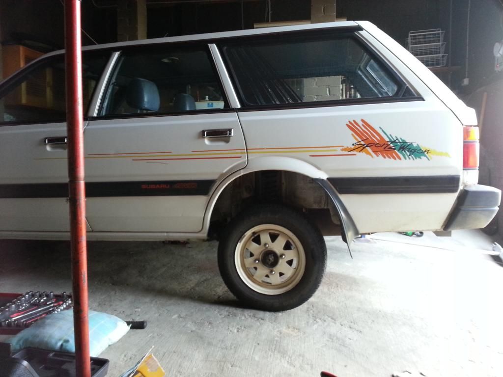

So I found some motivation today to begin installing my lift kit which had sat in the garage for a good 6 months now. Didnt get off to a good start, rusted on lug nut + rattle gun:
After that little mishap, it was all pretty much smooth sailing. Had no idea what I was doing due to the instructions being basically a single page diagram of roughly where each block goes. Started with the rear end, and thankfully it started to make sense pretty quick what I needed to do.

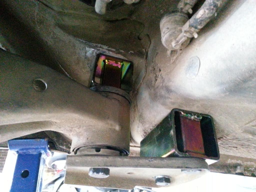

The blocks in place:

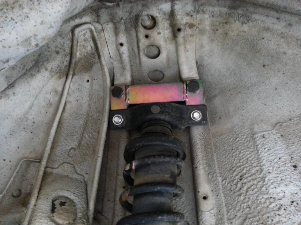

And the final product:
So thats the rear done, will probably get stuck into the front tomorrow although I have to admit im very daunted by it, seems a lot more difficult than the rear end, so if theres any advice or things to watch for please do tell me! Once I have it all finished I will be putting these shiny fellas on, 14" sunraysias:

ratters wrote:Image
The rear block in the above pic has to be above the suspension K frame part.

Times 2 for what Bennie said, ie, the spacer on the left is OK but the one on the right is on the wrong side of the suspention. Where it is currently located is isnt doing anything to lift the car.

Fitted this way will cuse the K frame to flex too much. You shouldn't need pics, just take the small block and put it between the body and K frame (not between the K frame and retainer plate, like it is in your pic) and it will be sweet.

OK, so howabout now? I think where i went wrong was when lowering the jack and the gaps opening up for the blocks to fit in that this part stayed up so i didnt realise the block went up there. Thanks so much for pointing it out as being wrong, it would have been left incorrect!
Posts: 12649
Post by El_Freddo » Sun Nov 11, 2012 12:10 pm
That's much better!

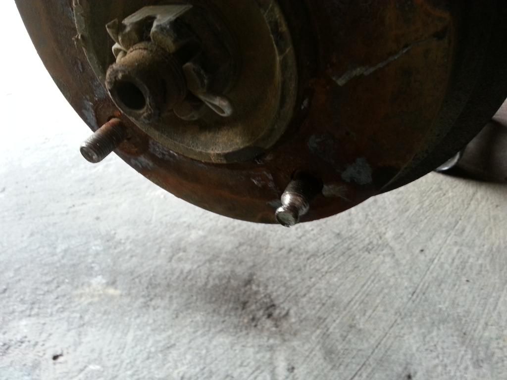

So I got started on the front on Sunday, bloody hell some serious drama there!
The engine cross member bolts which have the plate attached on top had their nuts rusted on good on the drivers side. And to make matters worse Subaru decided to make those nuts from actual cheese. I ended up stripping both of them. Even with high quality sockets, penetrating oil and a good solid hold the sockets just ate them up. So a long story short is that 3hrs later, and after 15 odd dremel cut off discs I got that bloody thing out! And of course its made of high tensile steel so my attempts at drilling it just resulted in a ruined drillbit.
The passenger side went like a charm, still very tight but a couple of loud 'cracks' and both nuts gave way, and were not rusted like the drivers side.

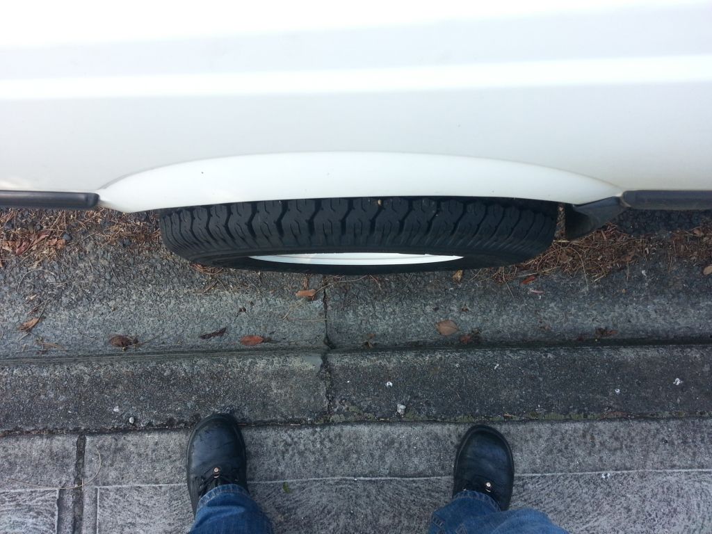

OK well here she is! Got the new tyres fitted today. They actually rub on the front plastic mud guards while turning and the suspension being compressed, but on the flat it seems OK. the guards may have to come off though? what have other people experienced? Also Im going to need to get a set of flexi flares as you can see they do sit pretty wide! All up though im quite happy with it and it really does feel a lot higher!
