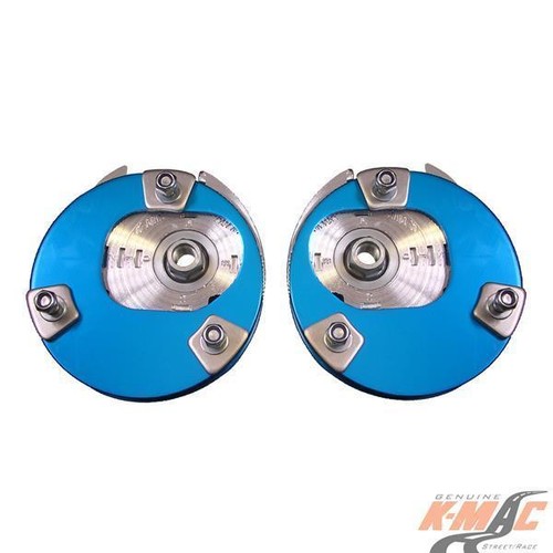

Tops ...
Found a picture to go with this :
From here : http://www.ebay.com.au/itm/Subaru-L-Ser ... 1e955ec41f
Has anybody installed one of these ? Doesn't look like it would fit without drilling holes to suit ...
