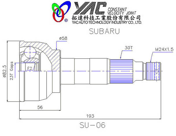

Post by Bantum » Fri Oct 16, 2015 3:42 am
You'll want a M24 x 1.5 Die : ( Right handed thread )
Edit : Lefty - Loosens & Righty - Tightens
Clean up with one of these :
( another handy tool to add to the workshop )
Cheers, Bantum ...

I live and breath technical drawings in my day job. I really miss not having a full data pack on my car. Nice one, and where's the rest..... 😉
The problem he'll have with that die is starting it on the thread, as with a nut. Not that I have a better solution.
