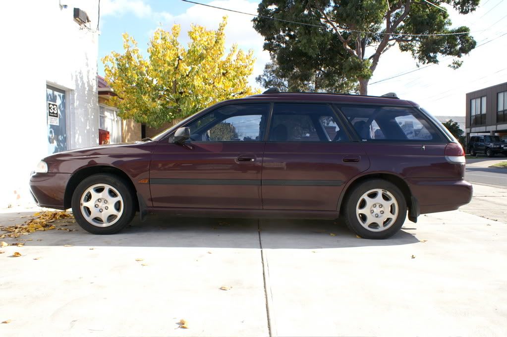

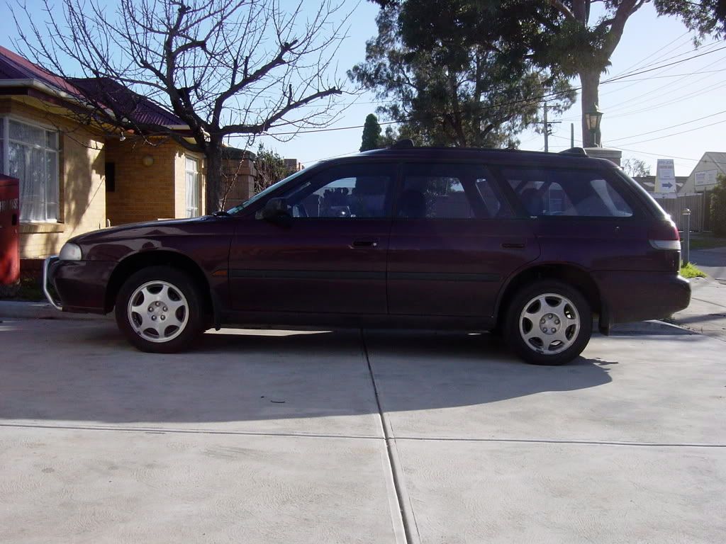

Post by AlpineRaven » Tue Nov 27, 2007 4:50 pm
Standard Outback struts, used Liberty springs, paid $260 for all 4, I got retail price thru a mate of mine (he wont sell me struts again as was once off). Future plan is to install Kings raised coils $240 for a set of 4.
Before Lift -
After Lift -
