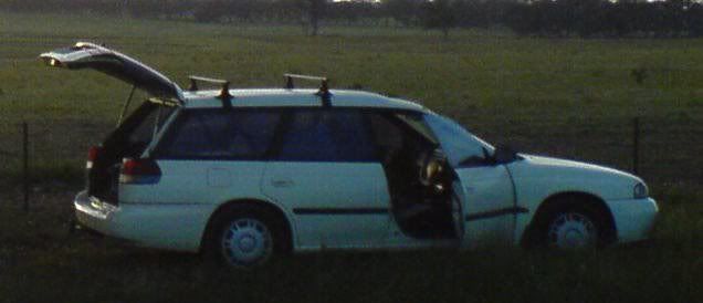

yep its got 14" wheels at the moment, 185/70R14. its a 6/1994 liberty, so thats the 6/94-98 model, i should have a pic here somewhere

this is the only pic i've got on hand-
its gen 2, no question. ok so i need to get longer struts from an outback, there's some on a nearby wreckers i can grab, but what other parts need to be changed to fit as well? which of the following would be the same or need to be changed?
