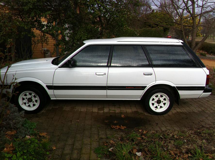

Thought i'd say hello and post a pic of my wagon I just picked up for $400.
It's a 1990, 5 speed, dual range, Mpfi with 290,000kms but has had an exchanged engine at some point in it's life.
It hasn't run for a few years so i'm going to replace the old fuel, oil, coolant and filters, chuck in a new battery and see what happens.
Wish me luck!

Post by El_Freddo » Fri Aug 23, 2013 9:15 pm
Welcome to the forum Phil!
I'm sure she'll fire up just fine once you've got some fresh fuel in there and a battery ;)

Post by steptoe » Fri Aug 23, 2013 9:58 pm
Some might say you stole it at $400 :p
Looks good in white !

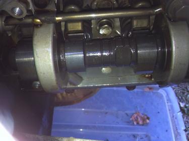

A couple of surprises i found today...
[ATTACH]4231[/ATTACH]
Seized idler pulley bearing

The cam belts were pretty loose so I tightened them up. I've replaced the split hoses and just need ti pick up a new bearing for the idler pulley.
I'm going to pull the oil pump one day this week and make sure it's working properly but i'm pretty busy with work so i'll see how I go.
Post by steptoe » Mon Aug 26, 2013 8:09 am
you will need some fine skills to replace that idler bearing and keep it all running true...I tried once, stuffed up once, gave up......
