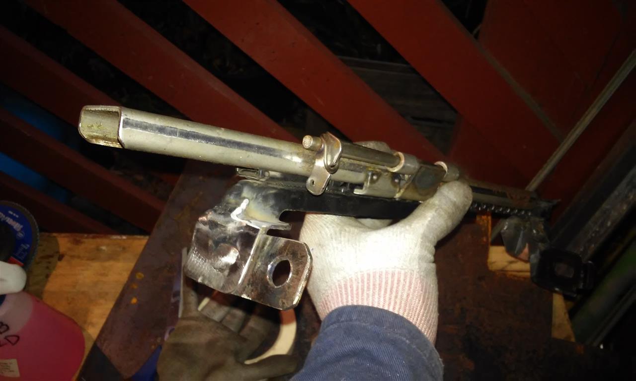

Some progress on the interior has been made :o Today I trekked over to the north side of town to Subareck and got some really useful bits that I've been chasing for a while. Namely some decent seats, these are out of a Gen 3 outback (I think?) they're not the leather kind but they were the only pair of seats within reach I could find that weren't green from damp :rolleyes: or worn out, and that had a good chance of fitting in the wagon . They've got the two adjuster wheels on the side, drivers seat has a lower back support adjustment. They're in quite good condition but still need a proper wash. Good enough for now that I can fit them.

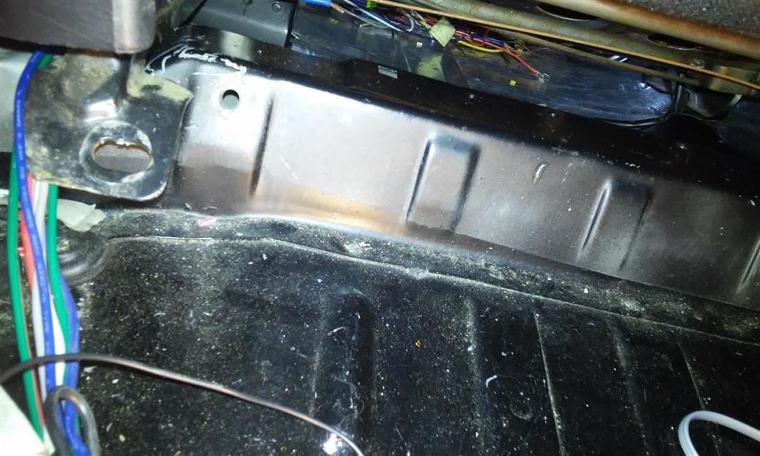

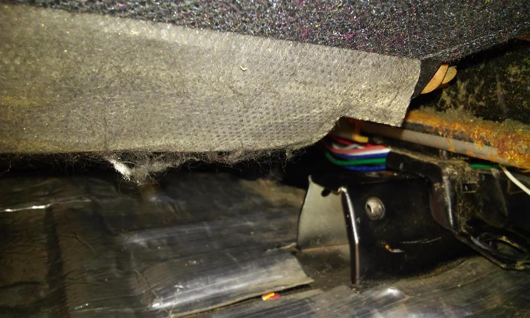

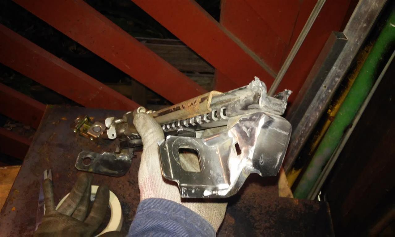

Looks like I got the right ones, the physical size of them is just right to go between the trans tunnel and sill. The rails/runners don't line up perfectly, I could get one bolt in at the front, the other front was 30mm to one side and the rear ones are way off. I opted to use the rails that were on it instead of retrofitting the MY rails. I was able to un-bolt the outer rail so I could modify (read - cut, weld, grind, fabricate) the mounts then bolt it back to the seat and drop it in. The rear inner mount is going to be a bit more tricky. In the pics below the big threaded hole you can see on the trans tunnel is usually for the seatbelt buckle, but the new seats have the buckle bolted to them so I can use this hole to mount the seat.
Pics below. Yes I scratched the hell out of my floor paint but I don't much care, I'll just touch it up before I put the carpet down. Also these seats are bloody heavy!
Rear inner mount. just a little bit off.
Rear outer mount, had to move it over 55mm and push it forward 50mm
Front inner mount lines up!
Front outer just 30mm off, and no that wiring isn't crushed under the seat - photograph illusion
Front outer mount modded with 3mm plate

Post by Silverbullet » Sat Jul 09, 2016 7:25 pm
Rear outer mount modded. CAD helps alot here (cardboard aided design)
Bolted up
She's in! Perfect height and positioning too.
Might I say, these seats are bloody comfortable :) Having sat on Brumby seats for the last 3 years with no side support or lower back support, these Outback seats are out of this world :) Really supportive, can tell it will hold me really well through those tight corners :twisted:
And now I've got something to sit on for the upcoming test drive :twisted:

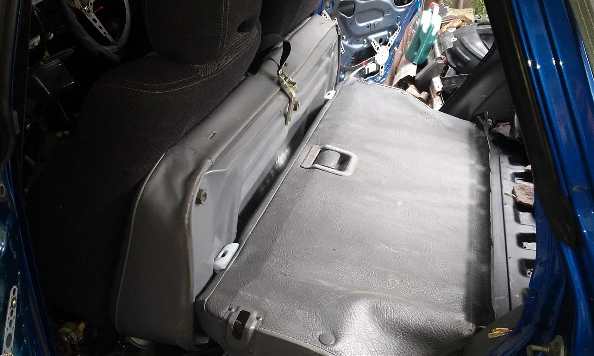

Post by Silverbullet » Sat Jul 30, 2016 6:59 pm
Last week I went down to U-pull it and found 4 MY wagons to choose from :) One had a really good condition interior so I nabbed the rear seat from it to replace my original one that was pretty knackered. I will still get this one re-upholstered since it has sun-cracked parts in the top corners and also to match the front seats colour. For now they were good enough to bolt in to get a look at how everything fits with the new front seats too. Pleased to say everything looks good even with the larger Outback seats up front. I can still fold the rear seat down flat and have comfortable leg room in the front. Likewise can have passable leg room for rear passengers and also still good in the front :cool:
The rear seat will stay in there now until I get it re-upholstered to free up some much needed shed space.
20160730_133601 (Medium).jpg (104.92 KiB) Viewed 33258 times
20160730_133530 (Medium).jpg (101.72 KiB) Viewed 33258 times

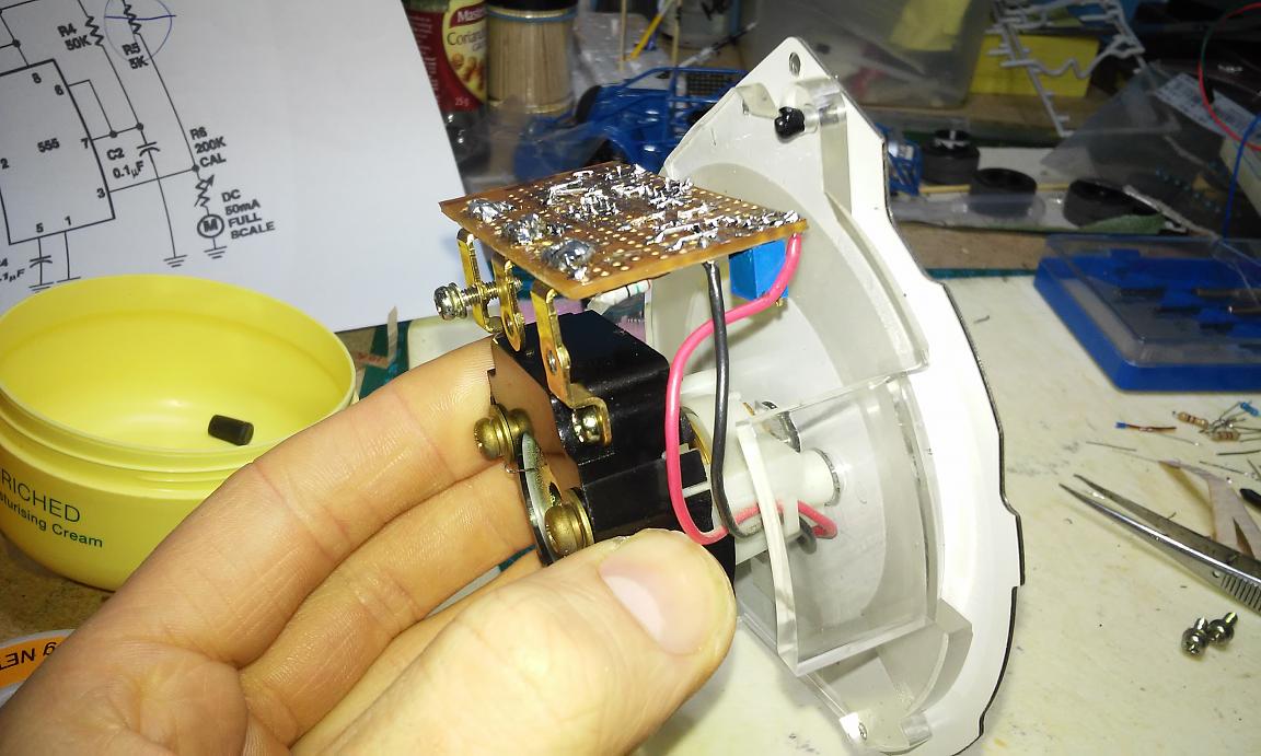

But I spent most of today working on the custom tacho circuit - using a NE555 timer chip. I've made a piece of prototyping PCB that will go in place of the original circuit board, today I mocked up the circuit on a bread board to make sure it was going to work. Amazingly, it worked! :cool: Check out the video below; there are 2 relays (working bloody hard!) being triggered at 60hz by an Arduino to simulate the "points" signal to the circuit. Calibration is just using a trimpot and adjusting the needle to read 3k rpm at 60hz which will make it right for anyone else. In my case because I'm using a twin coil pack that gets fired half as often I have to make it read 6k rpm...when it's all put together in the instrument cluster.

Took 2 attempts to get this to work, which included ripping everything that I'd done off the board once because the circuit I followed didn't work. Then the second iteration didn't work initially, I found I'd put a junction of 2 resistors on the wrong side of a a capacitor. Fixed that and it works pretty nice :) The needle is a little jumpy on the lower positions hopefully I can smooth that out somehow. Have yet to test it in the car. The little blue thing you can see in the second photo is the trimpot for calibration.

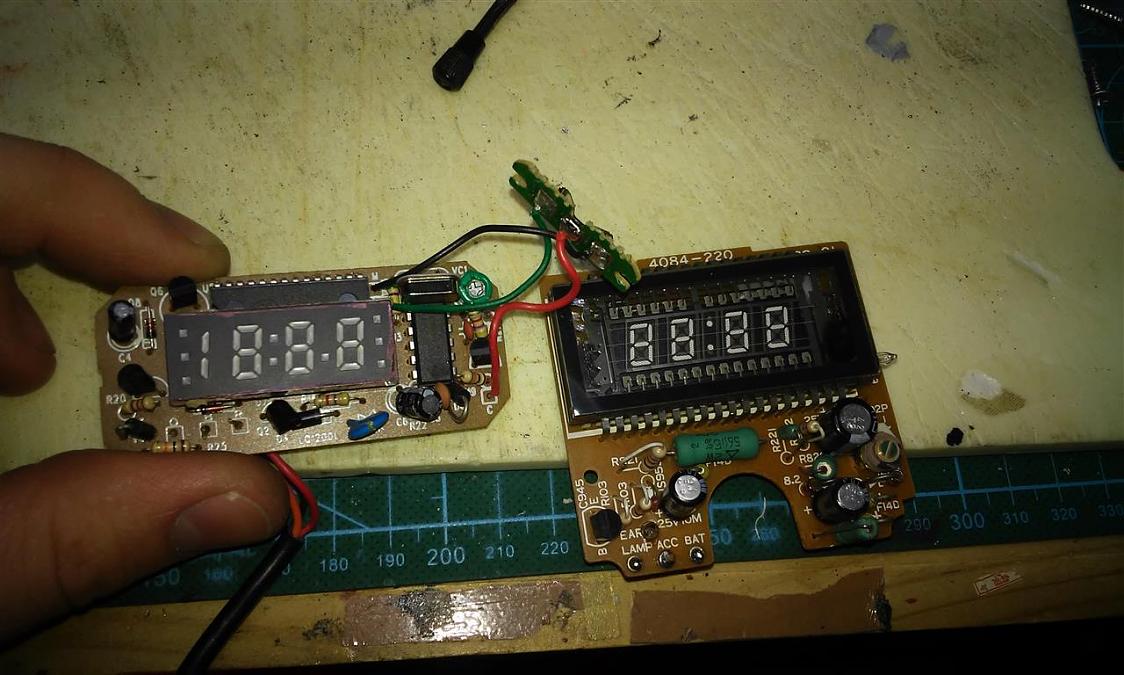

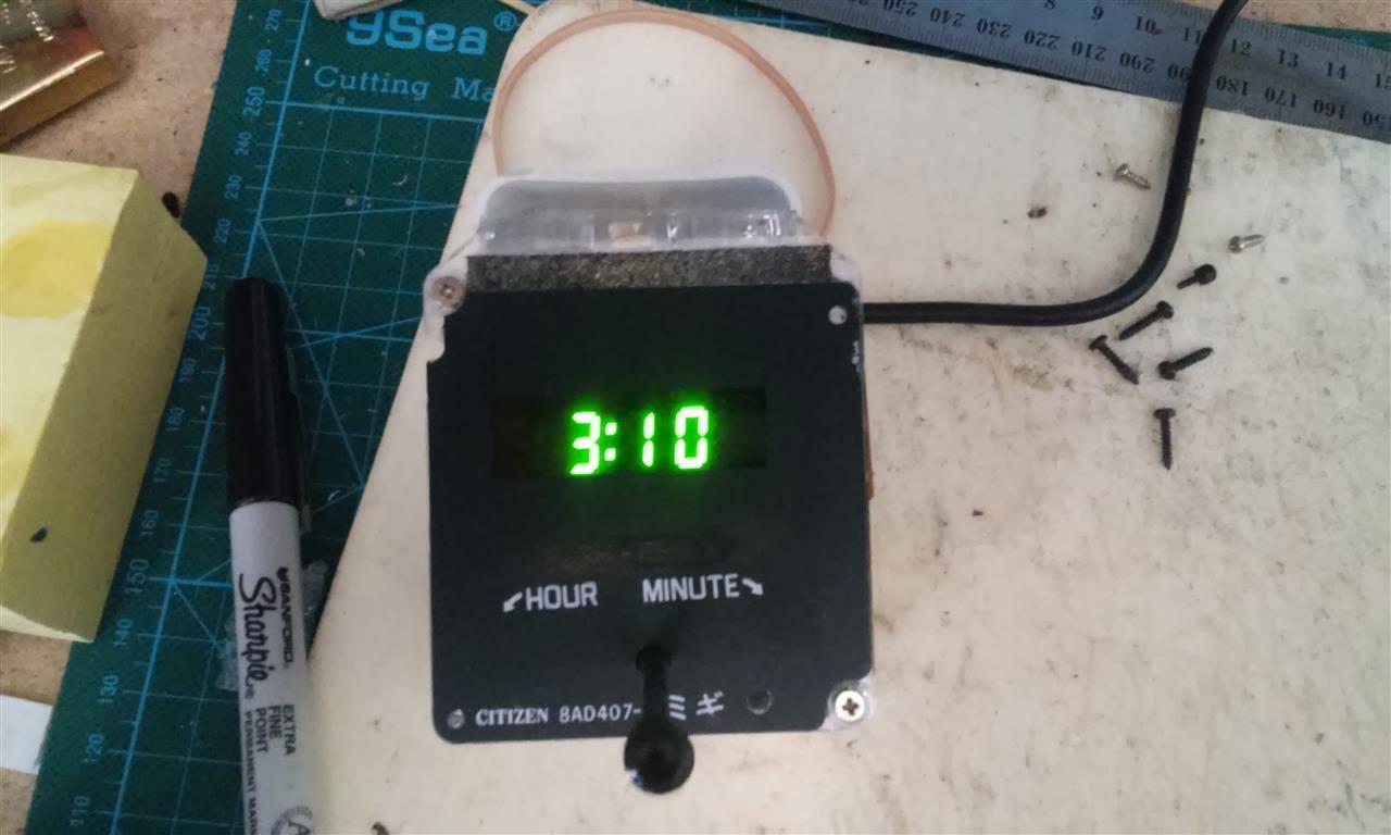

Another step towards having a fully functional 6 gauge instrument cluster :) When I got this instrument cluster from NZ the digital clock did not work. I touched up all the solder joints on the PCB inside etc but it didn't come back to life :( The old clocks display is fascinating, it is one big sealed glass block with the digits inside. The construction is something akin to a nixie tube and not LED's. Without a circuit diagram for the clock I had no chance of repairing it, if the main IC was dead it would have been impossible to replace as that is hidden under the numerical display. I wasn't keen on de-soldering 30+ individual legs to remove the numerical display :shock:
I knew it was going to be impossible to find another clock for this instrument cluster so much searching on eBay later and I found a decent quality 12v clock (from NZ again :rolleyes: )
http://www.ebay.com.au/itm/252684193008 ... EBIDX%3AIT
There is alot of cheap chinese rubbish on eBay when it comes to 12v clocks but this one is quite good. It has pretty much the same functionality as the old one (except "reset" but who needs that anyway) And importantly has the same size digits on the LED display. It comes in a plastic housing meant for popping into a rectangular shaped hole but I pulled it apart and fit the PCB/display into the old clock housing, so it looks as good as the real thing. Even better was the buttons for setting the time were wired onto the board remotely, which meant I could easily wire the original switch onto the new clock to set the time as per original.
Pretty chuffed with the result, now this instrument cluster is 100% functional again and all wired up to work with my car. I've got a little bit more fiddling to do on it in the clock area (just mounting hardware to make sure it never breaks loose inside there) and have to give the front perspex a final clean/polish but other than that it's pretty much done!

Awesome work as usual, like the clock fix - Got a shot of the install in situe ? ( from the back ) Might have to do the same to mine - haven't checked if it works yet ... :/
