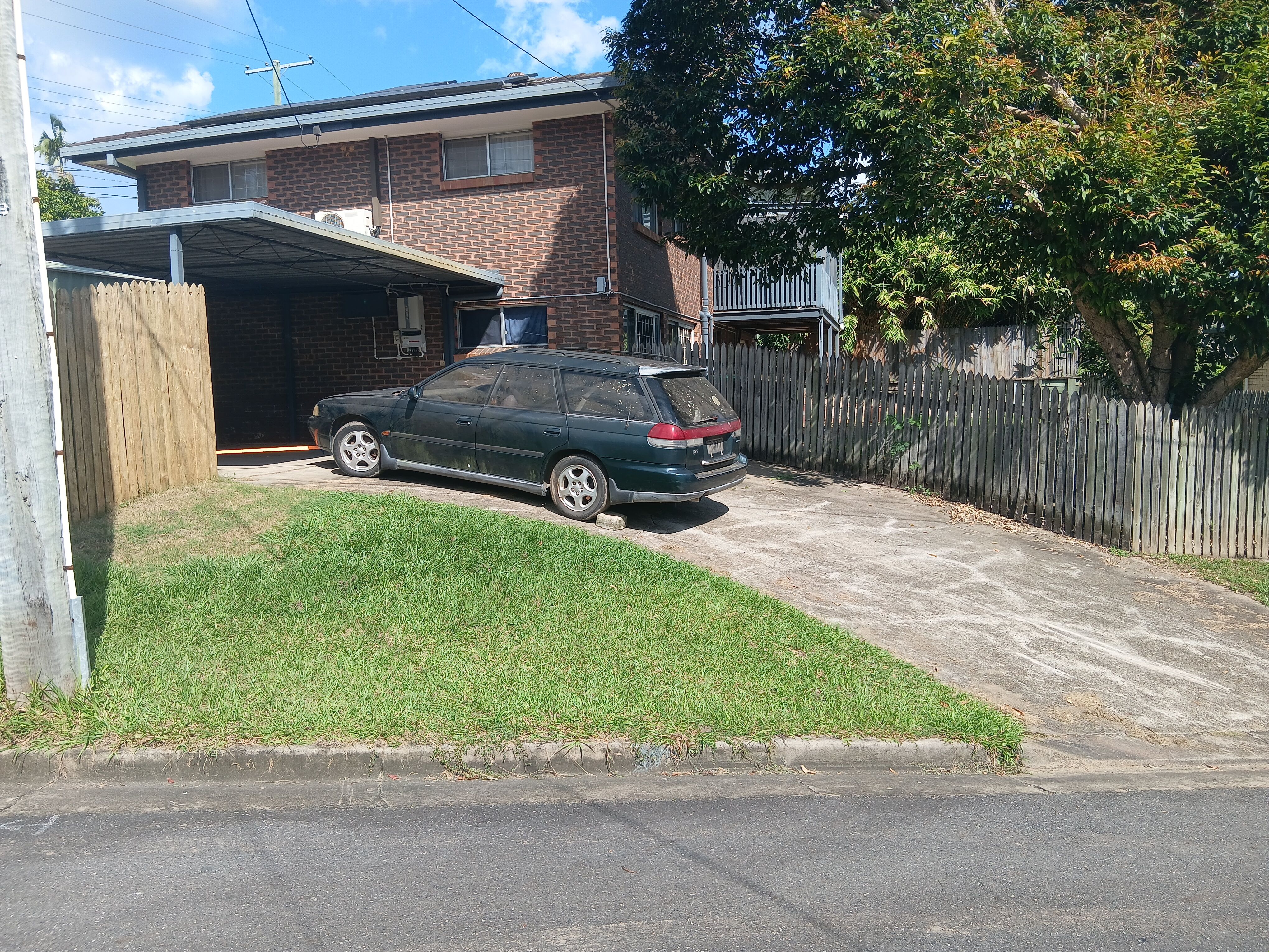

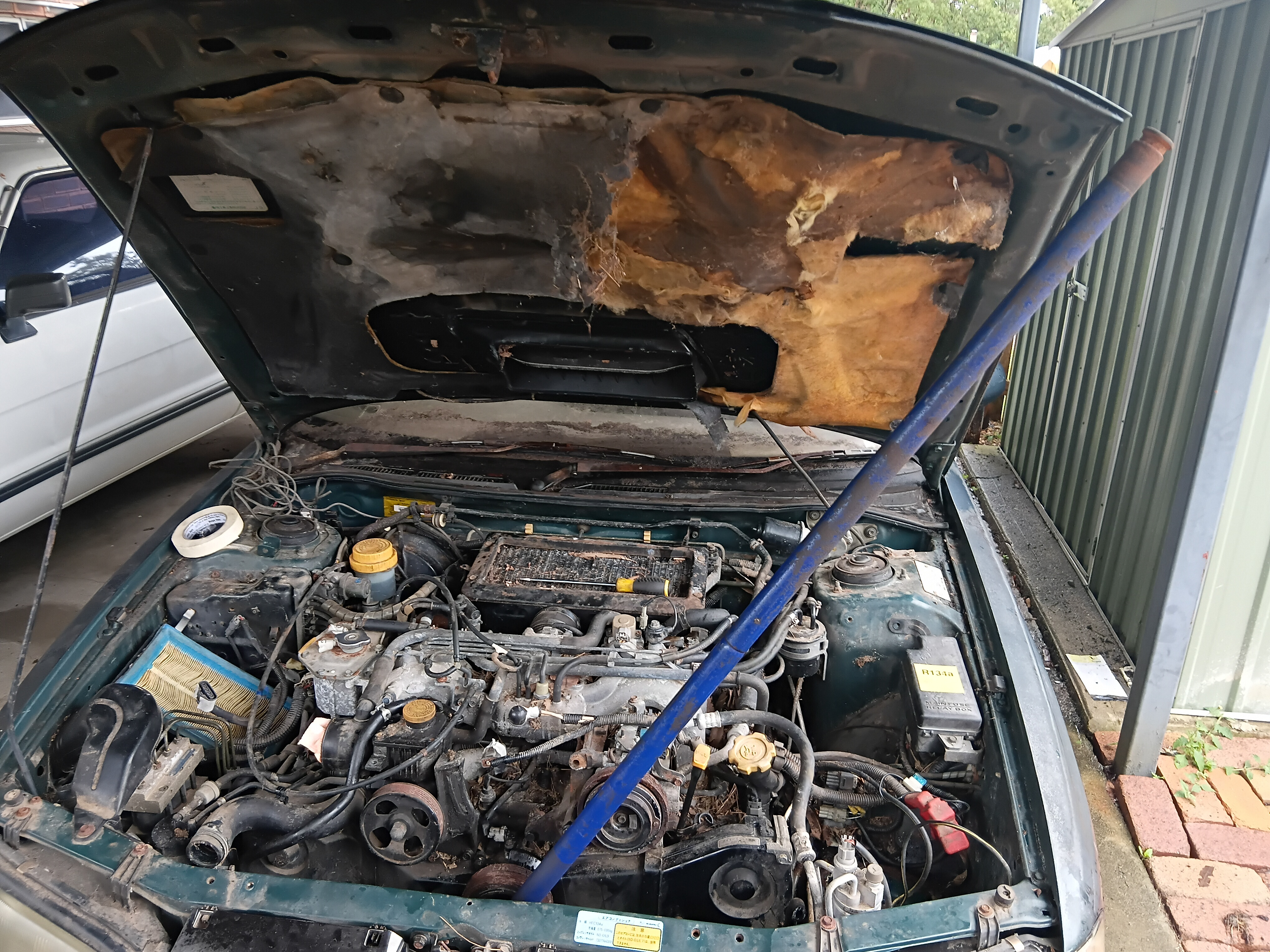

Below is after a quick clean, has come up quite well. Also infested with spiders, wasps, cockroaches and ants.

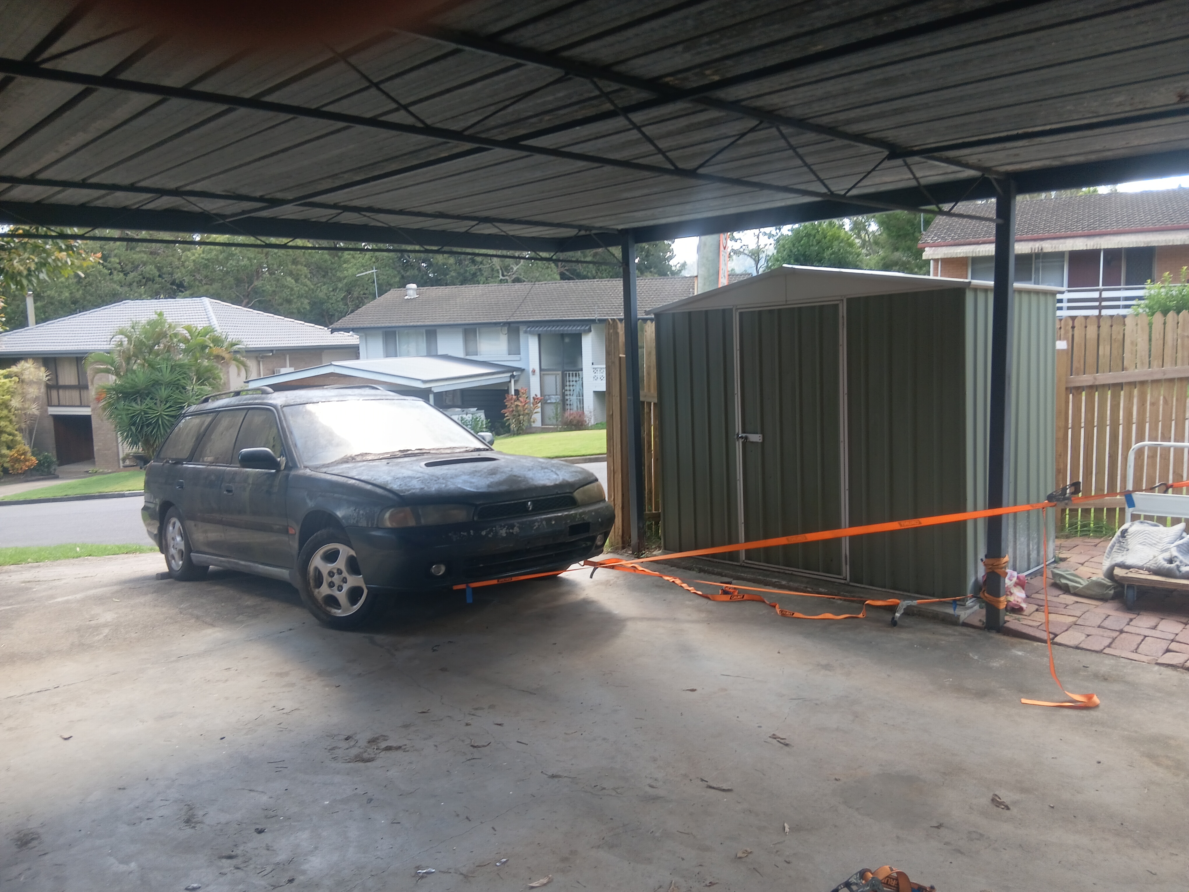

The mighty brumby dragged it most of the way up the driveway. After Dad was done dragging it up the driveway the clutch was pouring steam out the bonnet. And just a week after the 5 speed swap. It might be the worst driveway to get cars up
Very happy with my purchase, and it was $1000 less than the brumby. Can't drive it till August 2026 when I get on opens, but it will take a while anyway.

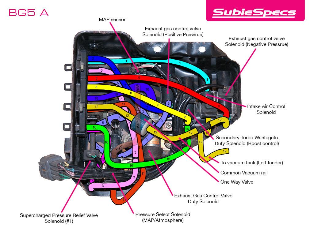

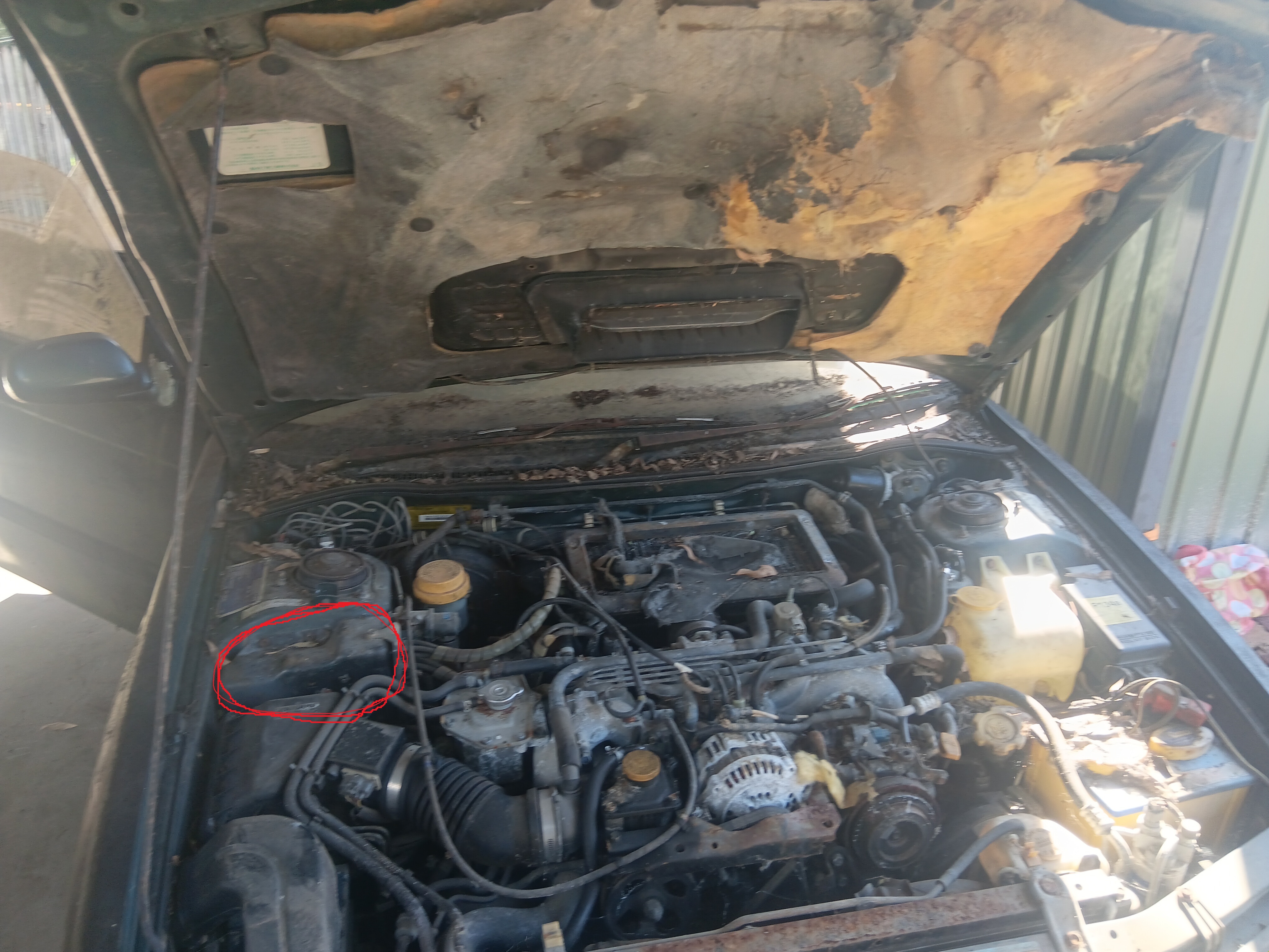

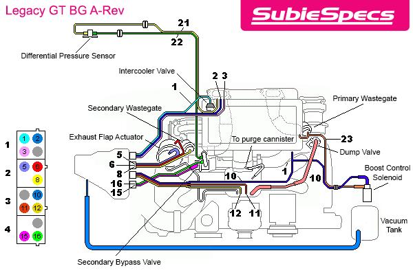

This thing
It has 15 or so vacuum lines running off of it and its a nightmare to diagnose or replace hoses for if removed. It controls the turbos and most issues come from tampering with it.

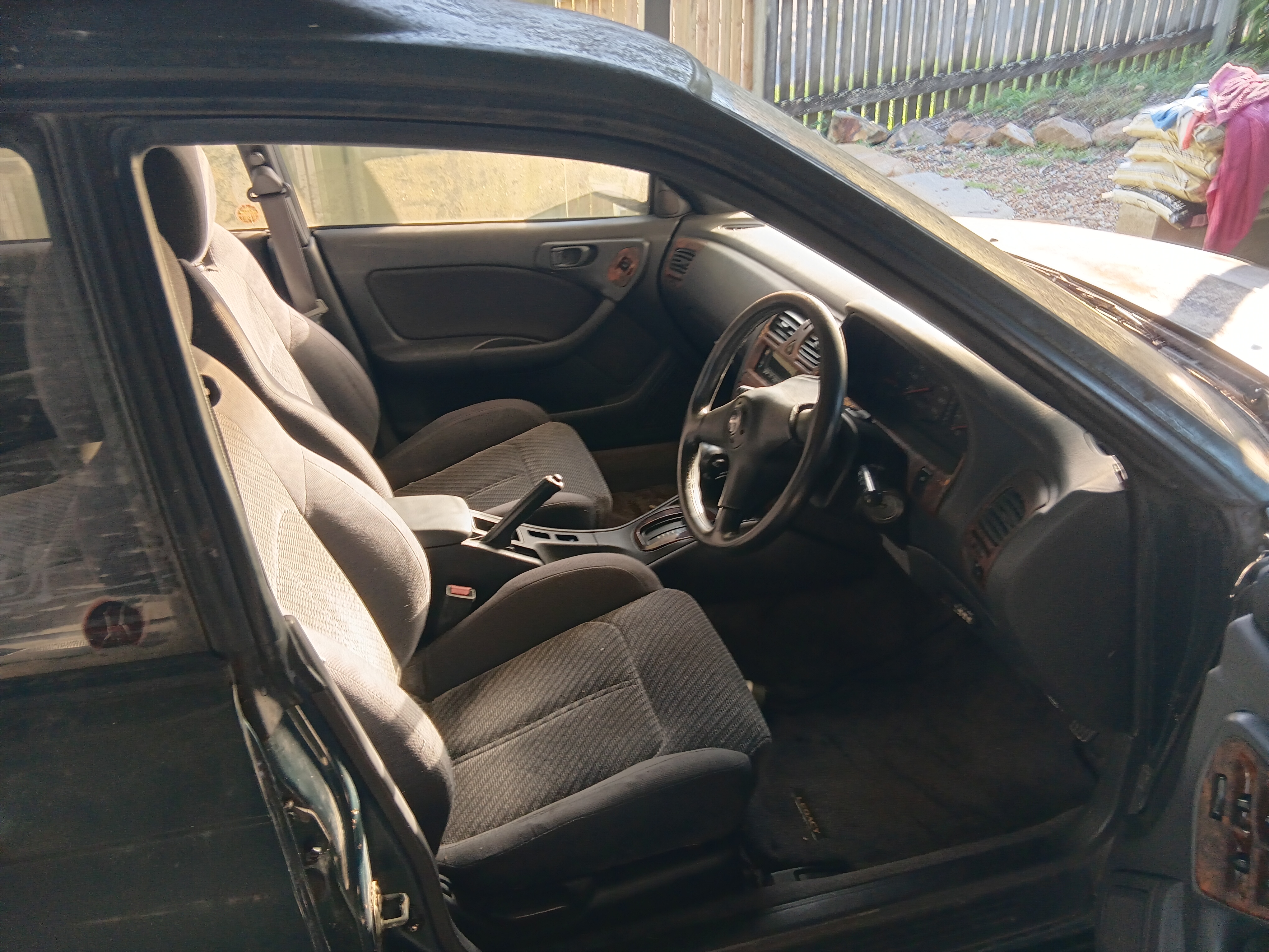

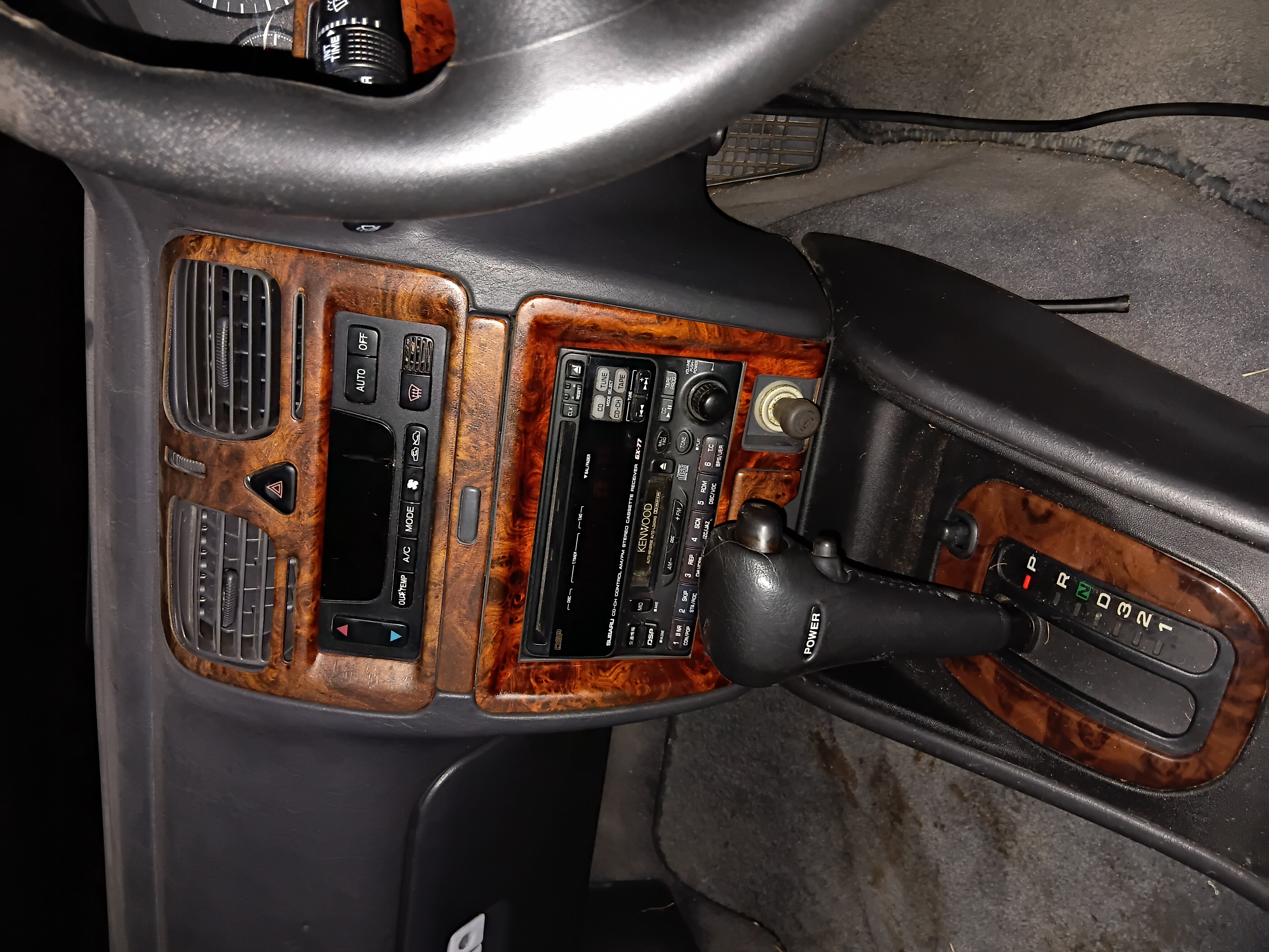

Have a look at centre console, they kept all the cool stuff for themselves. I almost want to keep the 4sp auto for the 'Power' mode.

Thanks, Subyclub has hundreds of twin turbo discussions, and many about the bg5a. Unfortunately many old websites are down but I'm sure the internet archive can bridge the gaps. Don't think I can get around the broken PDFs though. Will go hunting for Kong's posts.
The single turbo vs twin turbo argument sounds like ea vs ej to me. It's 30 year old tech, and of course it's outdated, but it's still cool and 260hp stock (or a little higher in this case) will be plenty of fun. That being said, being faster than my mates Nissan v35 would be nice too.
This thread was very helpful
https://sl-i.net/FORUM/showthread.php?2 ... n-turbo-eh
my black box has the bottom solenoid in use, which makes it pretty easy. Here are my vacuum diagrams
Now that the TT system isn't witchcraft (mostly), its time to prep for pulling the engine and trans, hopefully both out through the top.

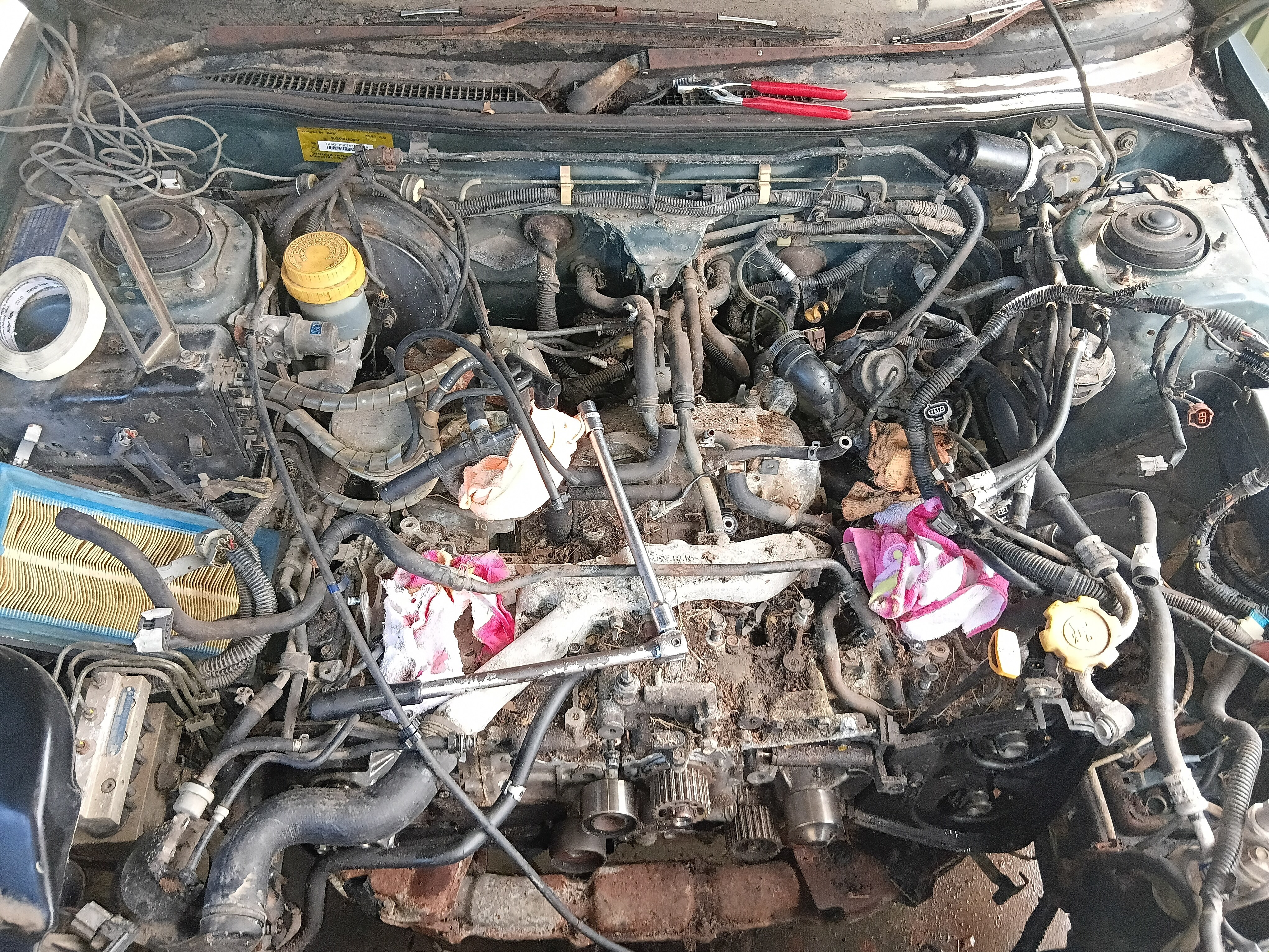

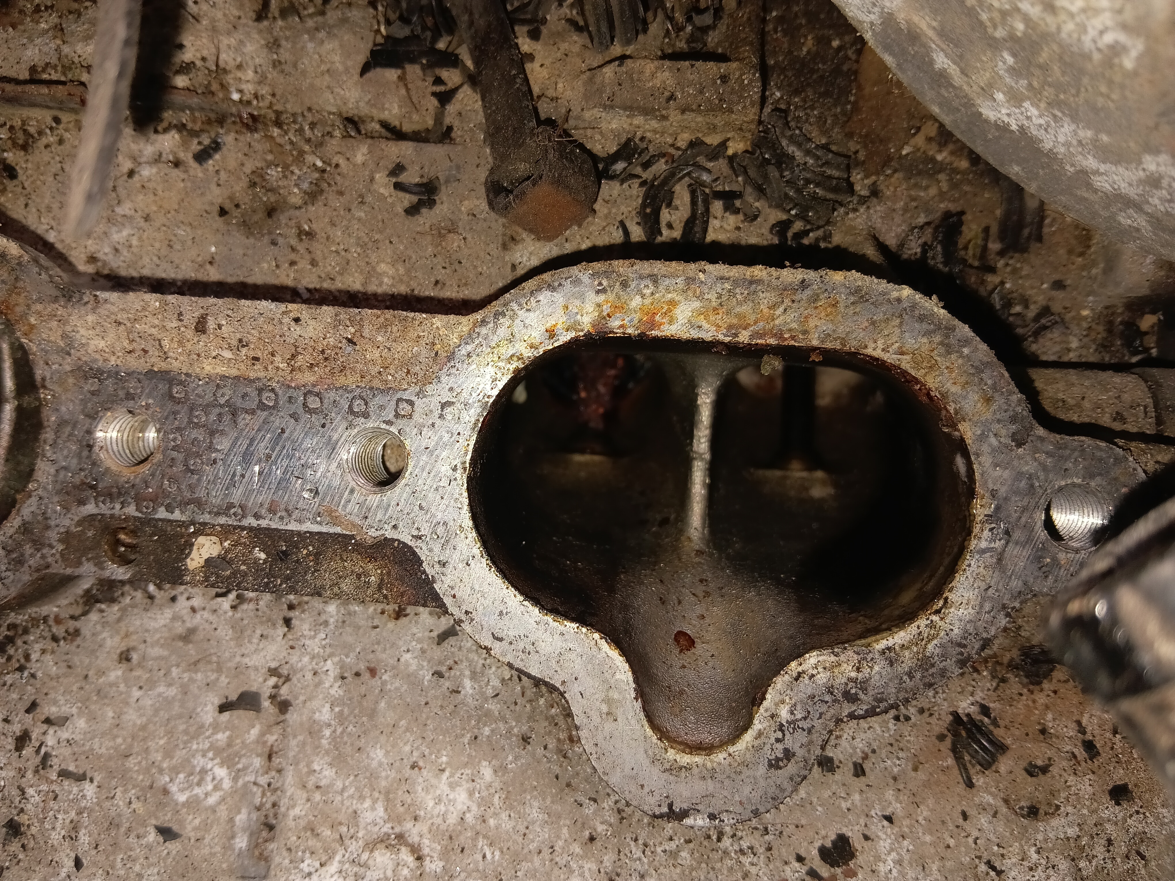

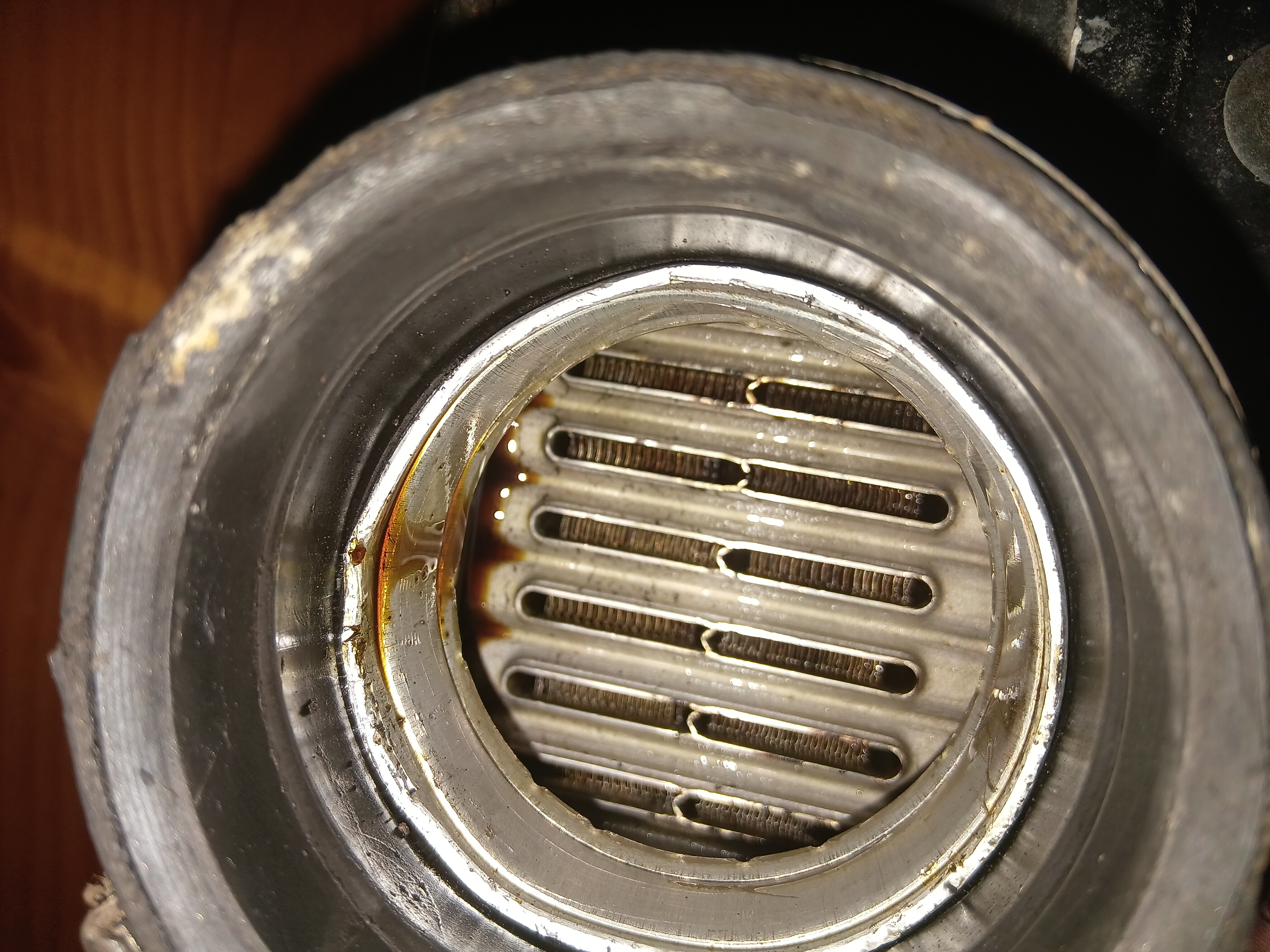

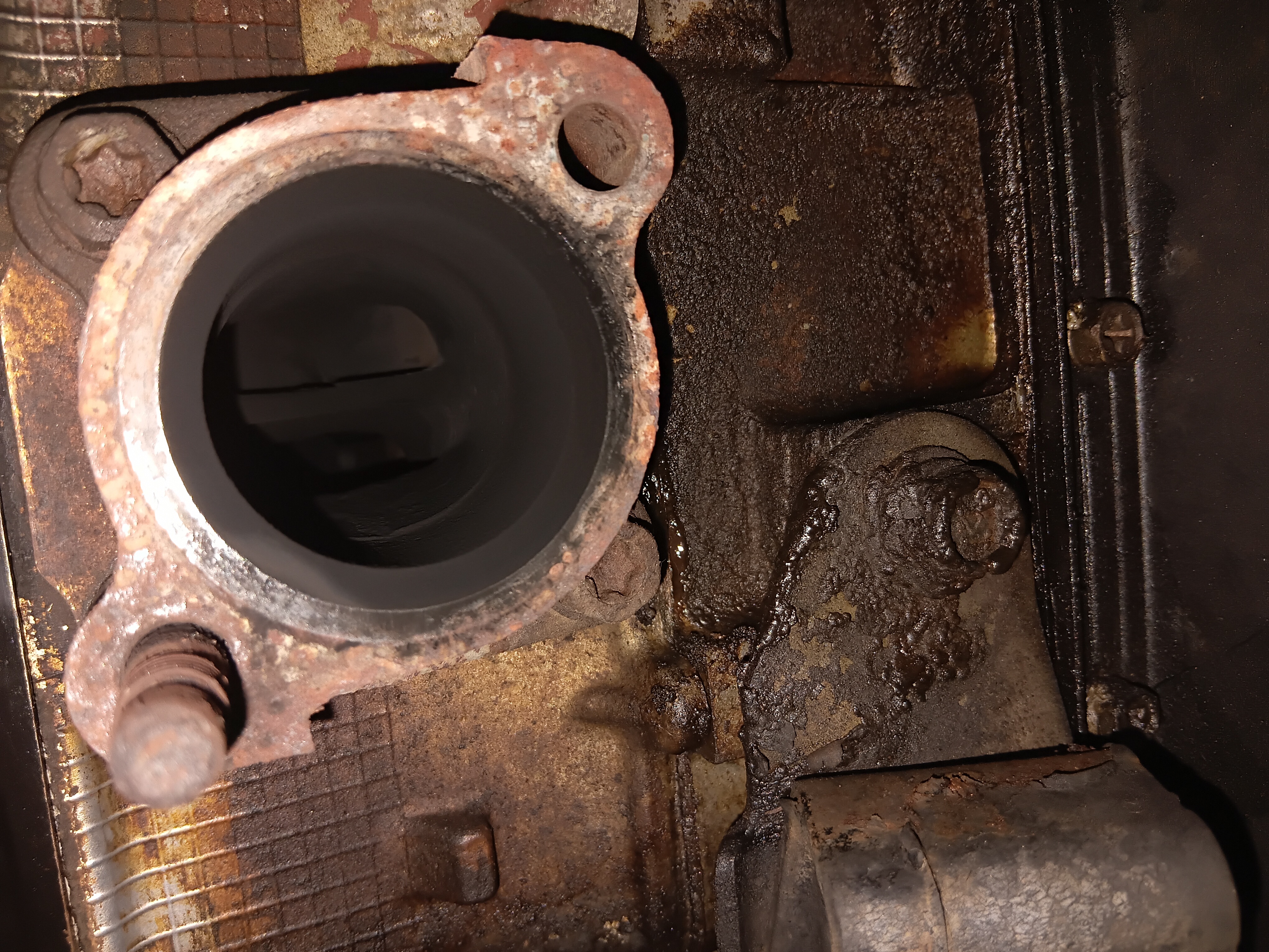

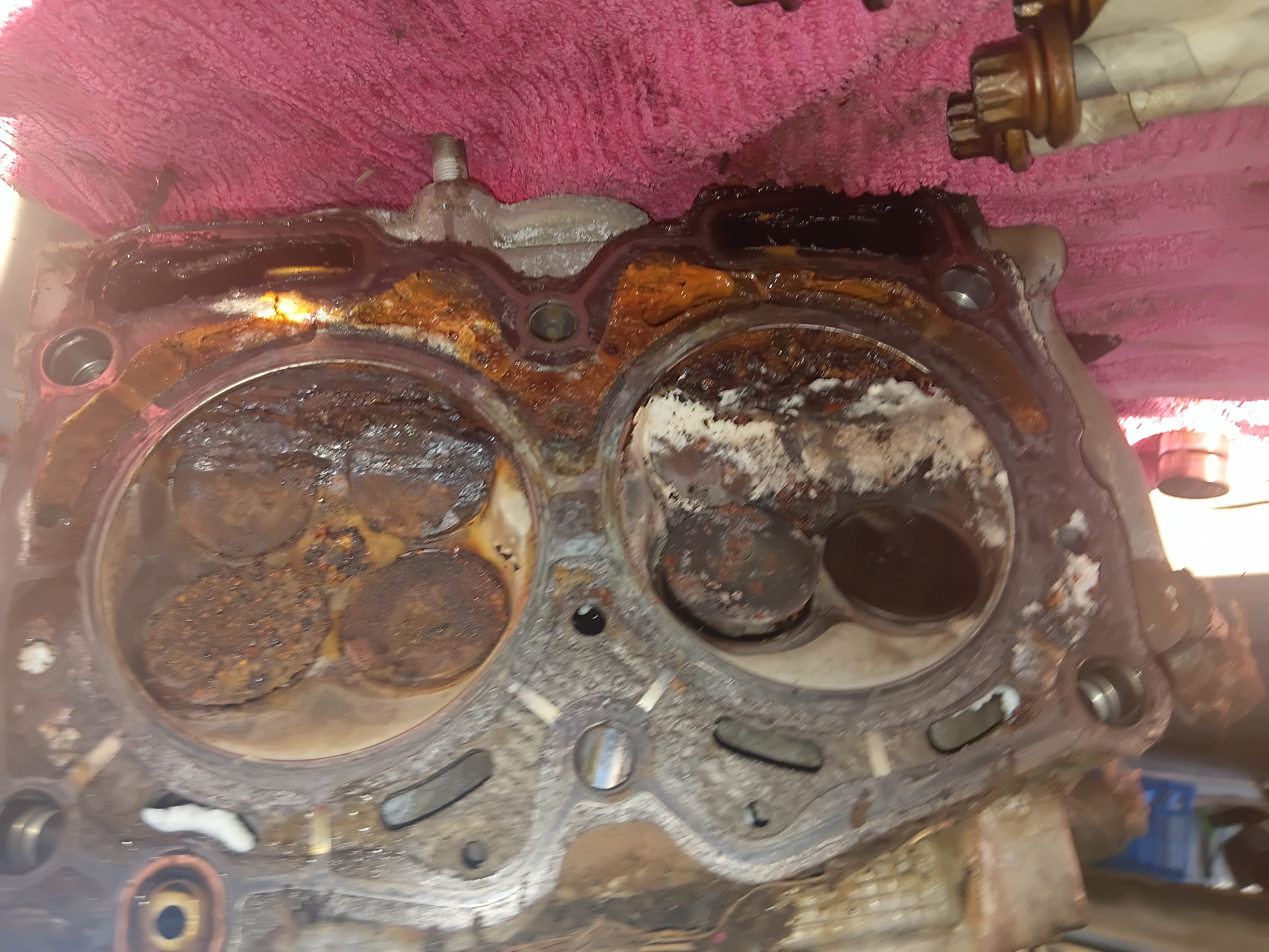

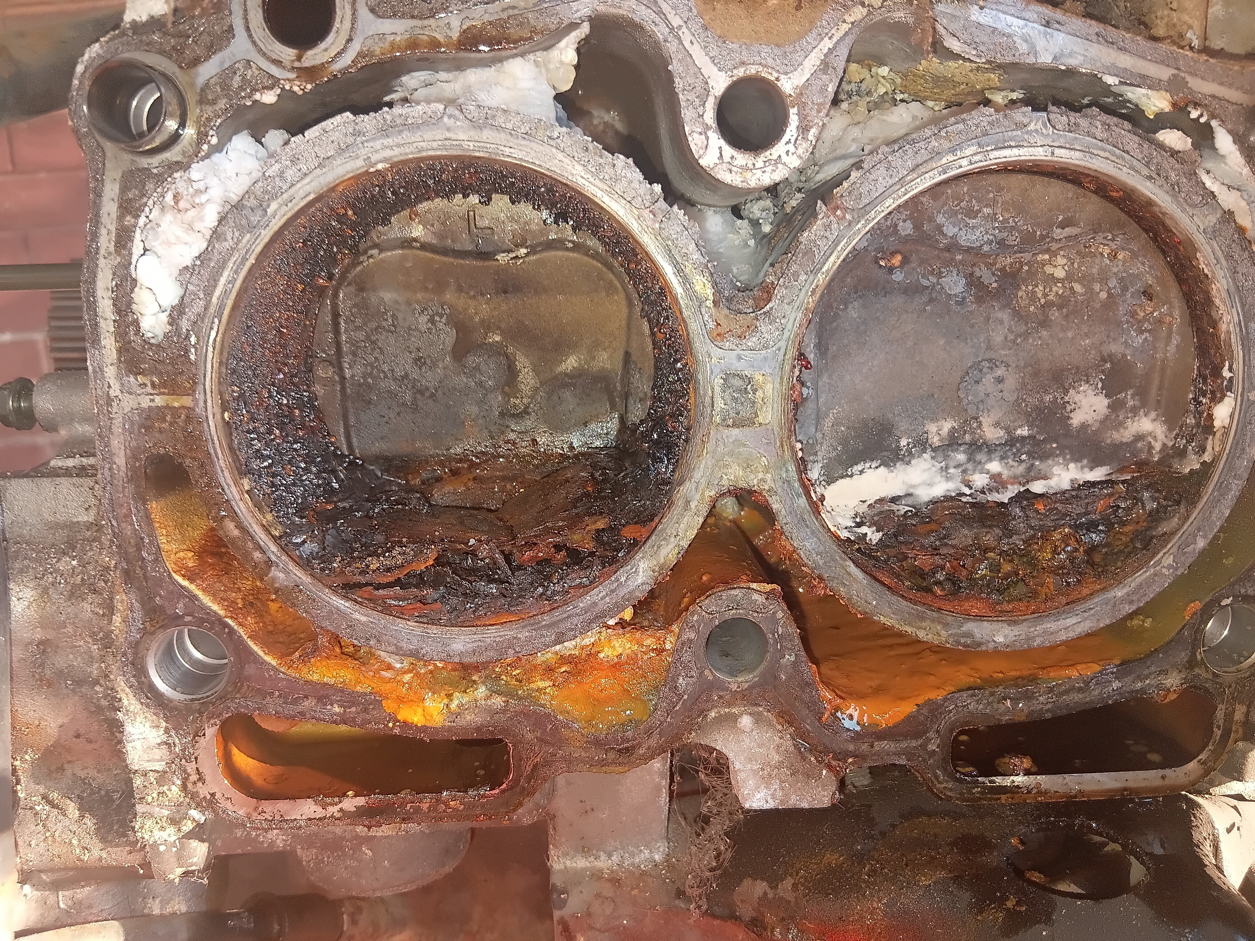

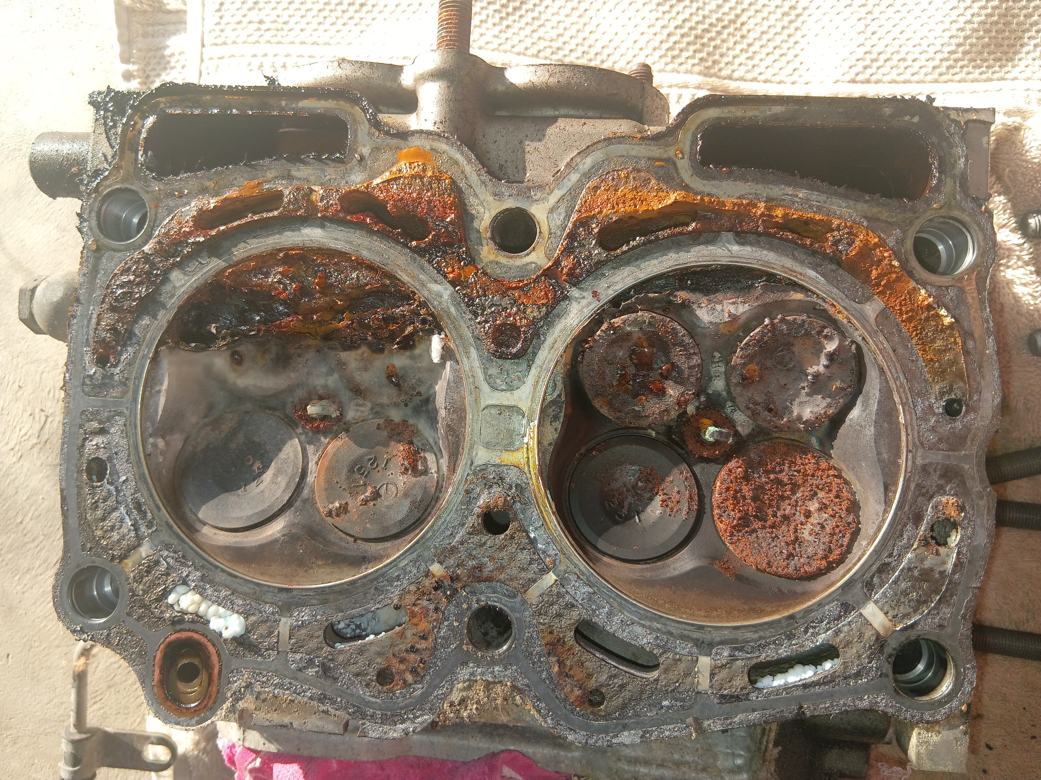

Decided to quit while I was ahead today, managed to strip everything down to the heads and it's not looking good.
New plan - strip everything and pull the block by itself. The auto is way to big to get out, and the torque converter has to come with the engine unless I can get it to turn over. The following setup couldn't do it.

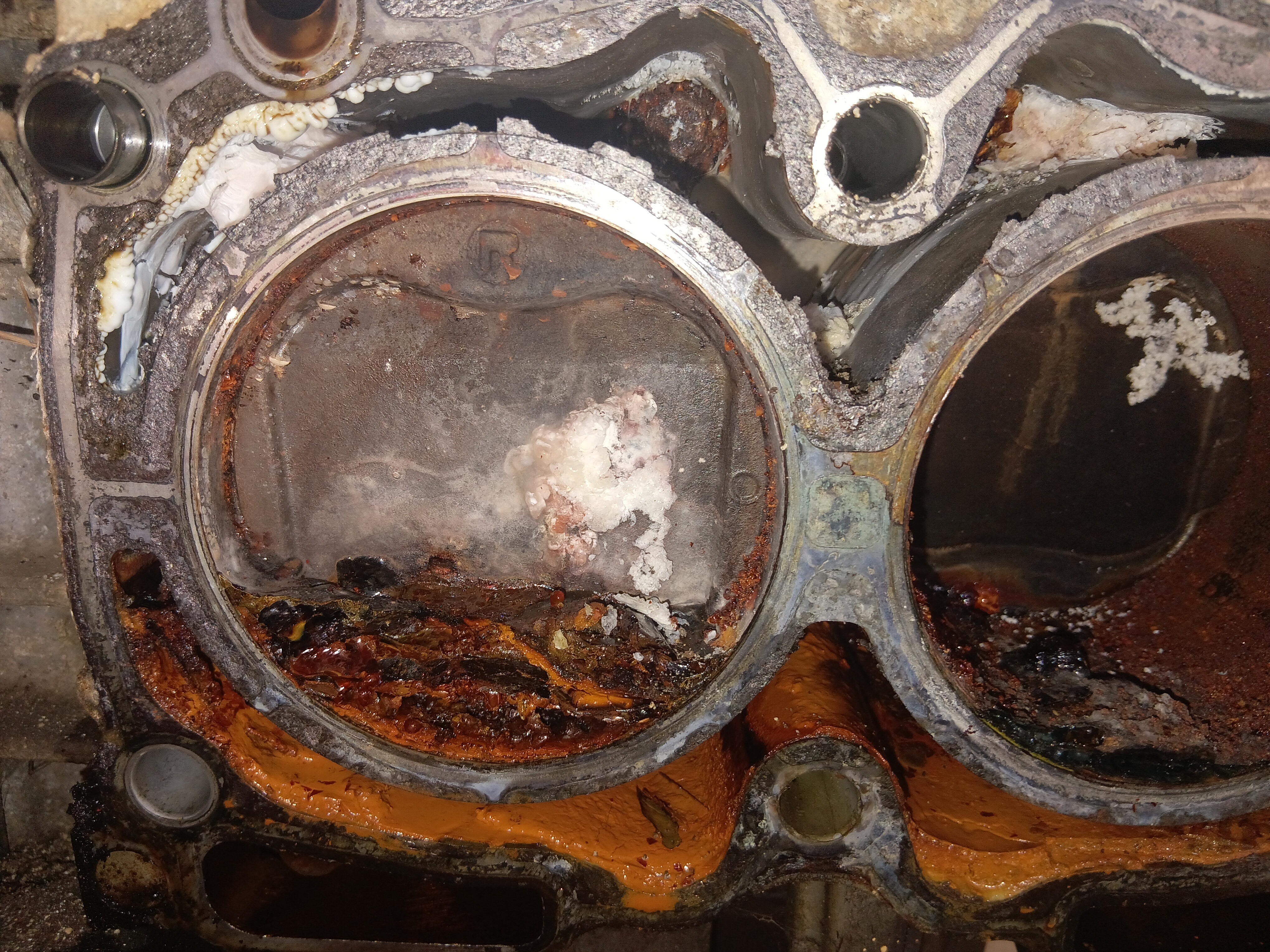

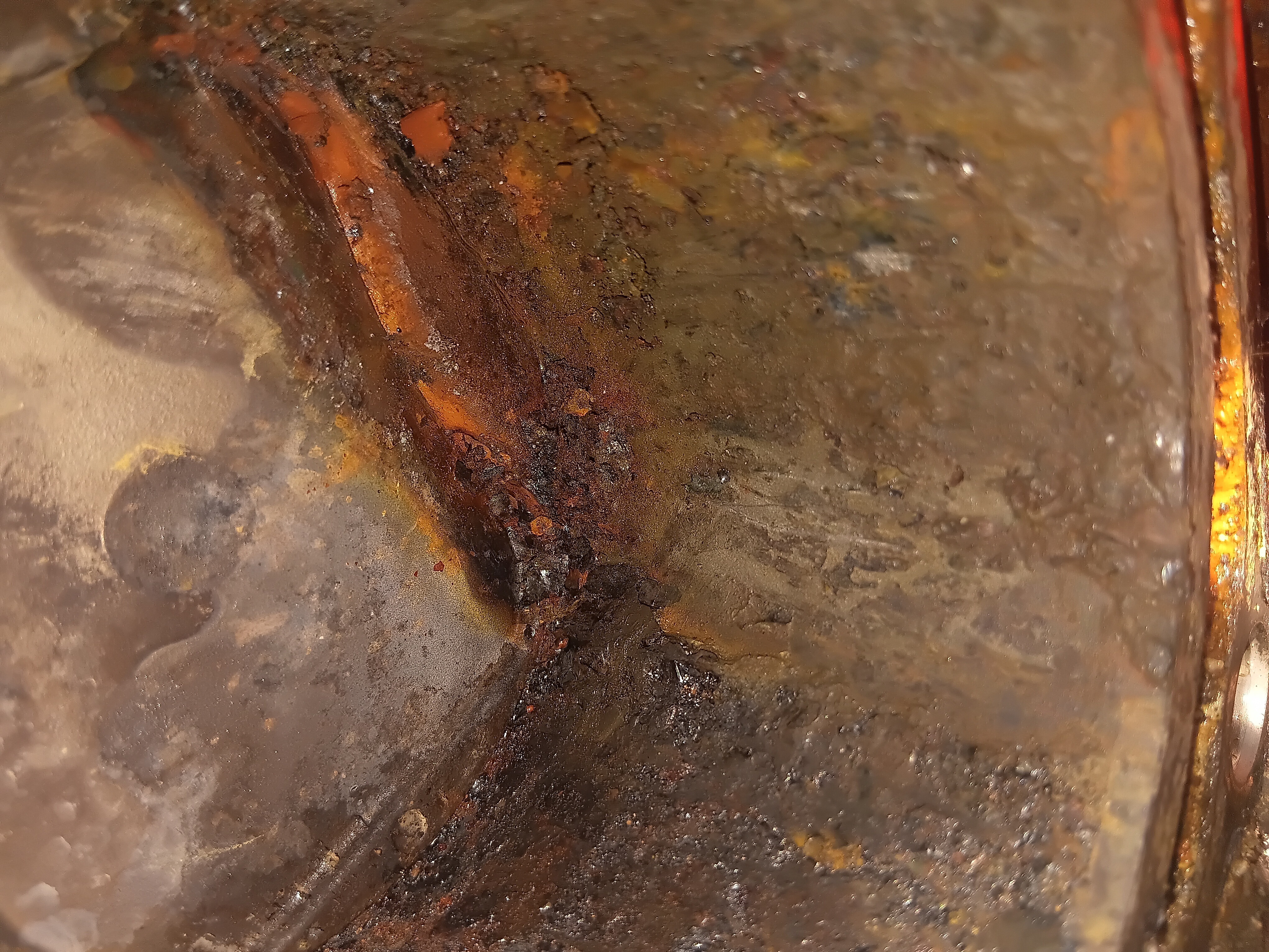

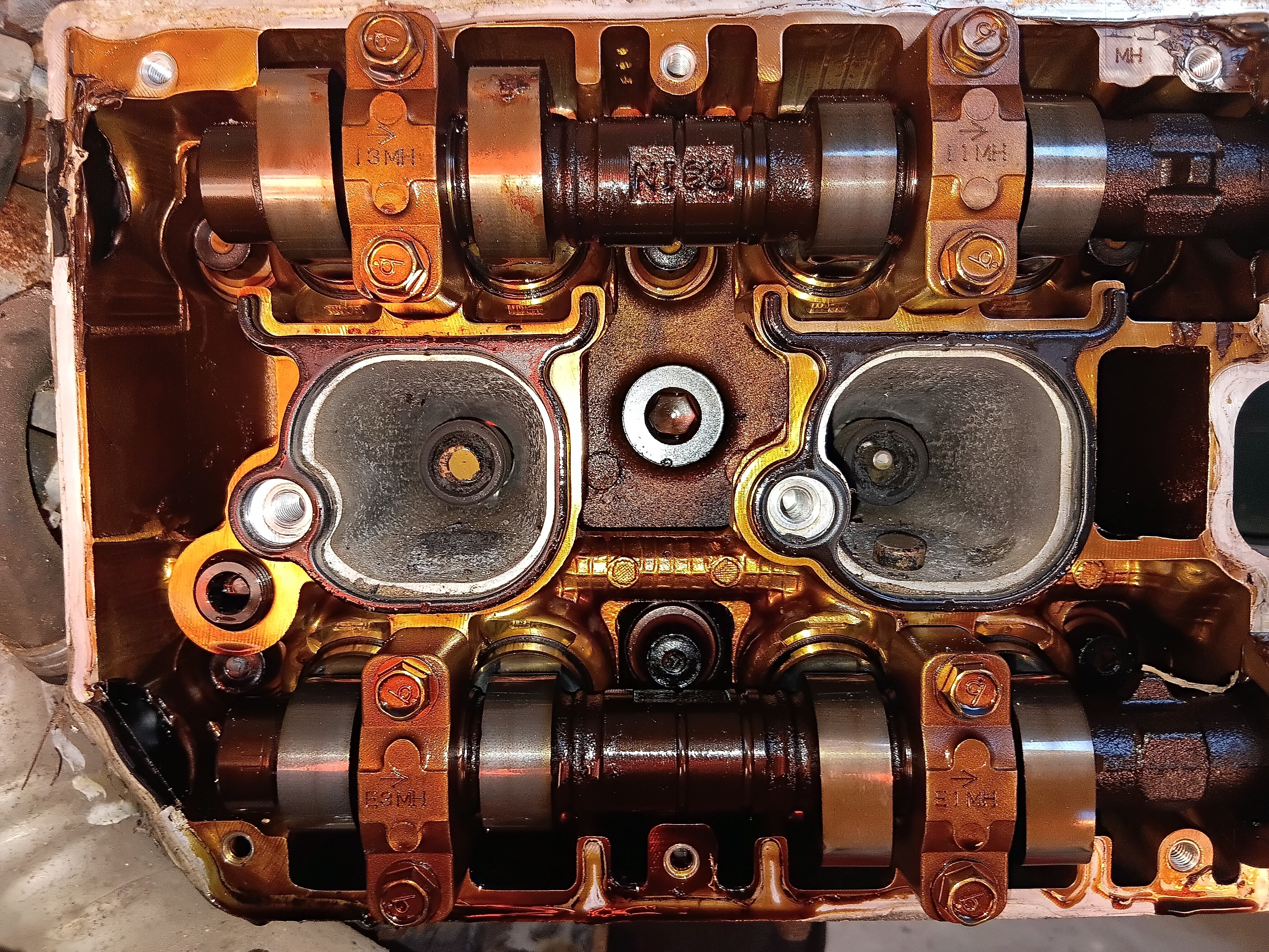

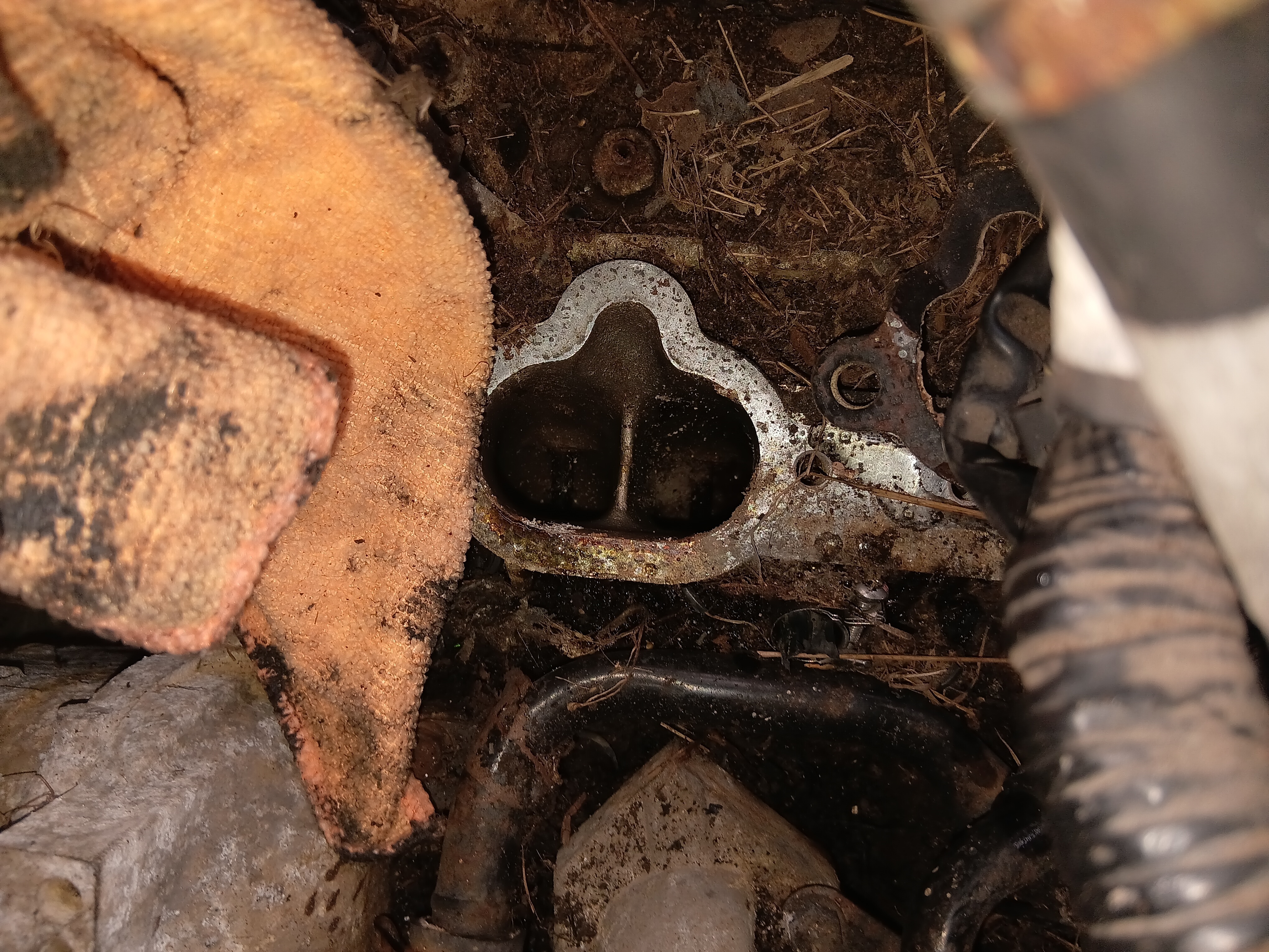

Here's the current state of the engine
Can't get the camera to focus but it's clear that a couple of valves are rusty
However, the turbos look good, one is perfect, the other has a small scraping noise, but neither have any shaft play. hopefully rebuildable. Car only has 160,000km, and these being different turbos they can't have many kms on them (Or maybe they can). Intercooler is a little oily, don't have the experience to say whether it is much cause for concern.
Seeing as the block has to be stripped, and may be unsalvageable, was looking into other options, forged pistons, ej207 semi-closed decks seem hideously expensive, maybe resleeving is the way to go. There's much disagreement, but it seems the WRX STI was the only car to get forged pistons and only in certain years. Better head bolts/studs and good headgaskets look much better suited for 280 horsepower this thing makes.
Also, I was incorrect about the later EJ20H being higher horsepower, I believe it to be the EJ20R that these turbos are off, or maybe the 20x/y (which was Aus delivered in the later GT) but that's going off the previous owners words, haven't had a good look yet.
Found two blocked off hoses from the BBOD, have read this is common as the original turbos have an extra wastegate/boost control device (Will confirm tomorrow).
Fumigated the engine bay after a spider was sitting on the other side of the battery tray, scared the life out of me at 7am halfway through sipping coffee.
Subinats 2026 is in October, and I can't drive a modplated car in August 2026. I've got a deadline.
More to come, if all goes well the block will be out and split over the weekend.

That looks like a project and a half in the making! :o and ye gods man was that thing driven through a hay field at some point? :lol: A lot of grassy junk on that engine. Do you care about JDM purity? keeping it original? If you're going as far as to rebuild the engine and sleeve the cylinders then you might as well update it to modern tech while you're there. If it were me I'd be doing everything in my power to bin that black box of death, it looks like trouble on steroids. Would have thought a single modern designed turbo and programmable ECU would perform better than two 30 year old tech ones but I don't have experience in turbos. All depends on the budget I suppose! ;)
In any case I admire your determination to get this beastie back on the road, it will be epic when finished 8-) If only you could pick the brains of turbo yoda, he's played with old turbo charged Subarus a great deal.

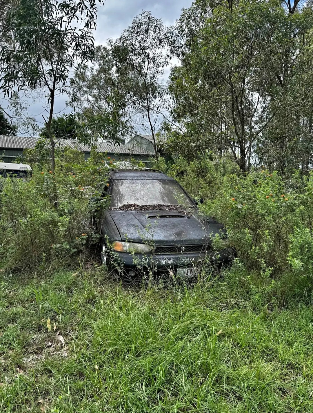

Funny you should say that Silverbullet, it's been sitting like this for about 7 years
I'm not mad on JDM cars, but I was early to a good deal that wasn't torn to bits or ruined by rust (Imported to NZ in approx 2000). I like to keep cars mostly original, or at least original looking. The Sony radio in the brumby drives me up the wall, not only that it looks terrible but it was terribly installed too. I like rally cars, unfortunately, all the Lancias, Alfa Romeo GTs, Triumphs, Audi Quattros, and anything remotely close to homologation spec are far, far outside my price range.

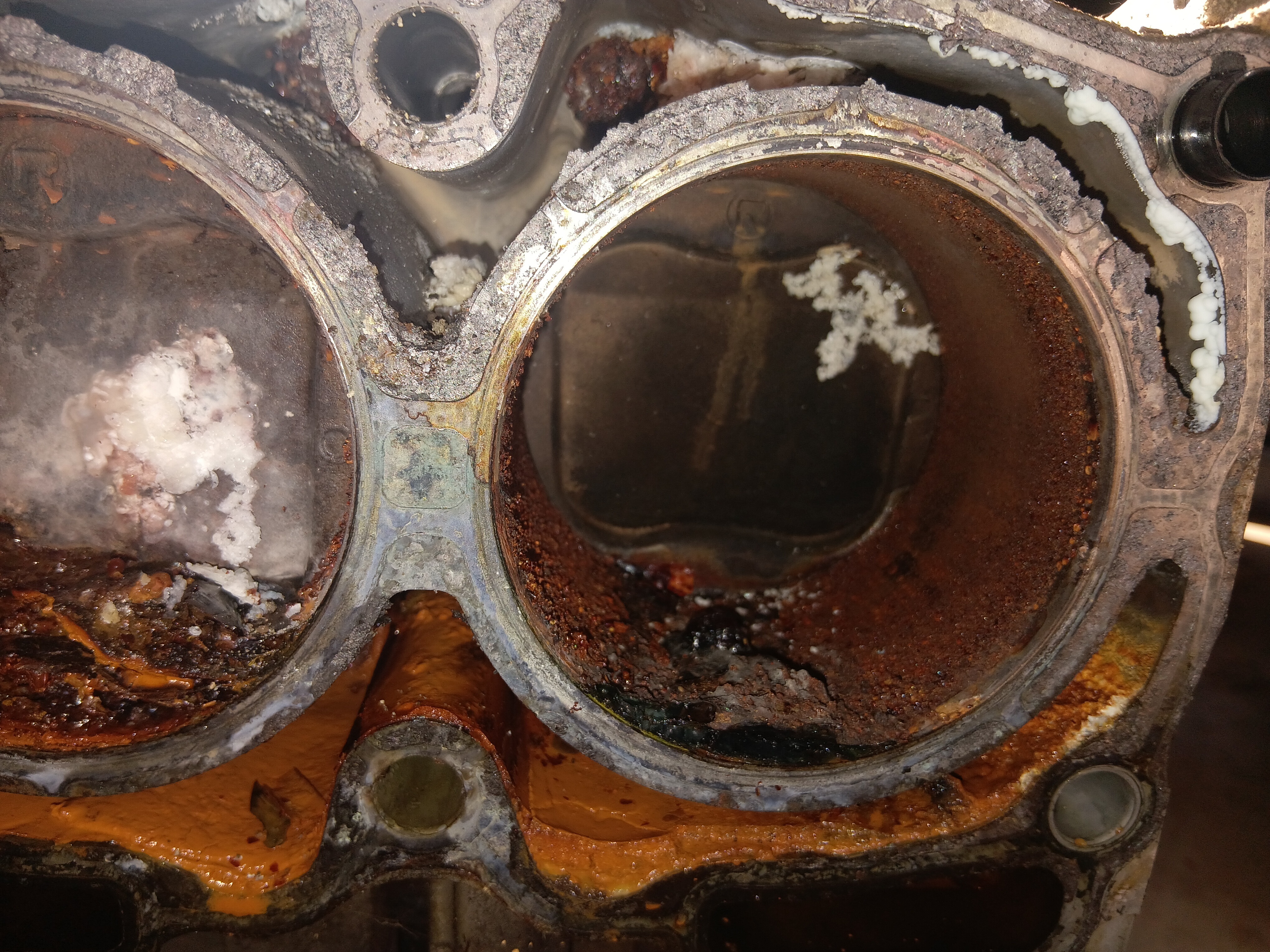

I'd like to save the engine block because it will be a nightmare trying to explain to main roads that it's the heads, manifold and pistons that make the power, not the engine block.

Any EJ turbo block will slip in between those heads ;-) I don’t know how difficult it is to get things rego’d with an engine number change in NSW where I assume you’re located (haven’t checked). Shouldn’t be an issue if you can show proof of purchase for the engine. But if you’re a purist and the engine number match the vehicle from the factory then it’ll be worth doing up the engine (I don’t know how to do this other than looking at the owners manual where they fill out the vehicle’s details).
That’ll be a few dollar-bucks right there for the rebuild. Re-sleeving would be the go, you’d be able to reuse the old pistons if they’re still good. Don’t get hung up on the cast and forged stuff. If you’re staying OEM power keep it simple like it already is. And the 8.5:1 comp ratio is about right, not high by any means for a booster application, especially these days! The dish on the top of the piston is what drops the compression. AFAIK the combustion chamber in the heads are the same as the SOHC heads.

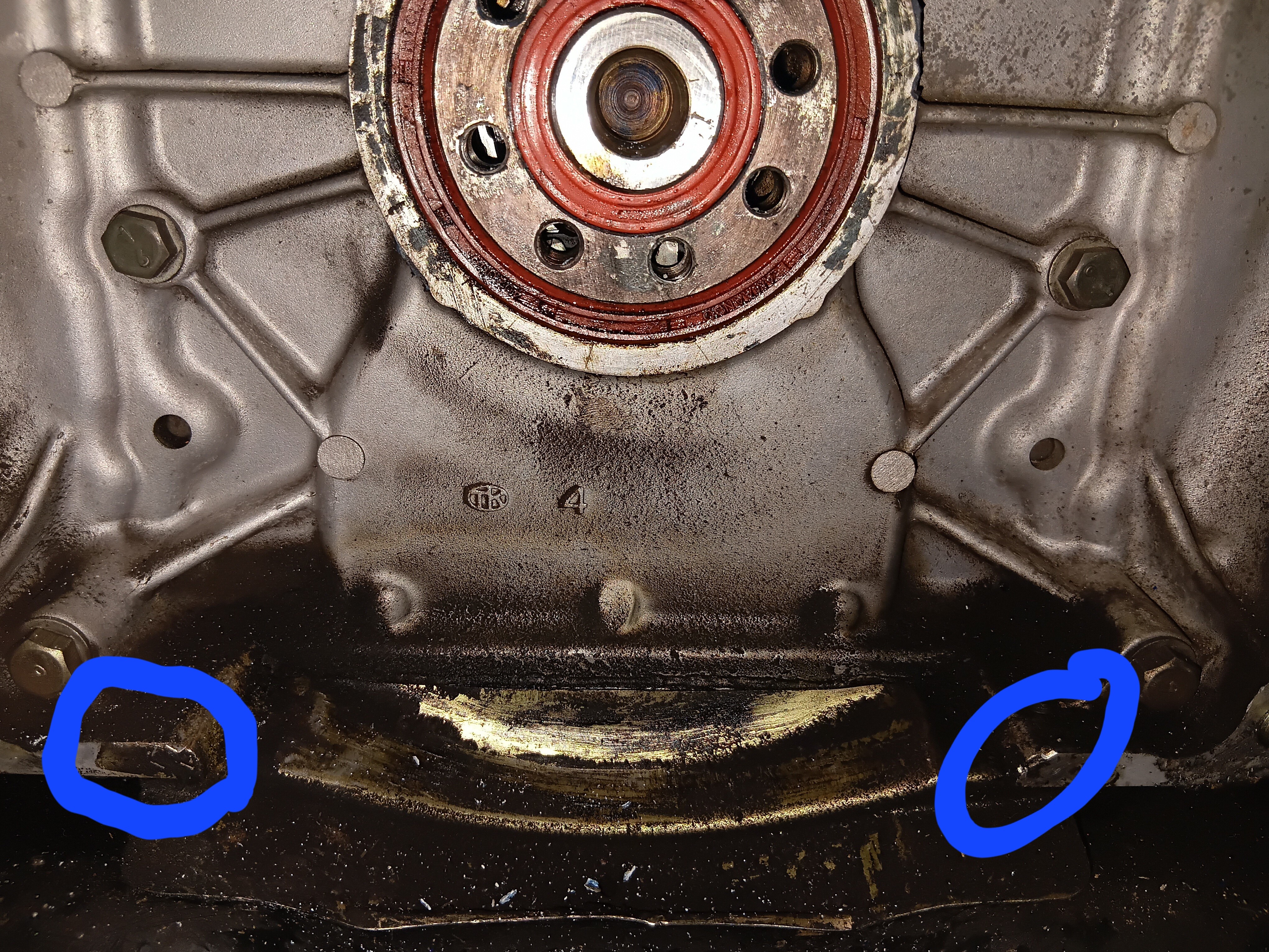

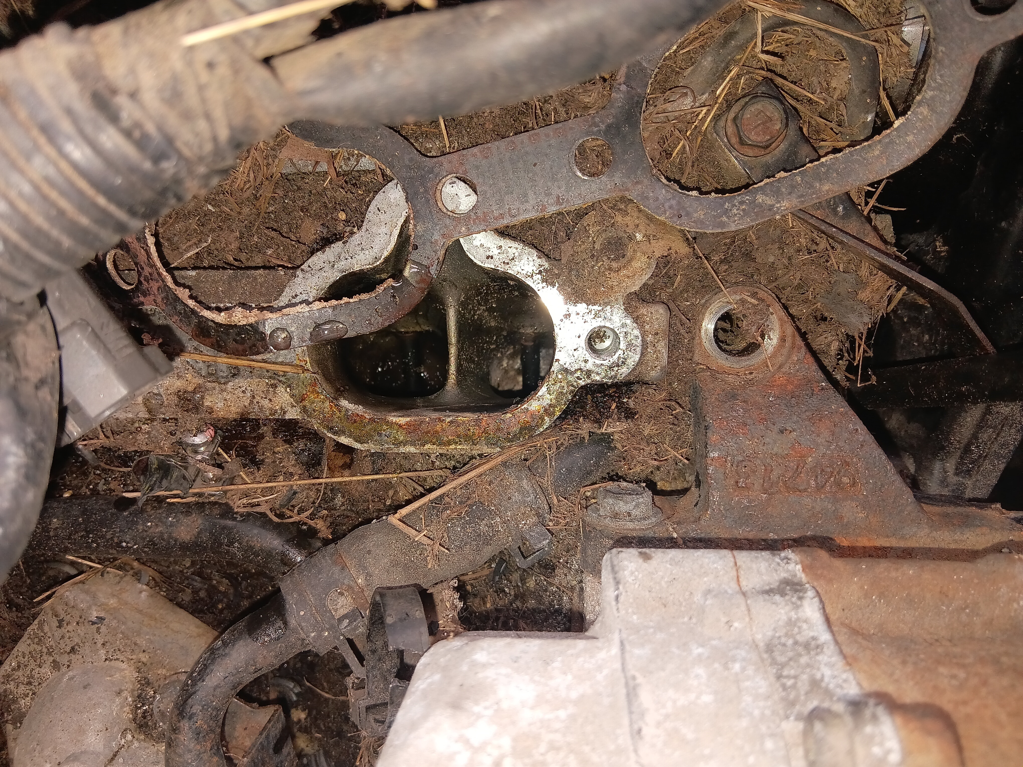

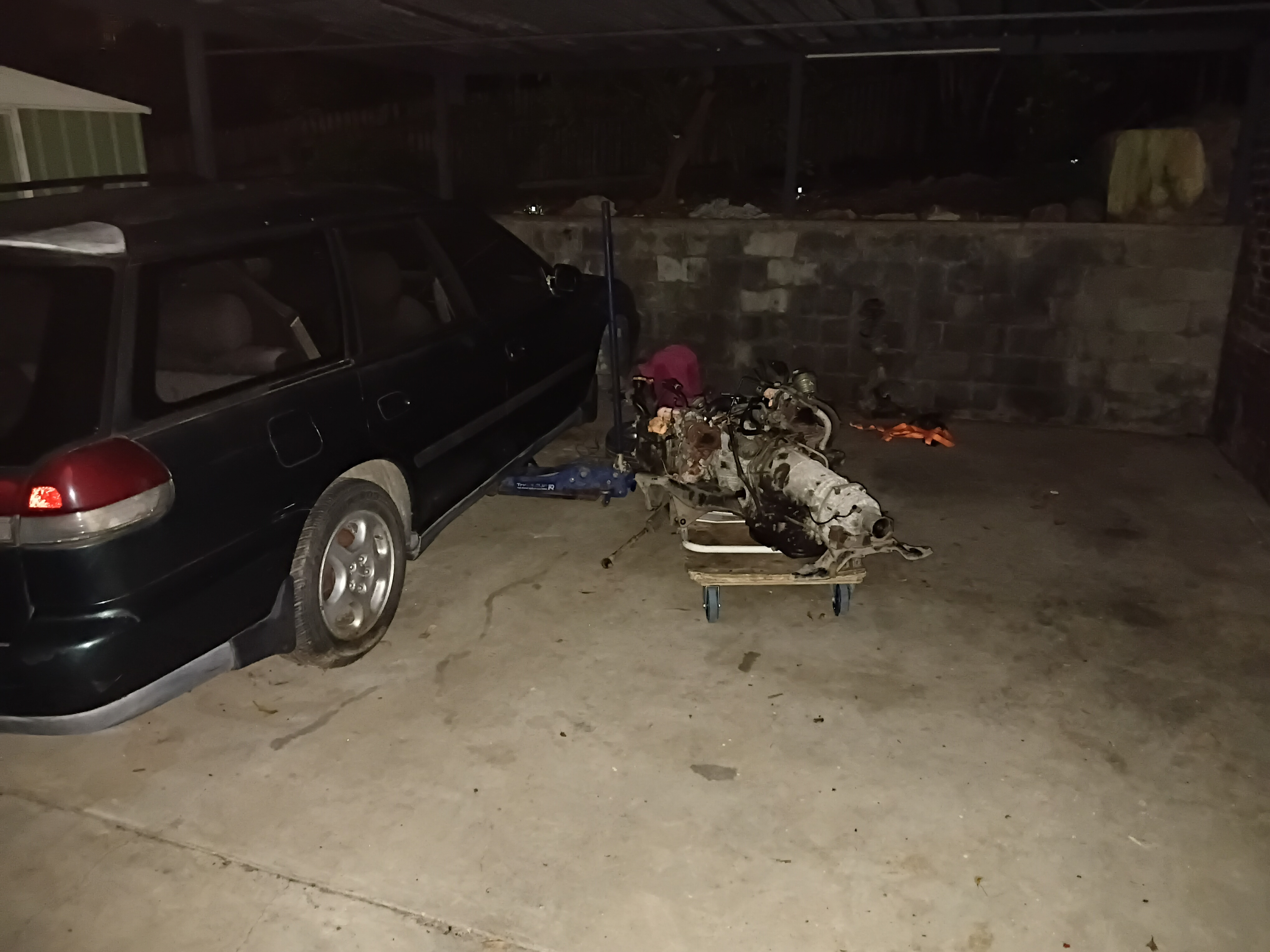

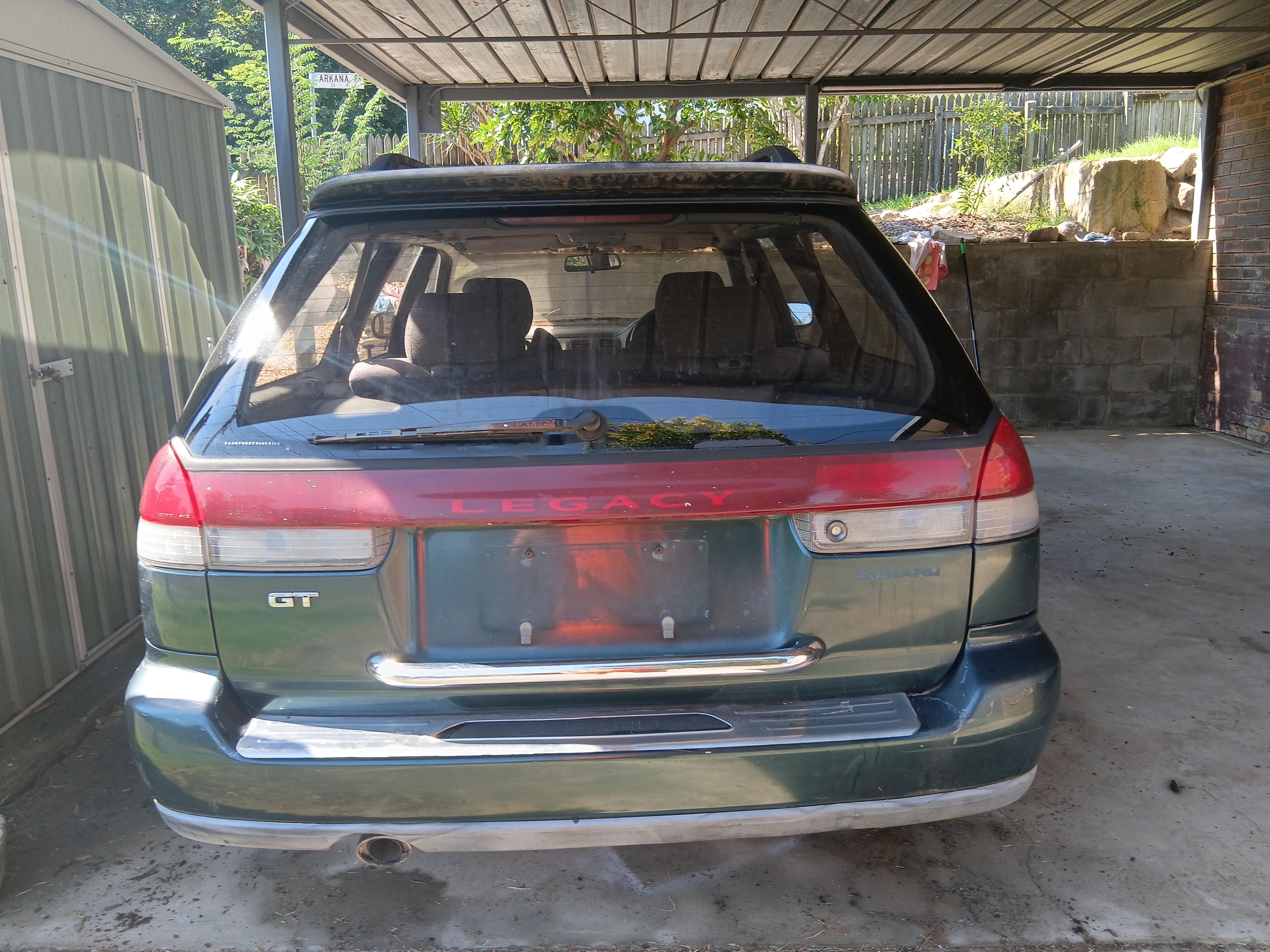

Lots of messing around with rusty downpipes, but it's out. Of course, nothing went to plan, but by now that's 'all part of the plan'. But it was foiled at the final stage - it doesn't fit through the back gate. will fit without the trans though.

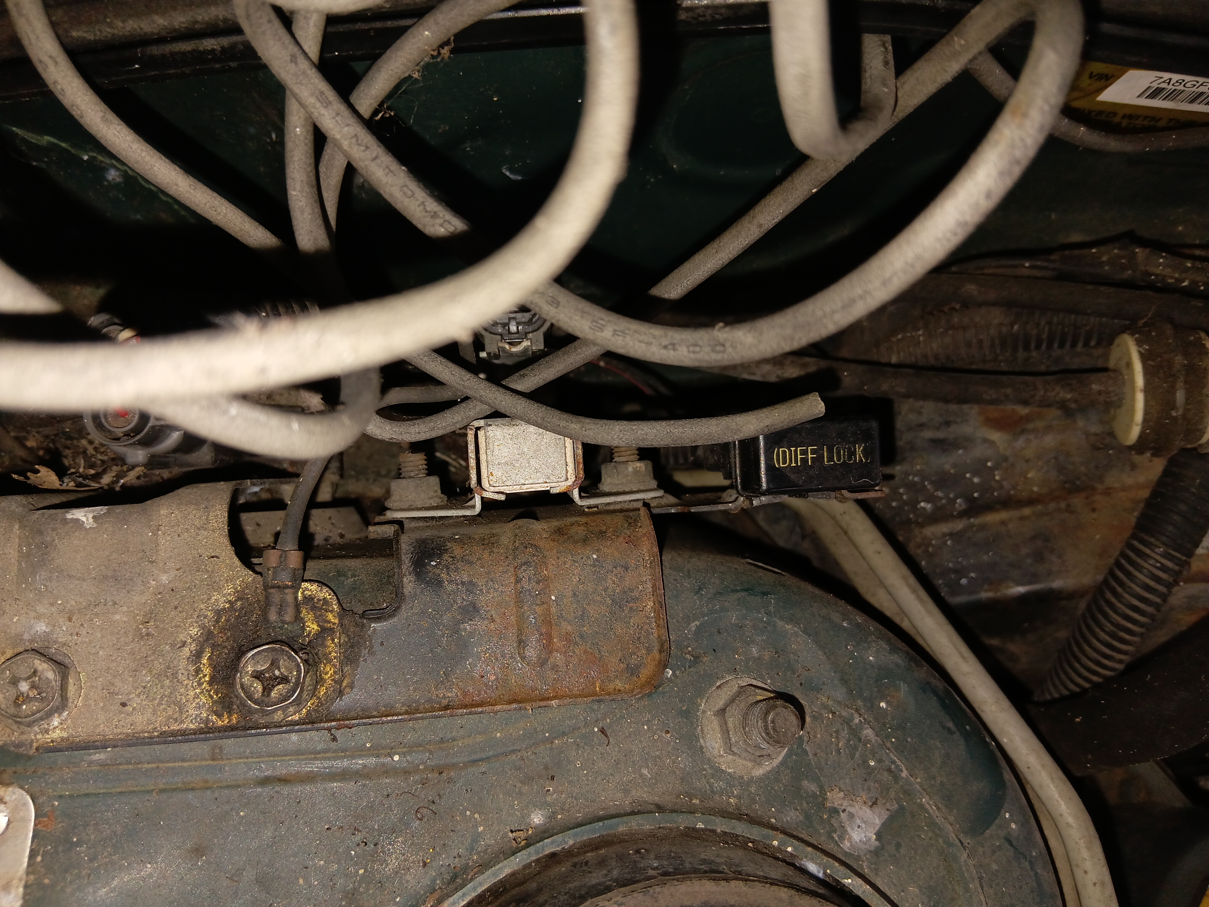

Found this earlier, probably just 50/50 split but still interesting.
Ran the Vin through LegacyPic.Uk, and it came up as a GT-B and all info was correct but an asterisk stated that it doesn't always apply to JDM cars.
There's a lot of misinformation, but here's the for and against.
For:
Manual adjustment drivers seat (All regular GT had Power adjustment, GT-B didn't)
Nippon ABS (optional for GT, standard for GT-B)
Cassette + CD radio system (optional for GT, standard for GT-B)
Possibly lowered suspension, didn't clear the car trailer (GT-B had 'Subaru Sports Suspension')
No airbags (GT had drivers and optional passengers, GT-B had none. Because the sportier model needs less safety)
FH option code (Believe to be GT-B only)
Against:
No BBS wheels (Stock on GT-B)
Wood trim (Supposedly not available for GT-B)
Seller probably would of said so
If it is a GT-B, it will have a torsen rear diff, will be interesting to see.

Whoa you move quick! And the trans came out too!

That diff lock thing you found will probably be for towing if it’s not got a fuse in it. This is to de-couple the rear end to tow it with the front off the ground. Needs a battery fitted to do the vehicle.
If there’s a fuse fitted it’ll probably be some sort of auto DCCD type arrangement, I’ve not heard of that one before though, it doesn’t mean it doesn’t exist though!

Took a head off before trying to break it loose. Glad I did, not sure I would ever get this to move.
Cleaned up a bit and the pistons might be salvageable, but it is probably cheaper to get a better block.
Have photos of the heads too, but they're downsized and don't want to work properly. Ill some them below but no guarantees.
Cams look good, hydraulic lifters look good, valves are rusted beyond use. Most of the crap should come off and the head should be all right.
Edit: removed question about semi-closed ej207 from an STI, checked codes and it was, in fact, not semi-closed. Not worth the $1000 asking price.
Plan is to find a decent phase 2 open deck block and hopefully keep the pistons.

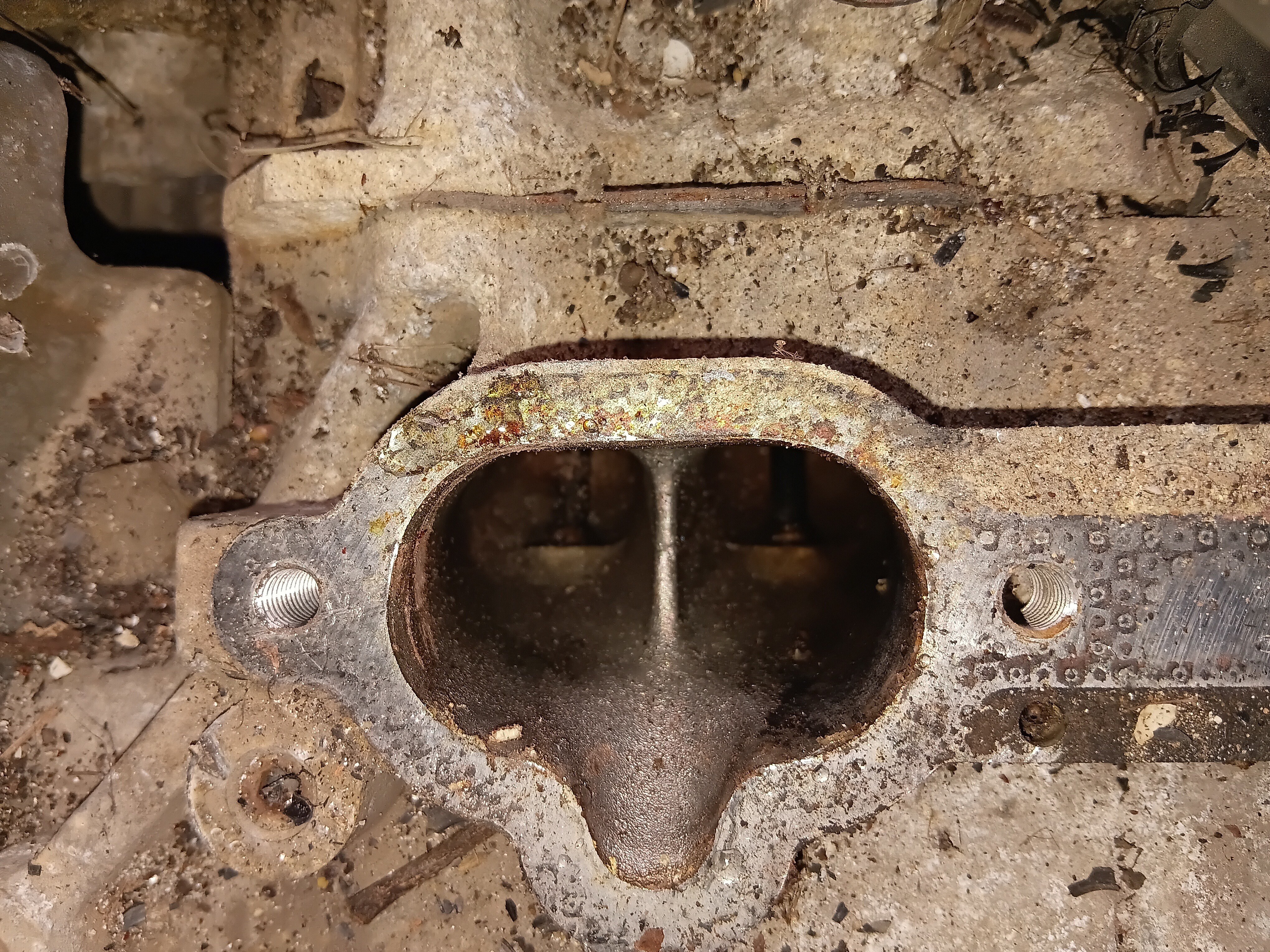

Took the other head off today.
Tried scratching the rust out of cylinder 2
The photos don't make it look good, but in person it looks like the walls are good and everything else is stuck to it. This block may have life in it yet.

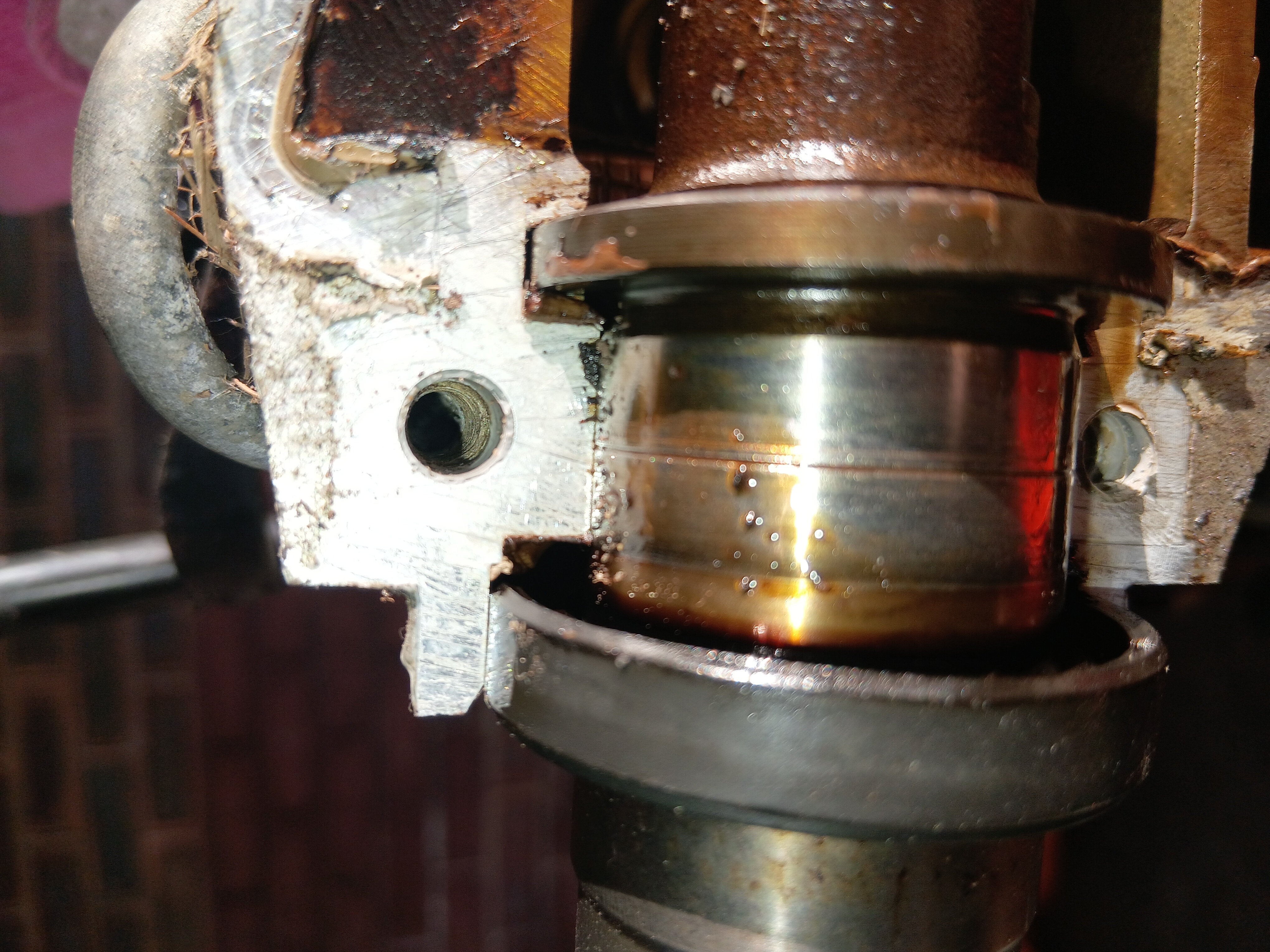

Intake camshaft looks like this. Not pretty.
Seeing as it's scrap otherwise, I'll have a crack at cleaning it up. Can't imagine that any 2nd hand block will have 160,000km.

That rust is nuts! What did they do, drop the car in a river? I hope not!
I’ve not seen that amount of water in so many cylinders for a blown head gasket. I think there’s more to it than just a head gasket.
160,000km or not, that block will need a lot of work to get it going again. I reckon you’ll find the bores are shot after cleaning up the rust.
And I need to turn my RS head off and think Gen2 GT - you’ve got the ARX style pistons so any turbo block will swap in. And that rust on the valves should clean up ok so long as the valve stem and seat areas are not overly affected. You’ll only know after cleaning them up. A second hand set of heads could be a cheaper option at this point. Worth looking into anyway.
You might be seeing more on that camshaft than I am here. It looks like a groove to me. I wouldn’t worry about that, so long as it’s not grabbing or causing an oil leak I’d run long term.
Do those spark plugs have half of the coil pack’s snout on them still? Hopefully they don’t fight you to get them out.
Good thinking on removing the heads - something I didn’t think about as it wasn’t in front of me staring me in the face - such an obvious solution once the engine was out of the vehicle!
Keep up the good work!

I agree, there must be something else to this. I suspect tap water, or maybe the other colour coolant was used. According to the previous owner, when the gasket went it was steaming out the exhaust for 20 minutes after he turned it off. Which, to me, sounds like a pretty serious leak, but all the cylinders look the same, and the gaskets have no obvious deformation. I have heard that the coolant lines in the turbos are cast and sealed, but I will check if it can leak into intake.
Will pull the sump off before trying to turn it over again. Given how bad it was I don't know if the crank is worth saving...
