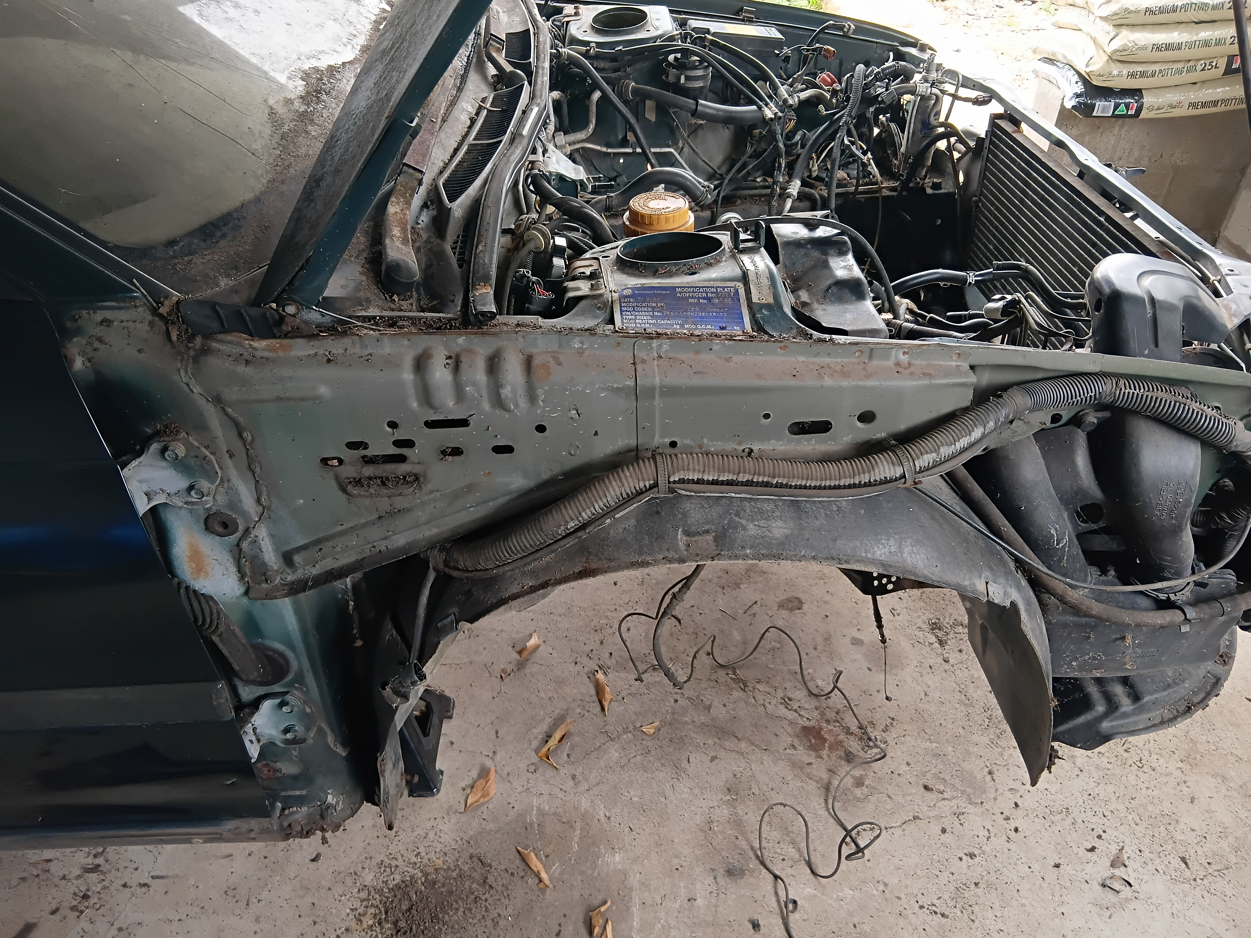

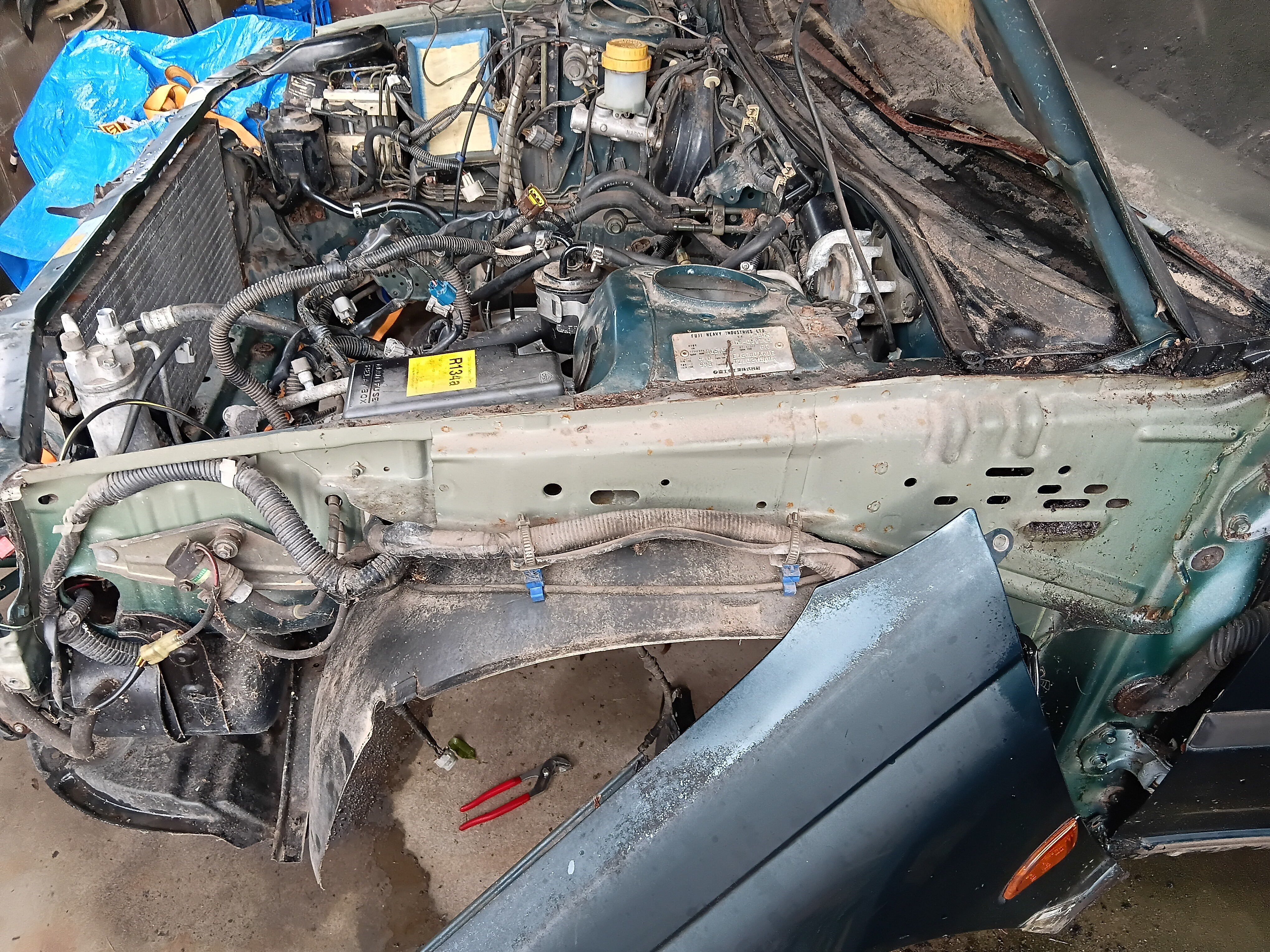

I've moved on from engine work to the rest of the car. There's much work to be done, here's where I got up to this weekend
Would've got further but the weather has been miserable for the last few weeks. In addition to cockroaches, ants, wasps and spiders, the car is home to some geckos. Hopefully they'll get most of the bugs I can't see.
Will be stripping everything from the engine bay and giving it a good wash. Lots of dirt, but only a little rust in the door sills so far.
