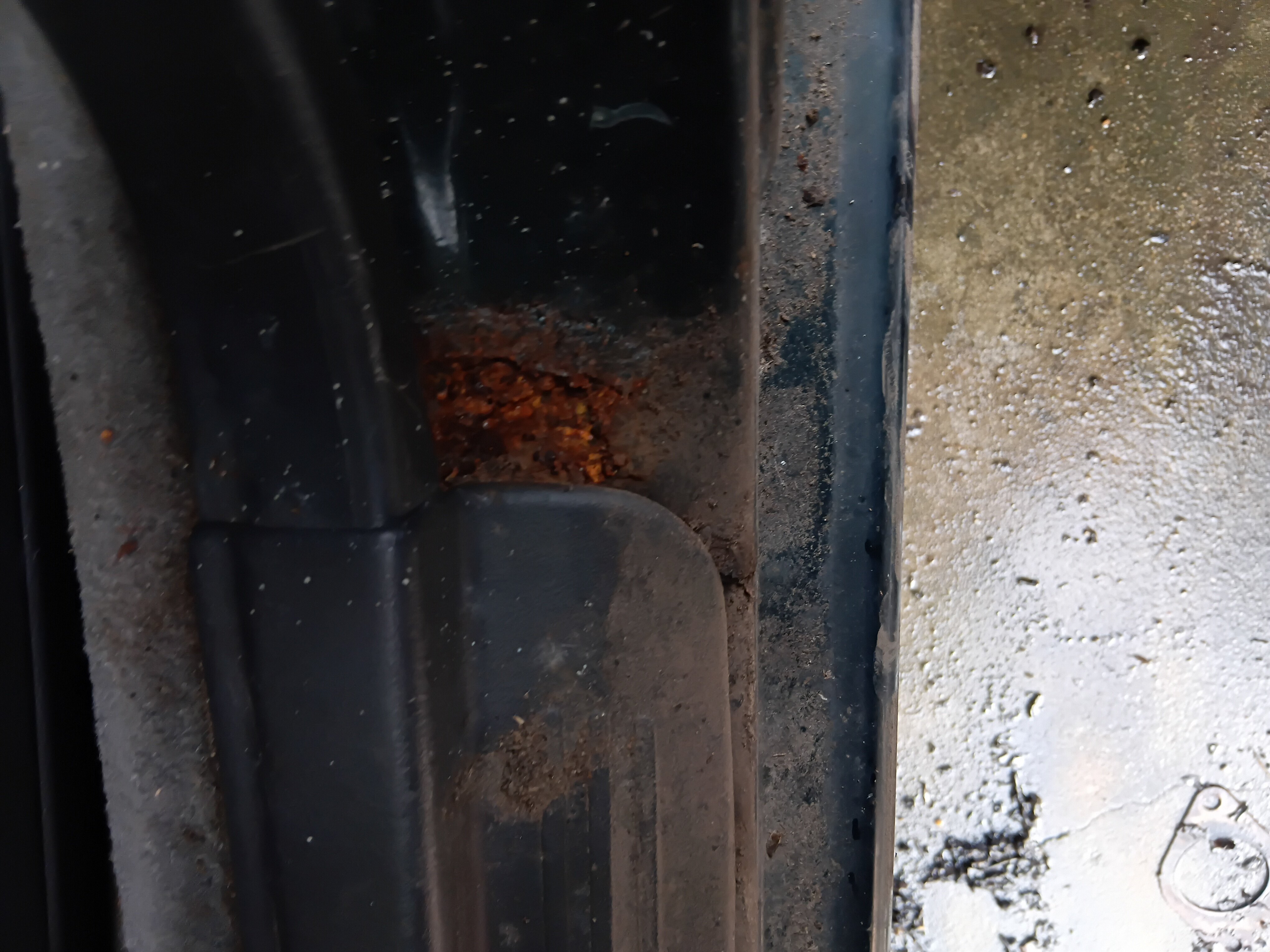

Will be stripping everything from the engine bay and giving it a good wash. Lots of dirt, but only a little rust in the door sills so far.

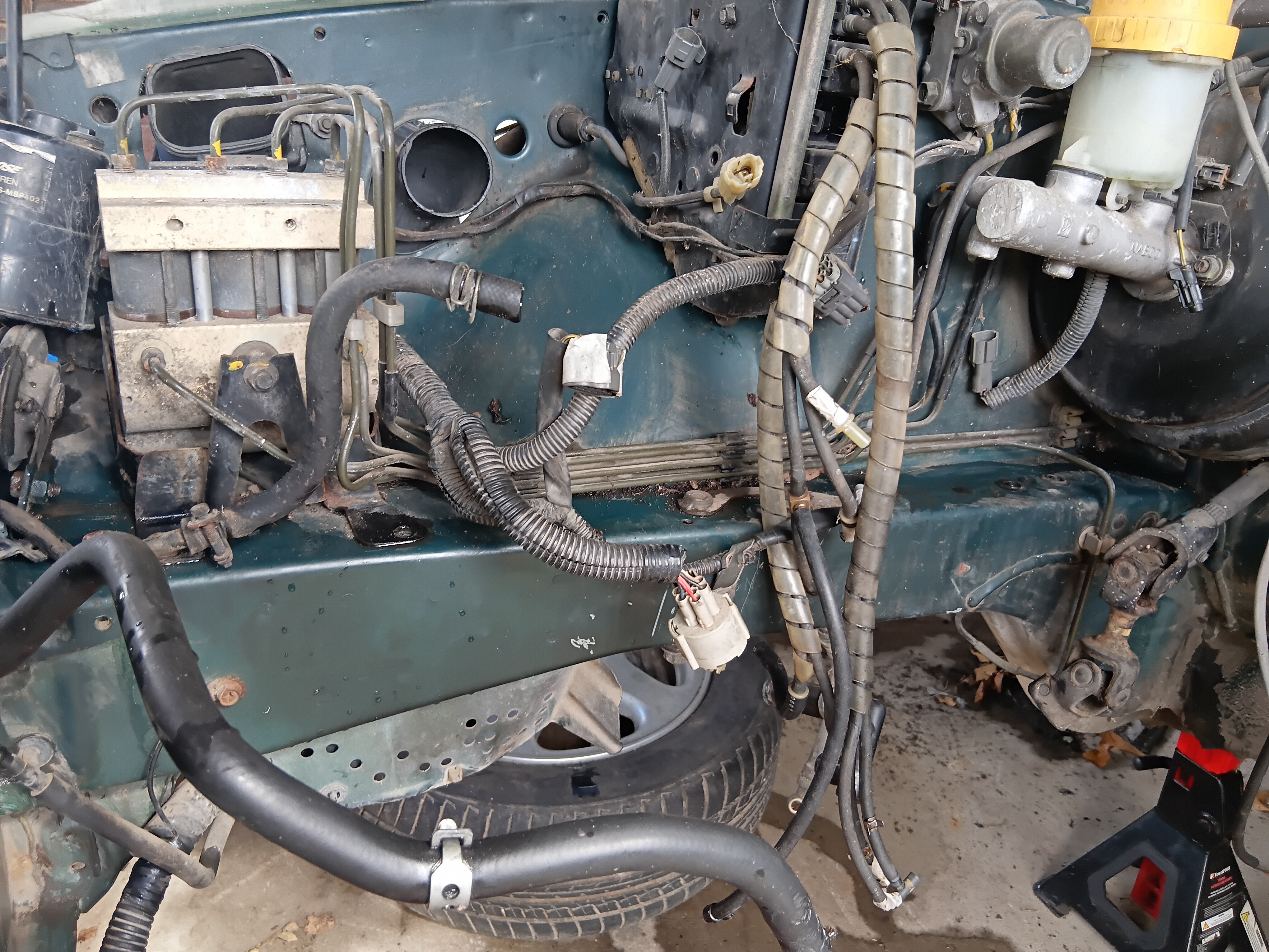

Doesn't look like it needs a respray. Can't wash it out properly because of all the masking tape labelling but here's how it looks after a clean with a rag

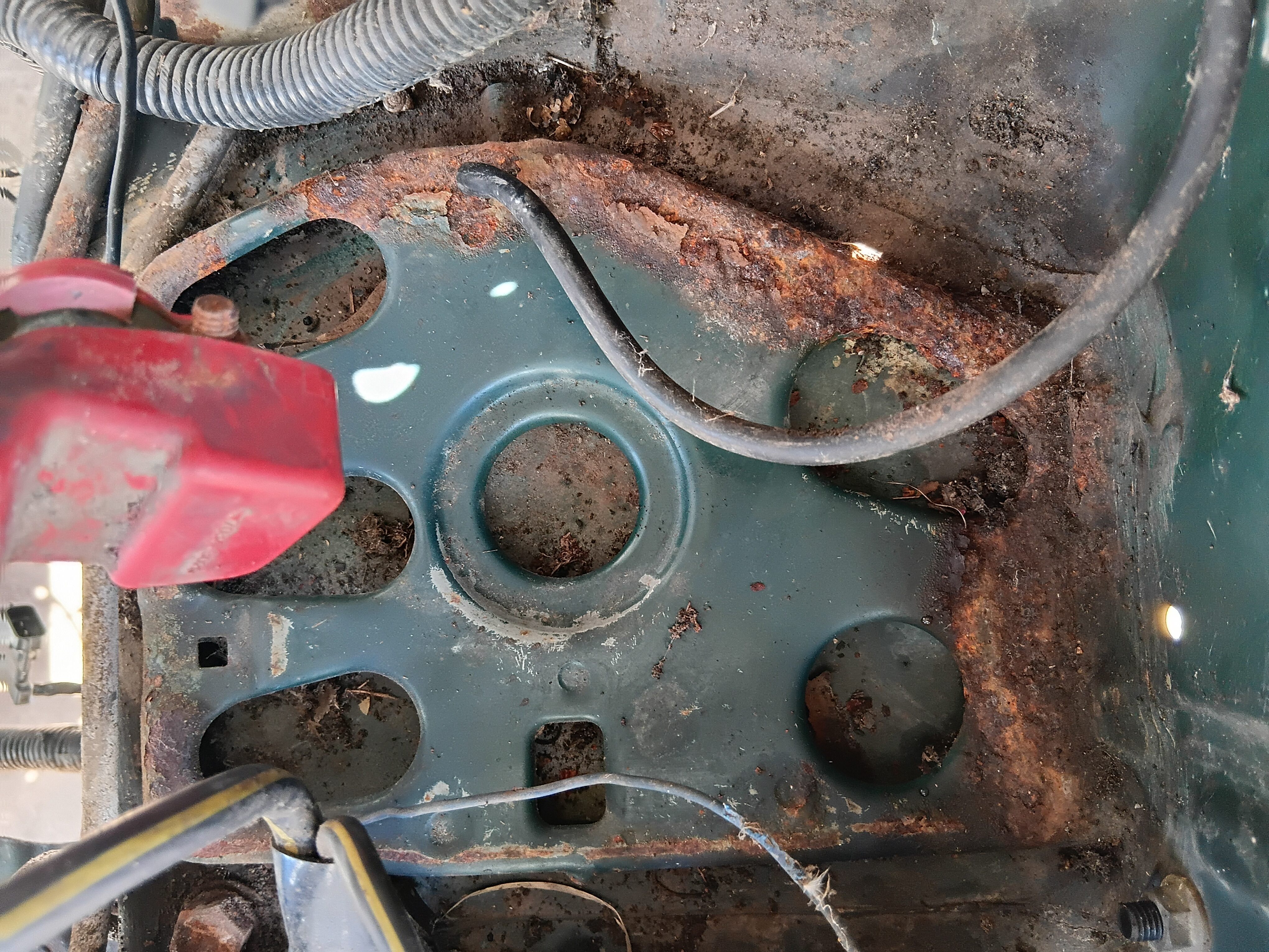

Here's the rust so far. Don't want to jump to conclusions but I reckon this should be the worst of it.
