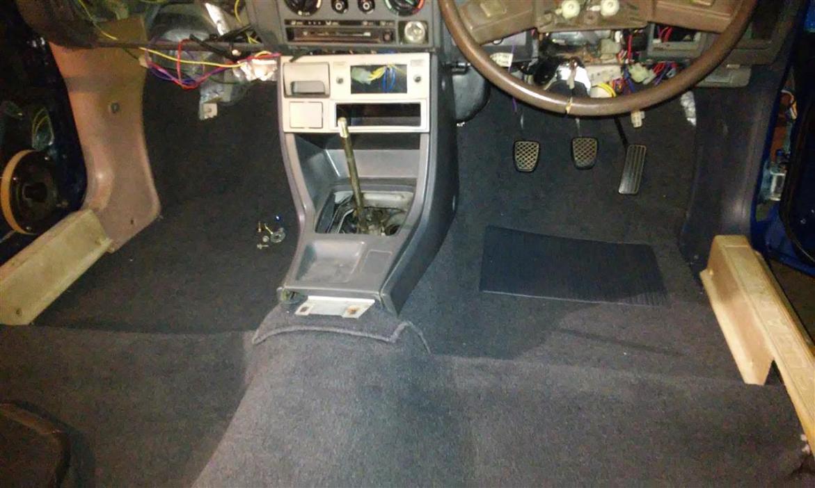

Post by Silverbullet » Sun Apr 23, 2017 7:48 pm
El_Freddo wrote:Looks the same as what we put into the brumby a few years back.
It's wearing well. Some areas where the driver rests their feet are getting furry on the walls but otherwise it's going well after about 5 years I think.
And no water crossings or mud puddles when offroading... That's a good one!!
I meant no water crossings through muddy bog holes :rolleyes:
Just water would probably be fine, since the underlay is closed cell/waterproof just the carpet would soak it up and need drying out.

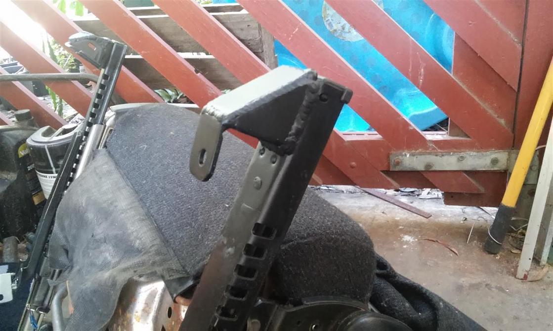

Some progress from this weekend; finished the last mounting point for the passengers front seat, had to get creative with this corner on both seats that's why I put it off and took so long :p Also hooked up/tested all the wiring to all the doors e.g windows, locks and courtesy lights so I could wrap the loom all the way through the cabin. With that done I could finish the sound deadening and start fitting the carpet. It's gone pretty smoothly and the front section is pretty much done with underlay. Having the old mat to mark out the holes would have made life alot easier but that got wet and mouldy years ago :rolleyes: No work on Tuesday so should be able to finish off the rear section and put the front seats back in at least, back seats need re-upholstering to match the fronts.
Fancy looking (but necessary) seat mounts for the rear bolt hole closest to the tranny tunnel.
How the interior looks after a day and half work on the carpet. Old trim pieces are just there for test fitting, they'll be replaced/repainted to look like the drivers side kick panel.

Post by El_Freddo » Sun May 28, 2017 9:59 am
Hey SB, how did you fit those outback front seats?
I've got a set of foz seats to fit to the brumby but would like to know how you did it before I try out my way ;)
Post by El_Freddo » Sun May 28, 2017 10:05 am
Hey SB neat work on the outback seats. Any further details on how you modified the mount points?
I've got a set of foz seats to fit in one of our brumbys and wanted to get further details of how you did yours. Also, how did you weld those tabs without burning holes in the seat's fabric?
Post by Silverbullet » Thu Jun 01, 2017 9:45 pm
El_Freddo wrote:Hey SB neat work on the outback seats. Any further details on how you modified the mount points?
Ahh sorry Bennie didn't see that post until now for some reason :confused:
Further details...details...well what you see in the pics is what I did :rolleyes: 1 out of 4 mount points lined up out of the box (front bolt closest to trans tunnel on each) the other 3 were miles off. Basically make carboard templates, one by one, transfer to 3mm steel plate, cut, weld, fettle, curse, swear etc :mrgreen:
The rear two were the hardest, with the rear one next to trans tunnel the absolute hardest; had to completely remove what was there initially and start from scratch with the bare rail. That part on my seats from the factory was MIG welded, spot welded AND riveted to the seat rail and were a real PITA to get them off. All that fixturing was probably a hint that they weren't supposed to come off :mrgreen: As for welding without burning holes, I have a fire blanket I put over anything sensitive which does a good job of keeping the sparks out. Also have to be wary of cooking the rollers and their grease inside the runner; to this end I put the rail to the opposite end of where I was welding, used spot welds not a continuous run and stopped frequently while spraying with water to keep things cool. Fingers crossed all the runners still seem fine so far.
