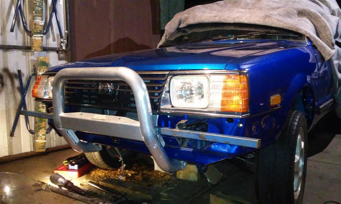

So I can post this pic of the absolute gem I scored at U-pull it this weekend. I've been hanging out for one of these for ages, never could find one with just the right shape/dimensions. This one is a proper TJM alloy job off of a pajero, got it for $29
Walked back down to the MY's to hold it up and see how it would fit, it's just right between the headlights etc etc.
It's only hanging there with fencing wire in this pic, I just had to see how it looked
Now to build the rest of the bumper around it. I'm thinking full alloy job all round with the faces of the bumper scalloped/fitted up to the bar and welded all round. I removed the original bumper stand offs from the old bent chrome bar and welded a piece of thick wall RHS to them as a starting point. The rest of the bar will be 4mm ally plate all round bolted to this steel bar.

Huh, I never even thought about different models having the same bonnet lines - this bar I just saw from a distance and thought "yeah that looks about right" and it was
Bennie, there will be no side hoops, just the center piece. I've got the full bull bar style thing on the ute and have to say I prefer this nudge bar style for looks. I haven't seen many MY's with this style of bar but I knew they look the best
I think littlewhiteute on this forum has one on the ute in his signature pic, I've seen another one on failbook and I think there was one other from a former member on here - a fully restoed and modded metallic green Brumby in QLD?
Gotta buy some ally plate now, so excited to get this together

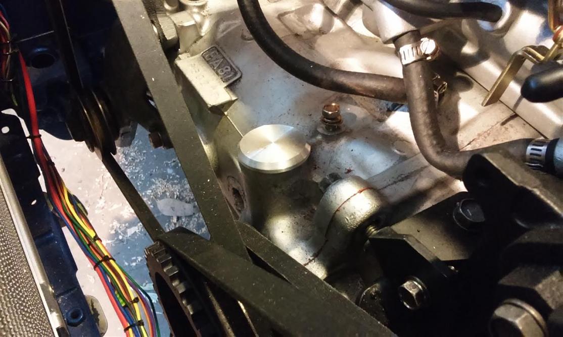

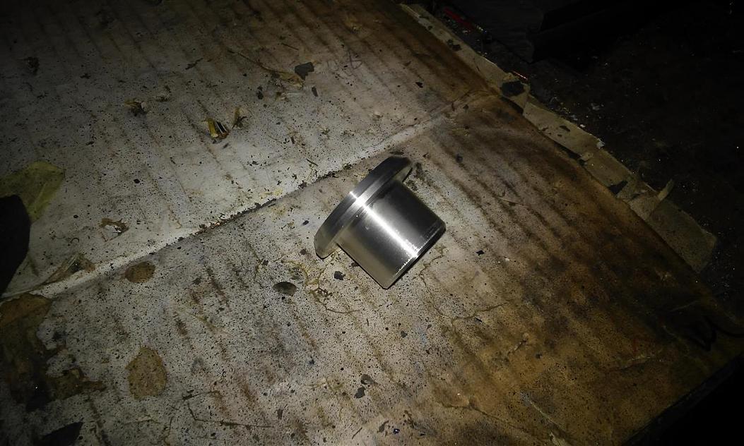

By the way for those interested, here is how I plugged up the distributor hole; An ally plug machined to slightly larger OD than the original dizzy. The hole is 27mm, the original dizzy is a nice sliding fit in the hole so must be 26.80mm OD or similar. This plug is more like 26.95mm diameter so was a really nice (tap in with a block of wood) fit in the hole, with a bit of loctite for peace of mind. No damage to the engine block, completely reversible if need be. Should have put a threaded hole in the top side for pulling out with a slide hammer but oh well

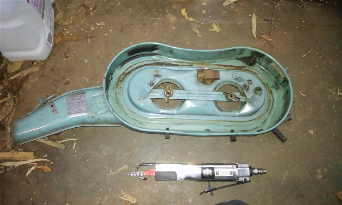

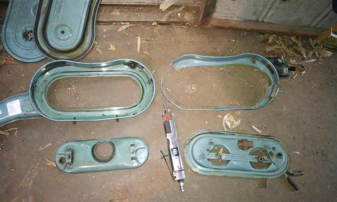

Got another new air tool (toy
) this week, to help me deal with the job of making a good twin carb air cleaner box.

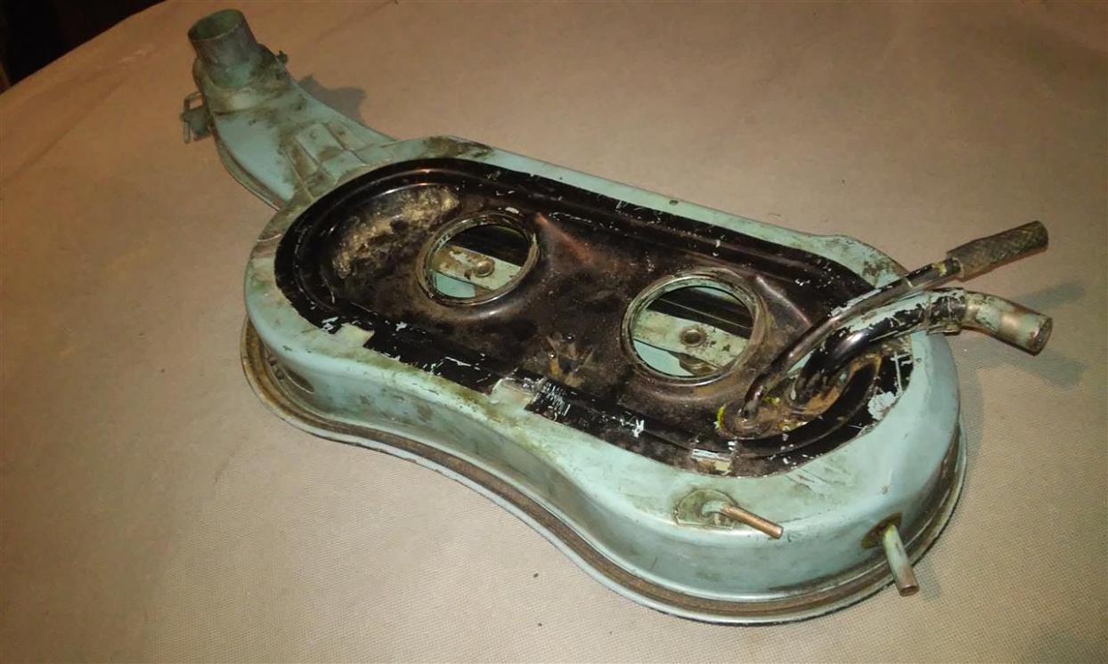

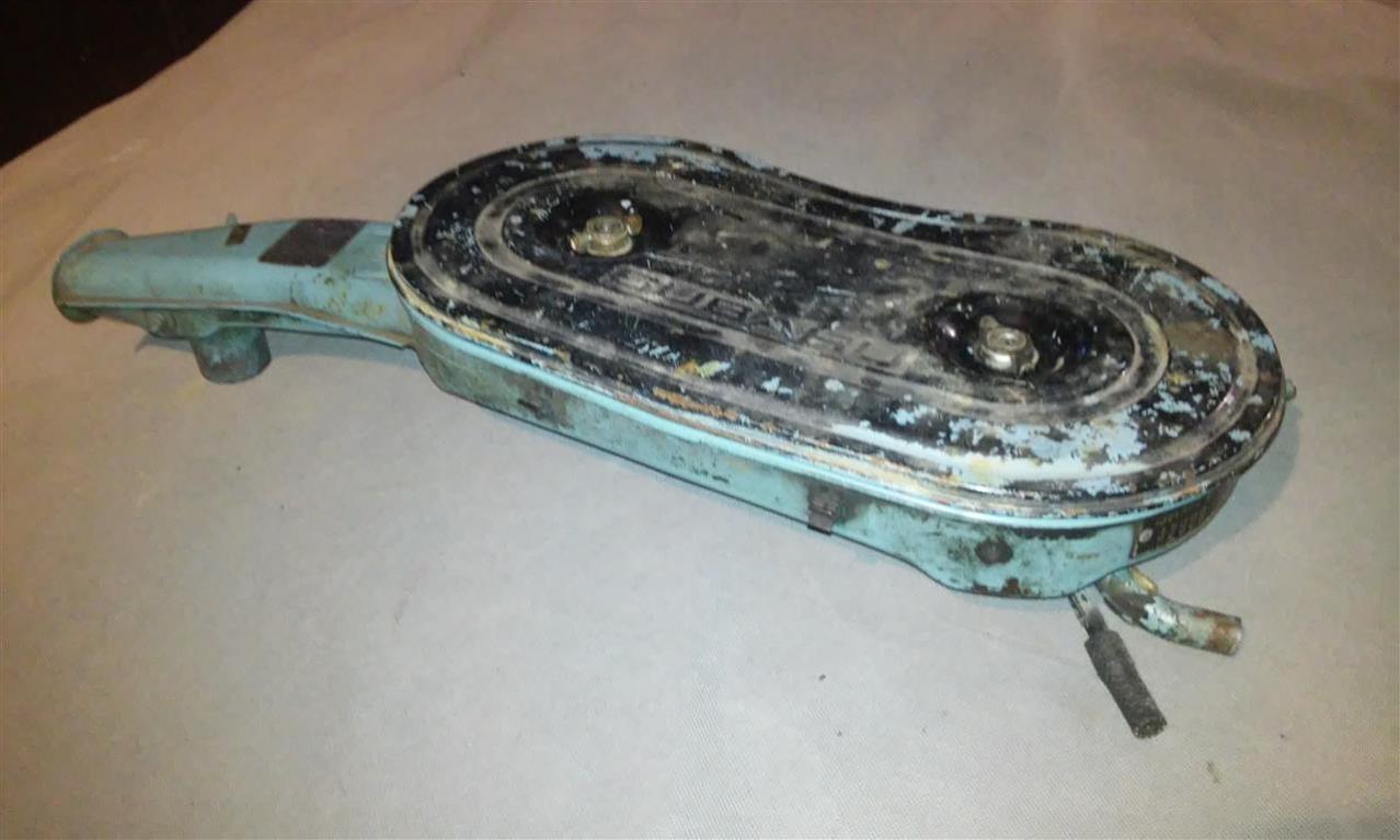

The twin carb air cleaner box that came with the engine was a bit battered and had some big holes cut in it, so I wasn't going to use it as is. I also had 2 perfectly good stock air boxes lying around so why not make 1 good twin carb air cleaner box out of the parts. The solution was to cut the center section out of the twin carb box (the center section and lid are the only different parts and were in good condition) cut the same section out of a stock box and weld the two together. It would have been very hard to cut out the parts neatly with an angle grinder (impossible) so I got a nice little air reciprocating saw to do the job. This thing moves at 10,000 strokes /minute with a 10mm stroke and cuts through sheet metal like a hot knife through butter
I've wanted one for a while, nearly bought one back when I was doing the rust repairs. Luckily a family member in the industry means I got this tool at cost price which made it very affordable
I haven't welded it yet - I've decided to TIG weld it for more control and a neater weld. I've got the new TIG welder and all the gear ready to go, just waiting on some shielding gas.

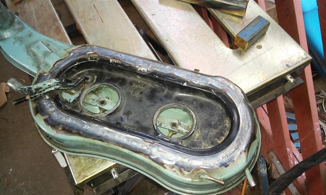

This week just gone I bought a bottle of argon for the new TIG machine so today finally had everything I needed to test out the new toy
And it wasn't long before I put it to work on its first proper job. The finnicky job of welding the air filter box back together, not for the feint of heart as the steel is so thin. I settled on 45 amps welding current (!) with pulse mode on (pulsing down to 25 amps twice every second) to limit heat input. I was was using 1.2mm mig welding wire as the filler material, 1.6mm tungsten electrode. It went quite well but there were some parts where the fitup wasn't the best and the melting edge got away from me - those parts aren't the prettiest. But all this is on the bottom side of the air filter so nobody will ever see it
The actual weld is so small it's hard to see in this pic
I love that factory look! Just needs a lick of paint.
