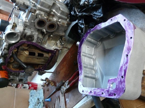

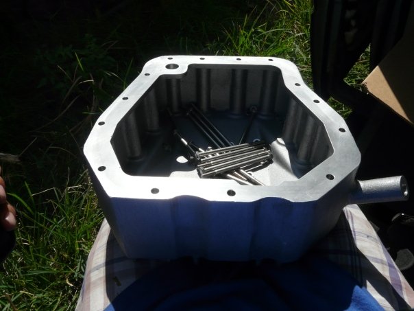

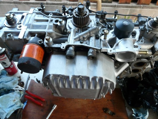

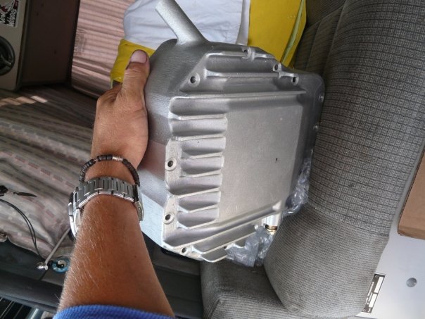

No real details, but here's his images I've "borrowed on a permanent basis":
Cast aluminium sump:
Smaller pick up pipe can be seen on the engine:
Finished result:

I got stuck reading what he got up to, didn't get to the end as I should be in bed... but he knows his stuff about these vehicles - even imported a an audi (I think) alpine gearbox or something, flipped the diff, made a bell-housing adaptor plate (bell housing to gearbox) to mate up the subaru EJ22... Then suspension stuff started and I phased out on that thread.
I wonder where these sumps could be found - my issue would be oil starvation when on extreme angles left or right...
