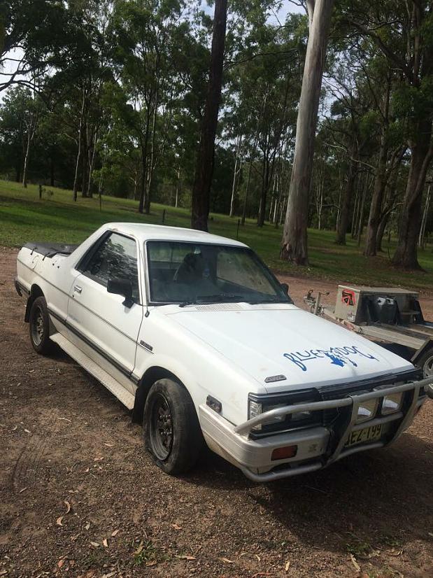

Hey guys, Love the forum:D tons of great info, have been reading for hours.
I'm a complete noob to the brumby world, but I've picked one up for $150 as a project, mainly because it was a hundred & fifty bucks lol but because I wanted something different and unique.
I want to street spec it, lower it etc
But first it's in need of a major clean up. It's had a rough life by the looks, but i reckon I can fix her up to showroom material :p
Have found one spot of rust in the footwell area, and lots of surface rust in numerous areas from stone chips and scratches etc.
So that's the first thing I'm getting onto. I will do a full re-spray further down the track.
I've started gutting the interior so I can rust proof and sound deaden the whole thing.
As u can see from the pics, it's quite disgusting :/
It needs a new cv & I can hear a bad exhaust leak up near the headers.
After the necessary boring stuff is done, Im going to look into making up some custom flared guards, some bolt on wheel spacers, coilovers and stancing it. As I think that wider body look will be different & look awesome in my opinion.

Ripped the front panels and guards off, & gutted interior. Was Filthy inside !
Chipped all the tar off the floor (glad that's over !)
Answered my own question about the rust under the tar, seems like I'm just getting it in the nick of time before it became a cut and weld job.
Tried a few different tools out and attacked some small areas just to see what I'm in for. As this is my first time doing anything like this.
Seems easy enough, but takes allot of time and patience.
So I gave it a temporary spray of rust proof primer for the time being, until I come back to it and do the entire floor in one hit.
Any handy tips & info are much appreciated, as mentioned this is my first go!
