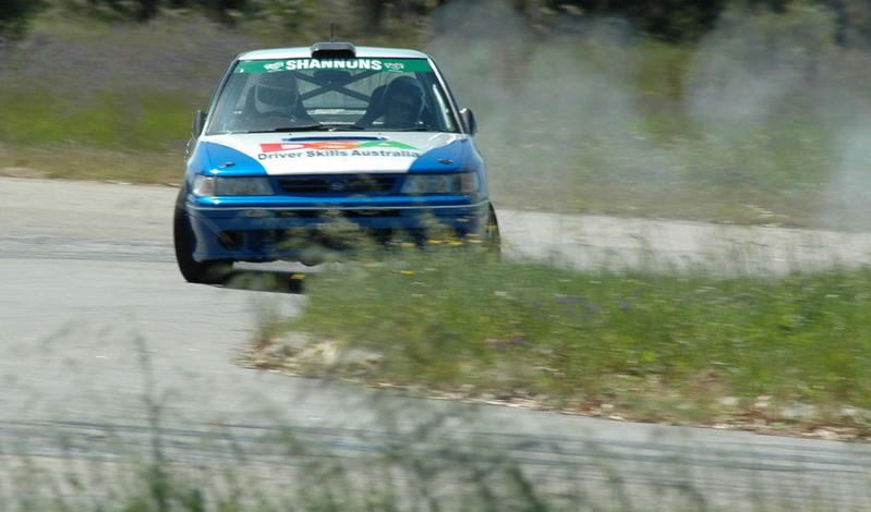

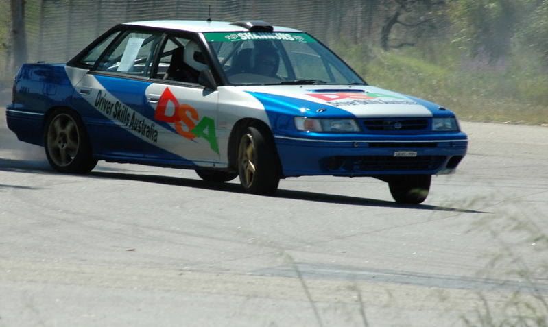

some one also said you can not drift a 4 wheel drive subaru , kind of pleased it was as it was the only thing pulling us out of the trees :)

seagull wrote:some one also said you can not drift a 4 wheel drive subaru , kind of pleased it was as it was the only thing pulling us out of the trees :)
I don't understand :(
You're telling me your Subaru rallycar broke a lot but your drift car is fine?
I don't know anything about drifting (except its boring to watch) but I would imagine that it'd be pretty hard on the drivetrain?
With the success of Subaru in motorsport since the mid 80s I would have thought that their outstanding reliability was beyond question. But everything breaks eventually doesn't it. To this end I am/intend running modest power levels, about 240fwhp, and keeping unloaded wheelspin to a minimum through the use of LSDs. As I have said before, this is no Trophy Truck. I don't pretend to think I'm going to be able to touch pro class buggies and class 4 trucks. My intention is to try to be competitive in class 7/8 and have fun. I could spend a few hundred grand straight up and been competitive as a frontrunner (maybe) but I wouldn't have started with a Subaru. And I wouldn't be having as much fun (because of the $). I hope you're gearbox predictions are wrong, but if I have to upgrade to a 6MT or use an auto then I will. But I think that is a fair way off yet. Now that the car is mechanically finished or at least the gearing decisions have been made I can start on the suspension. If I can't get some decent suspension travel then I'm not going to be able to go fast enough to blow up anything :)
