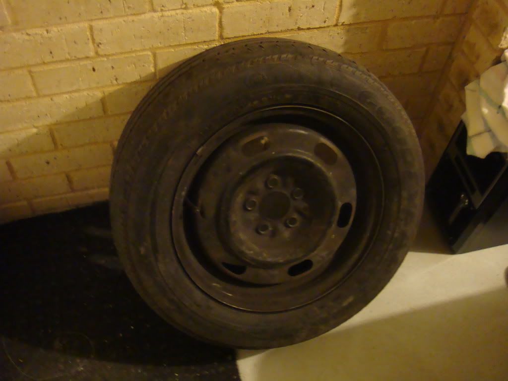

Post by AndrewT » Tue Dec 30, 2008 11:00 pm
Funny you posted that tonight Matt...I picked up the replacement wheels just a few hours ago.
Set of 5 PT Cruiser 15" steelies.
A rough measurement indicates they are positioned about 20mm further away from the car - that should help.
I will likely get some small wheel spacers aswell for the back two wheels to bring the rear end into line with the front end. Front end is currently wider due to running all Liberty crossmembers and control arms (Liberty is a wider car).
Naturally they look bloody awful at the moment. I'm open to suggestions on how to improve their looks. Obviously they will look a fair bit different when wrapped in massive chunky 29" tyres....I'm thinking maybe just painting them silver? No I do not want to put hubcaps on them! :)

OMG bro black rims...what a disaster :p

Paint them gloss black and get a set of chrome dress trims, this is what I did on my celica when I wasn't prepared to buy a set of rims and they came up a treat.

Post by AndrewT » Wed Dec 31, 2008 8:19 am
Yeah that's not bad actually! I'll likely do that and also get some kind of centre cap like that too.
What I don't like mostly is black MAG wheels. You can't even tell they are mags half the time, they just look like a car who's hubcaps have fallen off :)

why aren't u running alloys?15's are getting cheap,i had some rs rims with offroad tyres once,looked good
Post by AndrewT » Wed Dec 31, 2008 9:49 am
Offset too close to the car. These rims are set particularly wide, hence the rather obscure donor car (PT Cruiser).
I'll probably also get some new chrome wheel nuts for them too :)

i was thinking PT cruiser mags not stockies. ewww. maybe get some red wheel nuts?
Post by AndrewT » Wed Dec 31, 2008 2:14 pm
lol yes, perhaps I'll ramraid bunnings plumbling and get me a snorkle happening too!
I'll likely end up with something else in the longer term wheels wise but for now this will fix my immediate offset problem cheaply.

the only other way i can think is to get bolt on spacers that would bring the wheel out

I'm surprised you didn't look at a set of PT cruiser alloys AndrewT - I dunno how they'd go off road but I reckon they'd look alright. Also dunno how much these things are worth...
