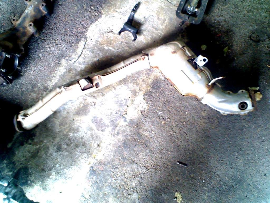

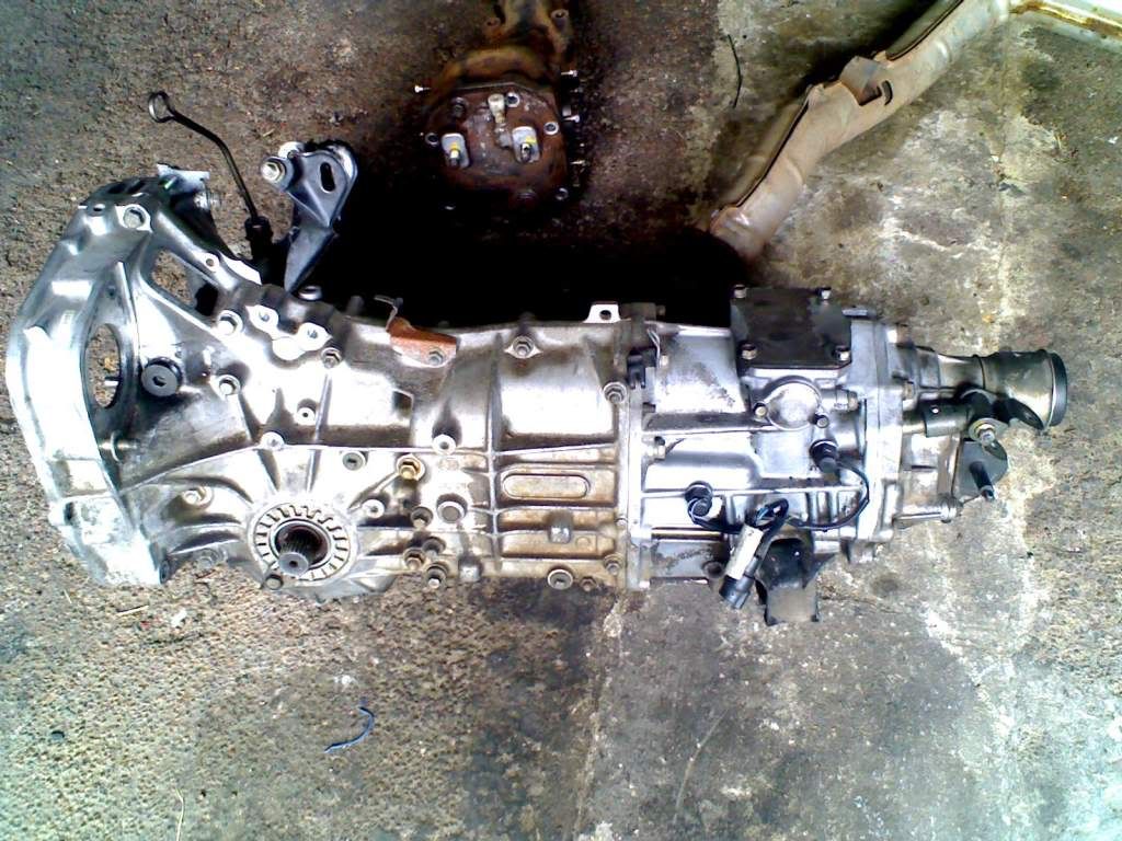

Some pics of the recent new junk;
RS Turbo gearbox modded to RWD (not that you can see the mod);

Yet another new dump pipe to throw in, this one is an 02 STI one apparently
