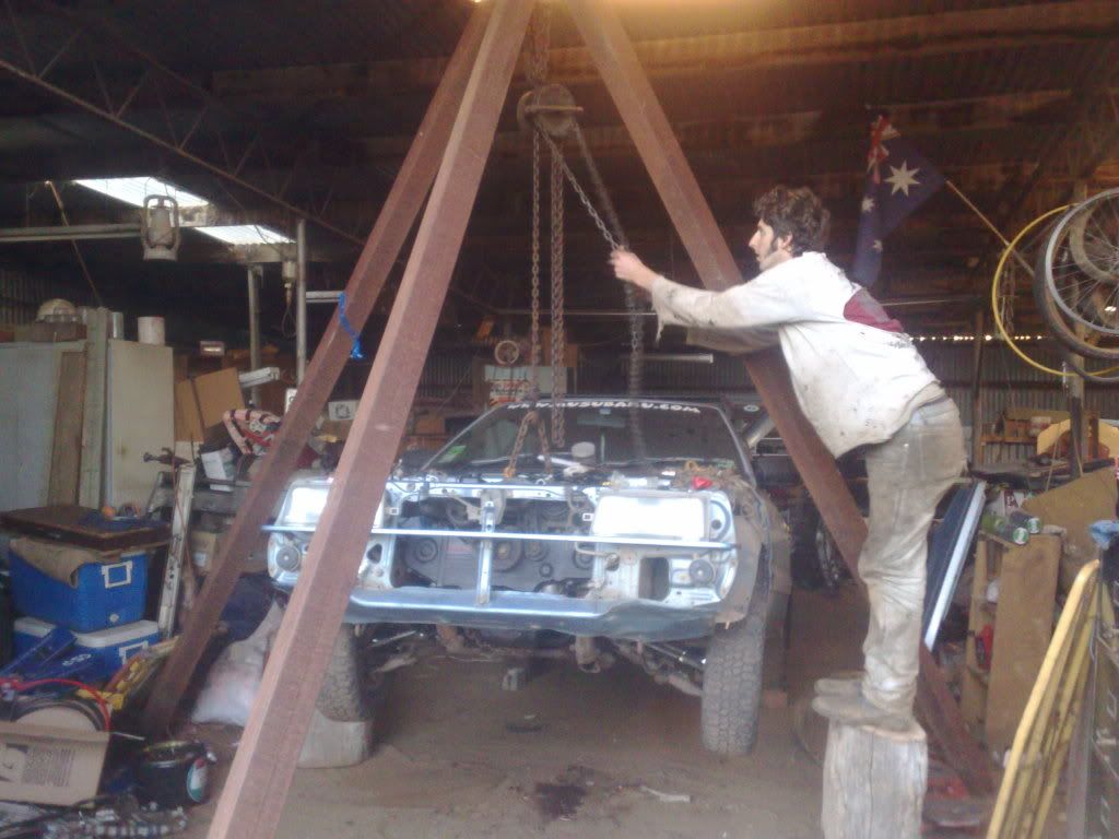

After doing some disconnecting, getting the tripod in place and sorting some "custom" jack stands it was time to get the subi front end up high enough to drop the engine, gearbox and front end out from under the subi. This is how it went:

Pic of Bennie lowering his Subaru... taken from my phone..
