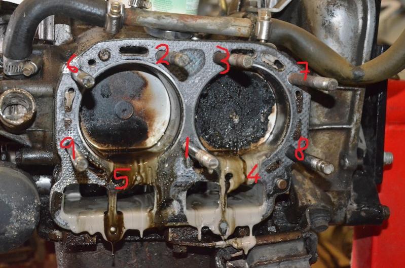

Here you go,
Doug
Posts: 12712
Post by El_Freddo » Tue Aug 20, 2013 10:06 pm
Thanks Doug,
Sorry I got it backwards as I was referring to the pattern to remove the heads as #9 being the painful one - it's actually #1 as you've correctly stated above.
I was hoping your image would be the tool used to torque up that nut behind the rocker assembly ;)

MMMMM sludge ... Bennie you could try the diesel trick everyone goes on about, but I wouldn't.
It would probably be better to go with the used oil and filter (filter with out creamy goodness)
The internals look pretty good, but I would be very wary of the other welch plugs.

Full strip down Bennie! makes cleaning the gunk easy ;). Gotta pop the pistons anyway. Leave all the case and big end bearings alone, clean it out and put it back together. A Few hours work :D.
