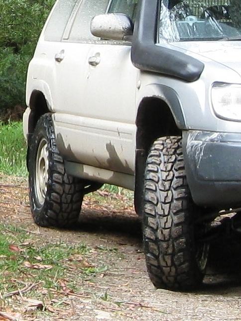

I have the Kumho Road Venture KL71, excellent tyre offroad. Very tough & good grip, not so good onroad though, typical of a muddie.
- Muddies 02.jpg (62.39 KiB) Viewed 52111 times

Yeah they're the ones I'm looking at atm as they're one of the ones that still do an offroad tyre for a 14 inch rim.NachaLuva wrote:I have the Kumho Road Venture KL71, excellent tyre offroad. Very tough & good grip, not so good onroad though, typical of a muddie.
But again my issue of the rear shocks becomes an issue. Once I get my EJ 5 stud adaptor hubs I'd be keen to try one of your rims and tyres on the rear of Ruby Scoo to see if this is a suitable solution to my needs

Yeah sure. Would be cool to see how Ruby Scoo looks with 28" muddiesEl_Freddo wrote:Once I get my EJ 5 stud adaptor hubs I'd be keen to try one of your rims and tyres on the rear of Ruby Scoo to see if this is a suitable solution to my needs![]()
