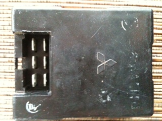

I think I have found the culprit. The low pressure fuel pump turns on when I turn the ignition key to on but when the car is running the low pressure pump is not running. So the low pressure pump primes the surge tank but stops working when the car is running causing the EFI pump to suck the surge tank dry after a while. Tracked the low pressure pump wiring back to this mitsu part deep up under the dash..
Anyone know what the part is called? And does anyone is SEQ have a spare one they want to sell?

Posts: 12707
Post by El_Freddo » Tue Feb 05, 2013 8:12 pm
lovey80 wrote:Anyone know what the part is called? And does anyone is SEQ have a spare one they want to sell?
I can tell you now that it's not that this little box is stuffed. It's looking for an ignition or rpm signal to continue running after initial start.
This box is designed to run for ~5 seconds then stop. The engine starts, little box gets some sort of signal to say the engine is running and it then continues the fuel pump running as well. It's a safety device in the event of an accident - fuel can't be pumped all over the place...
Find the signal wire, work out how to wire it into the EJ system (tacho maybe?) and problem sorted.
Or run the relay referenced from the EJ's fuel pump wiring as you've already said.

Post by steptoe » Tue Feb 05, 2013 8:26 pm
good find - the L Series had one of these very similar up under the dash RHS, but not likely to be interchangeable I bet. A chance for an anti theft device here me thinks.
You do not wanna price one of those babies from Subaru - in the three hundreds.
I wonder how others got around this unit interfering ?

Post by lovey80 » Wed Feb 06, 2013 10:38 am
Thanks Freddo, a long conversation with Rick (RTCB) had me to that conclusion. I figure it is easiest to simply wire in a relay to the EFI pump power lead then hard wire it to the battery.

Post by lovey80 » Wed Feb 06, 2013 8:41 pm
Ok, so after using a relay to open a direct power source to the low pressure pump all the problems with the fuel line have been solved. No more EFI pump squeeling after a period, and I can hook it round a left hand corner on full gas without any starving of fuel. Thanks for the reply's!
