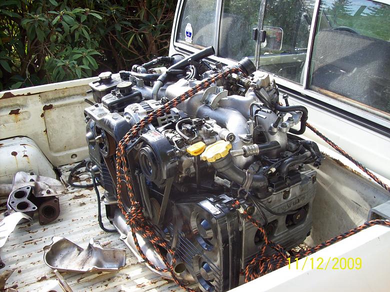

Hi all,
I just picked up an ej20t for my rx. Can someone please plumb me up on potential donor cars ? I'm not sure what compatibility issues there are and if the ecu is trans or turbo specific, as well as the harness. Time to revisit some excellent conversion threads.
Thanks, Mark

EJ20T is not an official designation. It is used for all 2.0L single turbos. So yours could be anywhere from 1993 to 2009. There are a couple of differences in ECU;s and harnesses, but basically 94-98 are all very similar. If you take the oil filler cap off it will have the year of manufacture on it (assuming the cap hasn't been changed). Post up some pics and people might be able to identify it.
Did you buy it just as a motor or did it come out of a front cut or have a gear box attached ? Can you get the gearbox code or the vin plate will have the engine and box code if you can get hold of it.

niterida wrote:EJ20T is not an official designation. It is used for all 2.0L single turbos. So yours could be anywhere from 1993 to 2009. There are a couple of differences in ECU;s and harnesses, but basically 94-98 are all very similar. If you take the oil filler cap off it will have the year of manufacture on it (assuming the cap hasn't been changed). Post up some pics and people might be able to identify it.

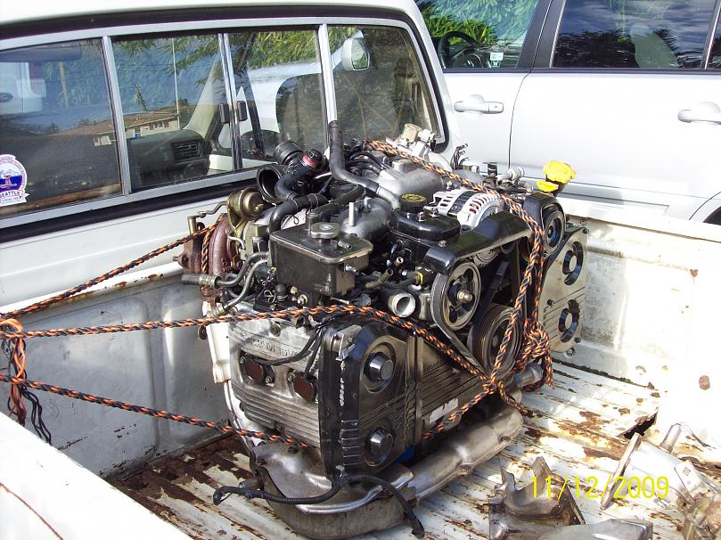

Its a '93 according to the oil cap. I bought motor only from an importer. They listed engines serial nunber as A779077B. I took a quick look at the engine ( dark here and raining like crazy ) and I'm not sure where they pulled sn from. Heres a couple pics if it helps.
Thanks! Mark

I'm not 100% sure but I think that is an RS motor - there are 2 bolts holding the plug caps on, the WRX's only have 1 (or is it the other way around?)
If its an RS motor it may have noisy lifters which they all end up having. Only real way to fix them is with WRX heads AND pistons.

I have just checked and that is definitely an RS motor. So 93 is probably correct. you need a 94-97 WRX loom and ECU, or 89-93 RS loom and ECU.
There is nothing wrong with RS motors, even if the lifters start rattling it will still keep going OK. It will lose a bit of power but probably nothing you would notice, and it wil lbe noisy but just fit a loud exhaust and crank the stereo :twisted:
And you have to move the knock sensor or it will think it is pinging and go into limp mode.
