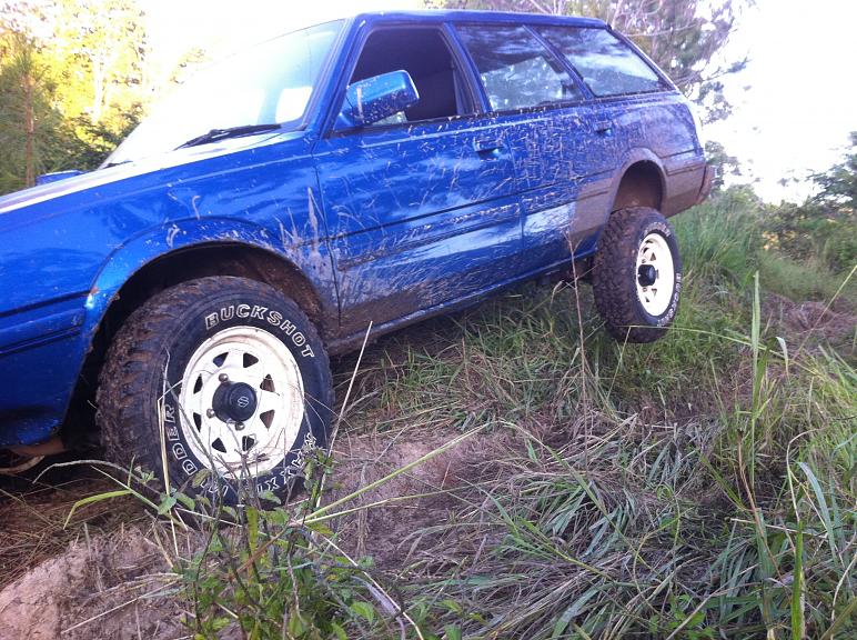

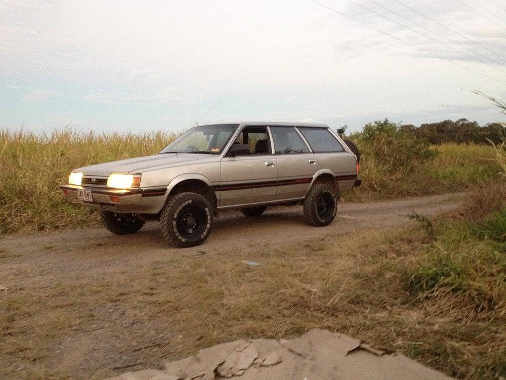

wow mate looking good! i put a 4inch in my l series and its great off road i have tried a few tiers but the best i have found are-27inch maxxis buckshot mudders- pretty cheap too, i spend a lot of time up rainbow beach towing a jet ski and full of camping gear and they go great guns.. here are a few pics for ya of my old blue and my new silver wagon...

Thanx for the info I haven't done research on tyres yet I am wait for my five stud conversion to arrive I have to find a set of rims for it first I have my old legacy wheels I will put on temperererly The photos look great
