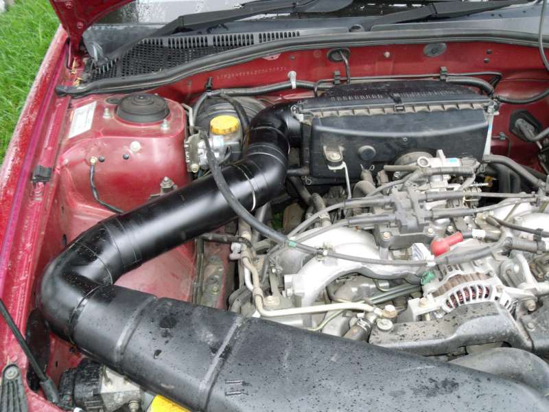

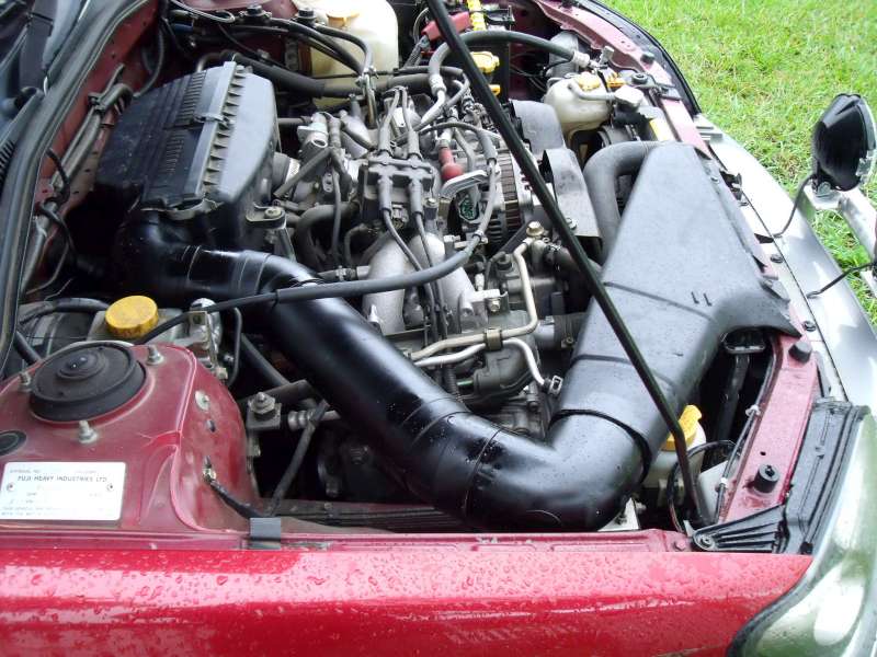

Got bored, so i made a new intake
Post by Gannon » Wed Dec 30, 2009 6:38 pm
First week of my holidays and its been raining since monday. Not happy, i had heaps planned.
Anyway, i got bored and got thinking about the tiny size of the intake on my Outback, so i went to the hardware and bought two 90, one 45 and one 22 degree 90mm stormwater bends.
I got a 90mm holesaw and cut a bigger hole in my airbox, and then used the bends to connect it to the over radiator intake funnel.
It isnt finished yet, im gonna drive it for a week and see how it goes, it needs a support bracket and its kinda noisy at low revs (sounds awesome above 4000rpm) so im thinking of grafting the resonator back on.
Pics
Not bad for about $17 in materials

Yep, and then you get stuck into the engine with a 9" grinder, eh Gannon? Not likely to be a problem though - that's the standard Outback intake position, and seems to work well.
If you're interested in doing a stage 2, I'd aim to bend or replace that intake funnel to give the air a straighter path straight back towards the airbox entry. Looks good now though.

The little bit on the end of the funnel is a woeful restriction. Thats why i cut it off and heated the funnel up and jammed the piece of 90mm pipe up there. Its much larger now.
