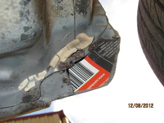

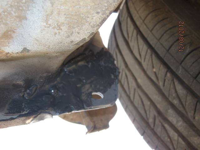

This one was blasted last week.
Cardboard template made.
Steel cut welded in place, dillberrys ground off, smear some seam sealer around and drill the hole.

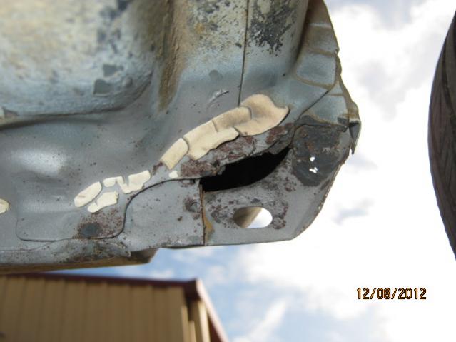

Post by revmax » Sun Aug 12, 2012 6:06 pm
AHHH remember this one.
Managed to cut the rust out with a 5" makita angle grinder, it is 5" but has a 4" motor which makes it ideal for getting into tight spots. The cutting wheel was one of them 1mm thick ones.
Got the metal stiched in but ran out of wire, the welds were a bit like duck poo and I am thinking I should have used my shorter 15A extension lead that I used earlier in the day.
