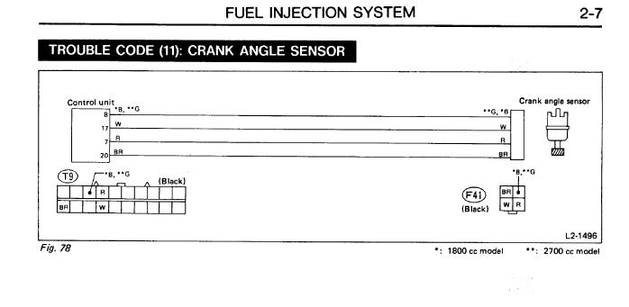

dose anybody out there have the wire diagram EA82T 4plug ECU dizzy??

Post by Gannon » Thu Dec 10, 2009 7:14 pm
Here is the diagram for the Crank angle sensor (dizzy) for the 88 Vortex
It should be very similar to yours.
But what are you going to join it to? You have to find the 4 wires that go to it. Im sure that the wires you show there arent the ones you want.

Post by sb2752 » Thu Dec 10, 2009 8:36 pm
hmmm cheers for that il guess il just have to keep trying to sus this thing out
Post by steptoe » Thu Dec 10, 2009 11:43 pm
So what is the control unit in the diagram? Is it the 4 plug ECU, a little condensed, showing pin numbering? If so, you need to id those pins on your ECU, check the wiring at ECU end and send a trace signal down each one at a time to find the other end which should hok up to your dizzy. Easier said than done as usual.
