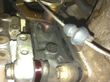

I will try and get some pictures tonight, when the liquid came out it was more like seep, I noticed that it was a bit wet after going at it with carbie cleaner and it was definitely coming from the inside rather than overspray or dribbling from the top. Although from memory it wasn't right at the bottom of the carbie... Ill have to clarify though.
Yesterday I tried on four separate occasions to start the car with 'start you bastard' and had no luck. although I had no one else around to crank while i sprayed just gave it quick squirts then turned it over.

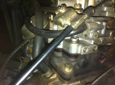

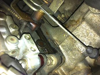

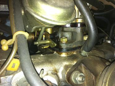

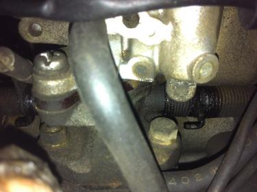

Pics
Hey,
So here are some before and after shots - spray this time was 'start you bastard' rather than carbie cleaner.
[ATTACH]3942[/ATTACH]
[ATTACH]3943[/ATTACH]
[ATTACH]3944[/ATTACH]
[ATTACH]3945[/ATTACH]
[ATTACH]3946[/ATTACH]
Looked like the liquid came from the protrusion with the red center to me, it got wet before the rest.

Looks like the fluid is coming out of the throttle shaft, both main and secondary. May be time for a carby rebuild? I had mine fully rebuilt and tuned by a carby specialist and really wished I'd done it years before hand.

Hmmm Think this could lead to a stalling problem haha, I feel like it happens most on Hot days also or when coming from highway speed to stop start traffic.RSR 555 wrote:Looks like the fluid is coming out of the throttle shaft, both main and secondary. May be time for a carby rebuild? I had mine fully rebuilt and tuned by a carby specialist and really wished I'd done it years before hand.

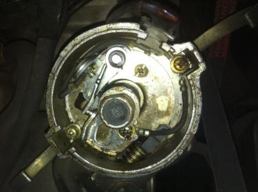

The car will be visiting the mechanic this arvo, I quickly exausted my own knowledge and patience - and I think the Battery!
When tried the spark test on the leads post distributor there was no spark. Then tried the coil lead again and no spark. (despite there being a spark a few hours earlier from the coil lead)
Car sounds laboured when turning over now, loss of charge or starter motor. Bahhhh...

No spark...hmmmm, you may have some dirty points or something along those lines. If you look into the distributor, there is a little contactor that looks a little bit like a relay. as the sharft rotates, the pads connect and disconnect. Those pads need to be clean and they need a dampening cap to stop arking (little cylinder thing on the outside of the distributor, connected to the wire going into the distributor). I cant remember how much they need to open from memory....something just under a mm I think. What you can do to save your poor old starter motor is get your coil lead, put it against some metal somewhere, then turn your ignition on and gently open and close the pads inside the distributor with a screwdriver. If it sparks when you do that, but not when you crank the car, then it needs adjusting. If no spark still its probably something dead.

Probably low volts/amps left in the battery after all the cranking. Just give it a charge for a day and see how it holds up.GunFactory wrote:Car sounds laboured when turning over now, loss of charge or starter motor. Bahhhh...
No gap on the points.. great.. glad problem is found.GunFactory wrote:NRMA came, No point gap while cranking. Heading down to mechanic to get adjusted and ignition timing back in order.
It's a possibility but highly unlikely. I would get the mechanic to check the wear/play in the dizzy shaft. I would suspect that due to age, the bushes have probably worn.GunFactory wrote:Anyone ever known them to come undone? New points installed less than a week ago, could they be loose then come out?
The other thing is the points need a small spot of lubricating grease. A dob of grease on the dizzy lobs will reduce the amount of wear on the points, in turn reduces the need for constant adjusting.
It may even be time to change to electronic dizzy

All sorted, I now know how the hell the points work haha. Mechanic showed me how to test that there is a spark at the points as well as reseting the timing.

Can points come loose? I would believe it on my old dizzy; the two phillips head screws that hold the points down were nicely rounded out with barely enough left to tighten them down. Even then I never had a problem though.

Yeah mechanic seemed doubtful, said he had only seen it a handfull of times, Car ran beautifully after they went in.. for about 400km then.. haha.Silverbullet wrote:Can points come loose? I would believe it on my old dizzy; the two phillips head screws that hold the points down were nicely rounded out with barely enough left to tighten them down. Even then I never had a problem though.
Did he check the shaft play?
Did mechanic tell you that Kettering got his name on this sort of ignition system ? If you set the timing and points gap to spec, and somehow, wear or loose screw the points gap decreases your timing goes out retards, gets closer to TDC, performance can be a bit lacking just before she won't start on you again . Post #10 eh?

On the money Steptoe!steptoe wrote:Glad someone listened to me back at post #10
