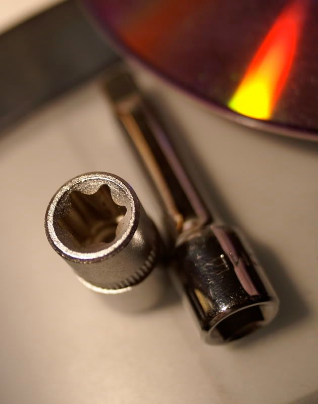

I have the correct special socket to get the studs out of the diff if u need it.

Post by AlpineRaven » Sun Jul 01, 2007 7:29 pm
The correct tool you need is this T10 - Image
Yes you can get them machined and put snap ring in (I've done this once) so that you can use old CVs with EJ's diff.

Post by 90brumby » Sun Jul 01, 2007 10:53 pm
is that a 1/4 drive cause i think iv only got a 3/8 drive socket

Post by AlpineRaven » Mon Jul 02, 2007 7:54 am
3/8 Drive I think it is.
