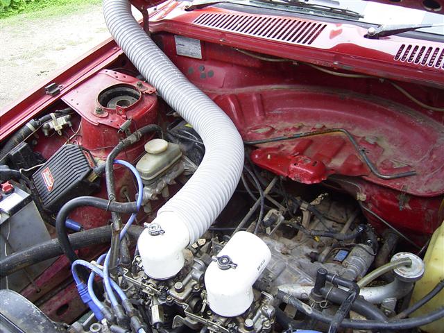

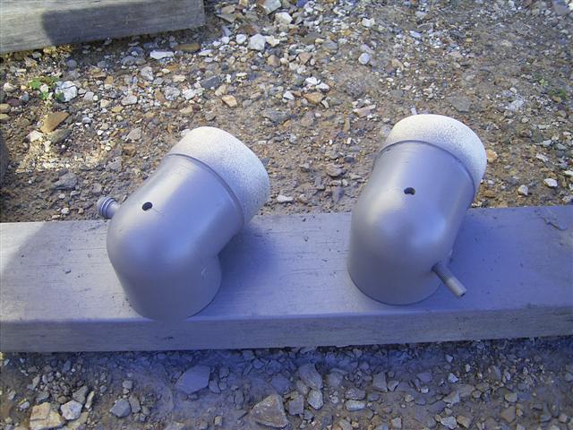

A mod I made for my dual carb EA81 motor. Never used it in the end on the DC but used one on a mates L series.
Just 90degree bend 60mm PVC pipe from the hardware store. Thread extender, drilled the centre out of a 25mm long 10mm bolt and threaded it to the carby thread then for a short piece of threaded rod to extend.
Drilled some holes in the sides and heated up brass fittings, then screwed them into the holes for crank case vents and PCV. Siliconed a 75mm PVC storm water pipe to the end to take pod filter or snorkel pipe.
With the carby gasket its water tight.

Phizinza, that looks perfect for what i have. i havent go the dual carby tho(less work for me i spose lol). the pipe looks like its at a fair height, does the bonnet close properly with this?? and would the length in tube from the filter to the carby affect performance in any way? i.e. longer tube = reduced horsepower? where might you think i should position to pod filter to maximise cold air intake. cheers.

Yeah, I chopped a couple more holes in my original airbox to get more air flow in. No use having that much surface area with only a tiny hole into the airbox.
CAI is the only thing you can improve on with the original airbox, cut up a bit, IMO.
I had 2" lift and there was more then 40mm clearance.. Not sure if it would work with no lift or not.
My plan was to have a square airbox sitting right behind the carbs that those two pipes went into then have a scoop on the hood for CAI. But plans change and you grow outta that "cool looking" thing.
