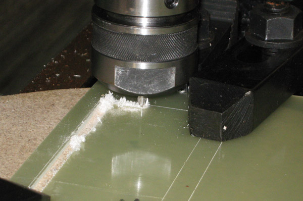

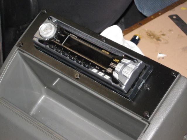

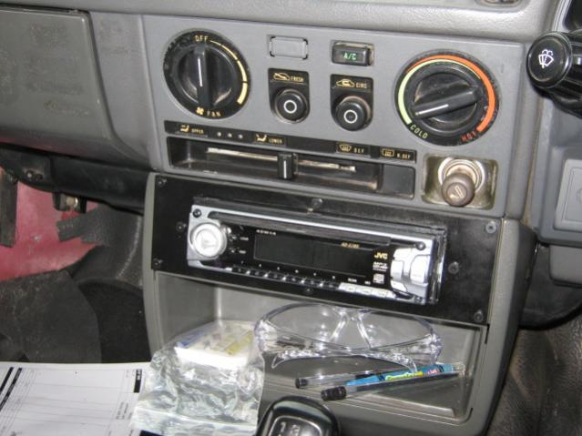

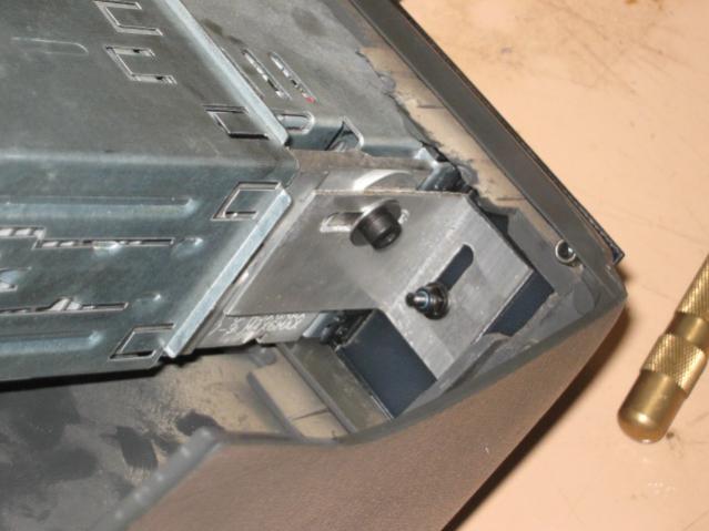

Then cut a plate out of G10 fiberglass on my mill, dust coat of black paint and screwed it to the front of the console. Then made up some brackets to bolt the CD player to the G10. I had some 2mm Carbon Fiber sheet which would have looked realy cool, but I am getting low on small slot drills and CF is realy hard on them so figured G10 will do.

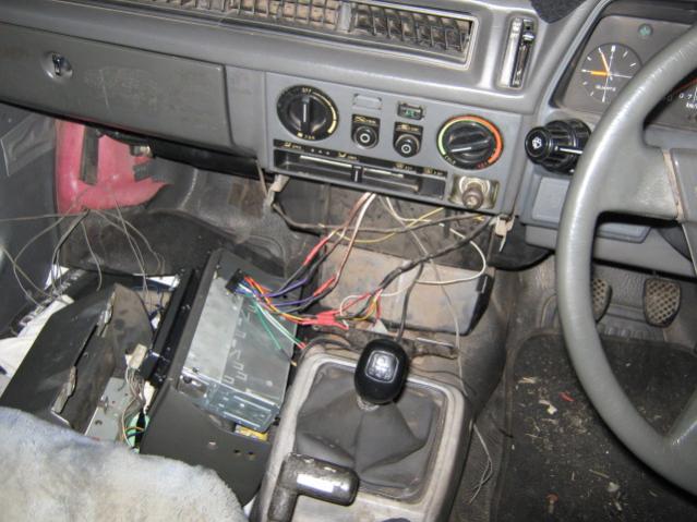

OK . Just in from running cables, Cutting holes, soldering connections and working out which wire goes where. (No smoke either)
Have to cut some 4mm spaces so the speakers will sit flat on the door lining, Might use masonite and will cut them on the band saw at work tomorrow.
Far out it is time consuming.

That looks great btw revmax, almost like it's supposed to be there
Steptoe the G10 is 1.6mm thick.
G10 is considered pore mans carbon as it is OMG strong and cheap compared to Cabon Fiber.

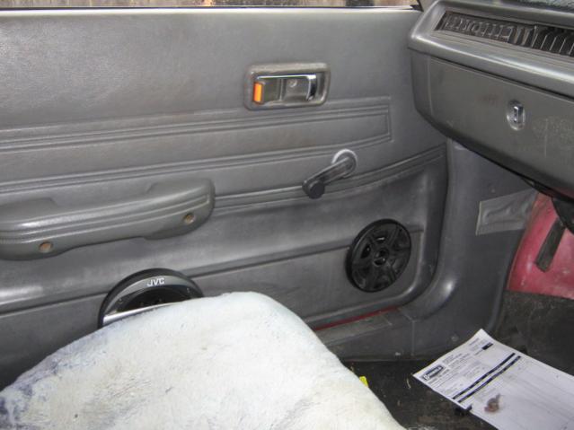

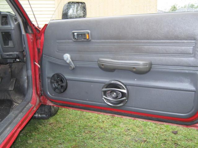

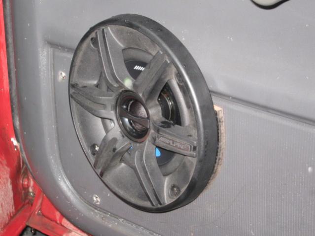

OK all sorted (Finally)
6.5 " and 4" in the doors.
With advice from me mate who workes at GEM Auto in Coffs and budget I had. Ended up getting JVC 6.5" with 16mm spacers and Alpine 4" no spacers but had to make uo a "C" type backing plate for the 4" speakers.
Sounds Ok but need to add sound dedening material, but I will save this for the replacement doors I have stripped ready for painting.
