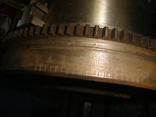

The factory flywheel on an EA82T , which I'm guessing is just the 4WD EA82 one , is really heavy . Mine was turned to lighten it and sent back to be milled because it was still too heavy .
If you get yours milled tell them to replace the timing marks otherwise you won't have any . I have a Vortex pointer on the front of my engine so alls not lost .

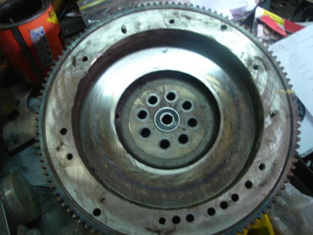

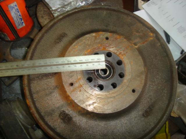

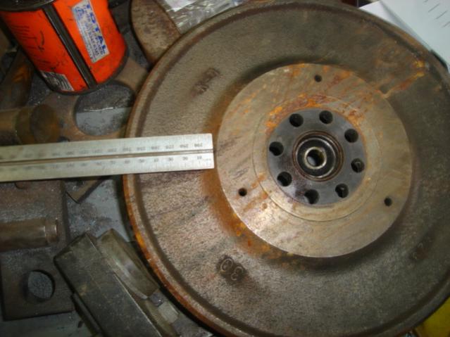

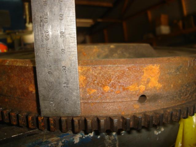

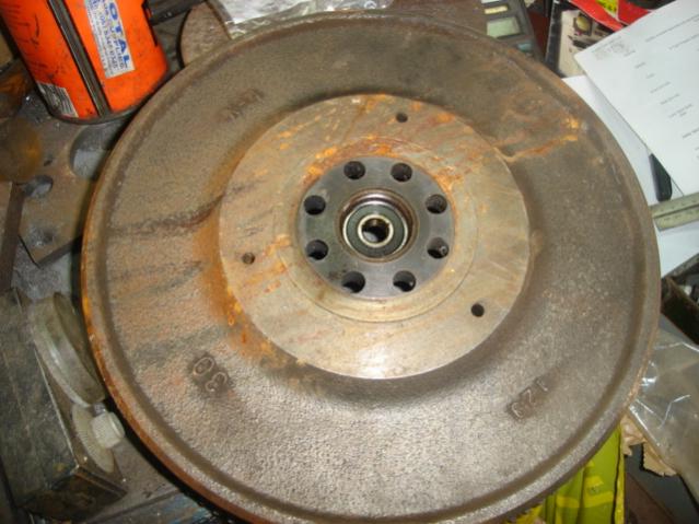

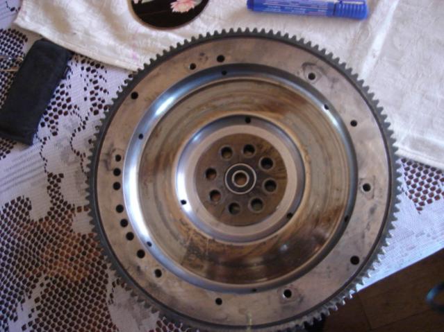

ok here are the before pics.
originally the flywheel weighed 12.5 kilos wich even on a road car amazed me

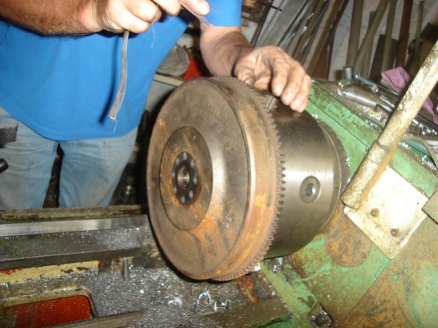

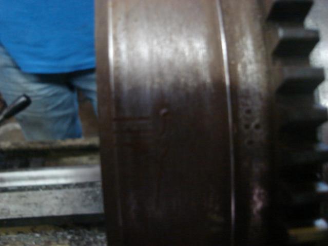

heres the work in progress and yes we did save the timing marks if you can just see them, they may stay they may not. depending on how well it works at the end

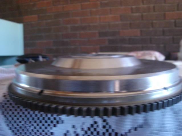

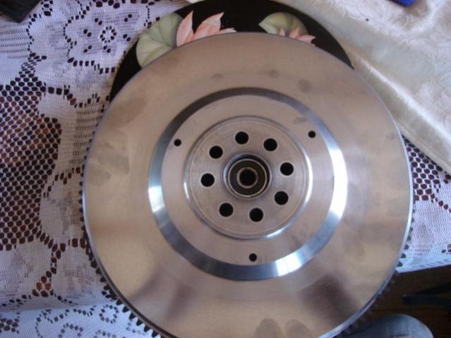

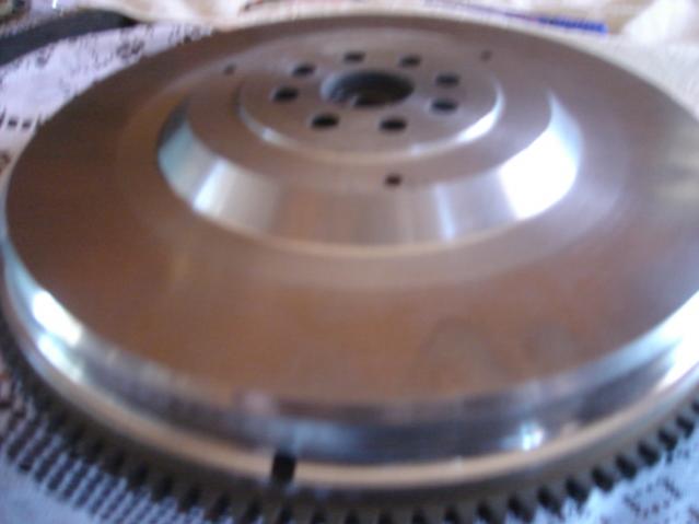

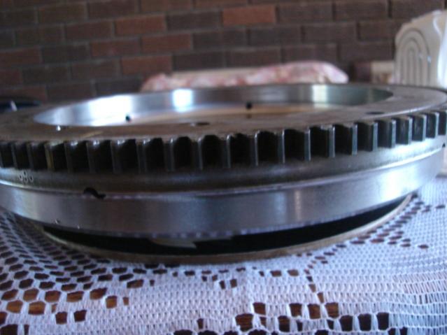

and the final finish.
total weight is now 9.5 so a reduction in 3 kilos now this mayy not sound like much but most of it is from the outside edge, so with the torque foot per pound it saves roughly 30 kilos in first gear at the wheels.
the engine is likely to go into a formula vee chassis and be used for hillclimbing, racing in formula libre and possibly offroading in single seater catagory. if we make the jump to the ej motor then yeah the engine will probably go into the road car

I did see mine after it had been milled and it did feel a lot lighter than another std one I have . From memory it was milled in the sections between where the pressure plate bolts down .

Looks alright i had about 5kg taken out of mine, looks something like this
you'll notice a huge difference.
Good luck with it.
