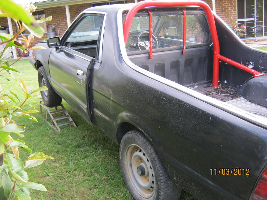

Mine are a different design to the above. Not sure what they are called (maybe 504) they have no centre cap.
This is the best shot i have of them atm Image.
If you want a better pic then let me know and i'll go take a close up. In terms of a price ??? they are rare and hard to find. I think that mine were a swap for a good working gear box many years ago now.

BlackMale wrote:maybe 504.
Yep, 504, The old school thing to do was to get the dome in the centre machined off, so the wheel will fit on an electronic wheel balancer, and Subie center caps fit.
This could be done properly on a lathe, or by putting the car on stands in gear and hitting it with the grinder!

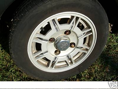

[ATTACH]1332[/ATTACH]
masterguitarshreader wrote:hey I want to get some 14'' wheels for my l series i have been looking at kings wheels but to buy these new with som decent rubber is prob gonna be around the $800-$900 mark so iam looking for a cheaper option. so if anyone running some pugs if you can could post some pics of what they look like and what the price paid for them. Info would be awsome thanks,
These are pug 505 turbo alloys, 4x140 15x6. Purchased on e-bay for 107.77 plus about 53.00 postage. Good luck!

The picture that subaru dude posted above is of their mags I know for a fact that they came out on the 505 STI but not so sure if all the turbos came out with the STI pack (Luxury model) but most of the ones I know of ended up with any of the other four stud rims as the ones pictured are for the european sized tire and were a hard to get and expensive tire to get however if you can find a retread mob that still does car tires they may be able to help you out, But as far as i know this size is getting increasingly hard to get!

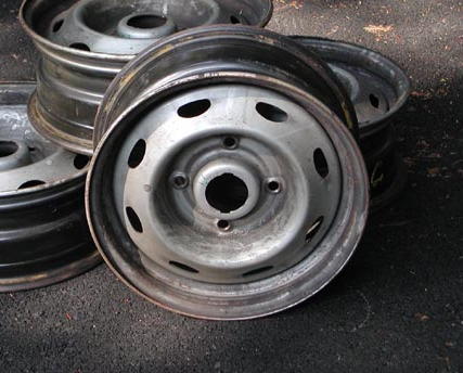

Here are some 15" 505 steel wheels i picked up. These ones only came out on the wagons and can be hard to find. Sourced mine from a peugeot wreckers through a family memeber that is a peugeot enthusiast. Needs a centre cap but measured it and its a 63.5mm or 2 1/2" across, so will fit quite a few american or aftermarket centre caps. Just chasing a set at the moment

Chopper05 wrote:Here are some 15" 505 steel wheels i picked up. These ones only came out on the wagons and can be hard to find. Sourced mine from a peugeot wreckers through a family memeber that is a peugeot enthusiast. Needs a centre cap but measured it and its a 63.5mm or 2 1/2" across, so will fit quite a few american or aftermarket centre caps. Just chasing a set at the moment
have you measured the width of the rim by any chance?
