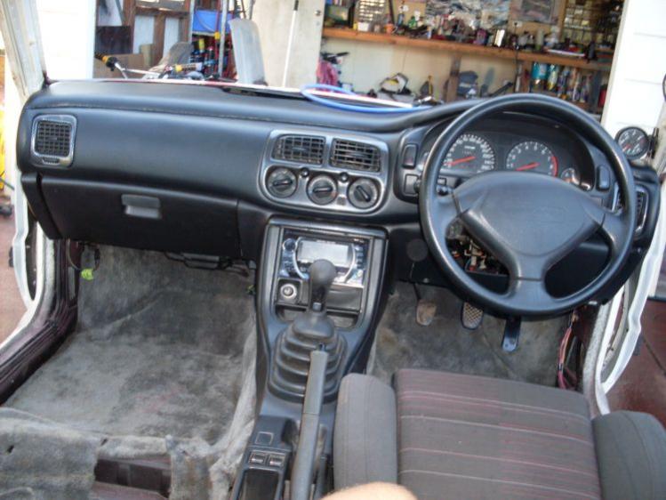

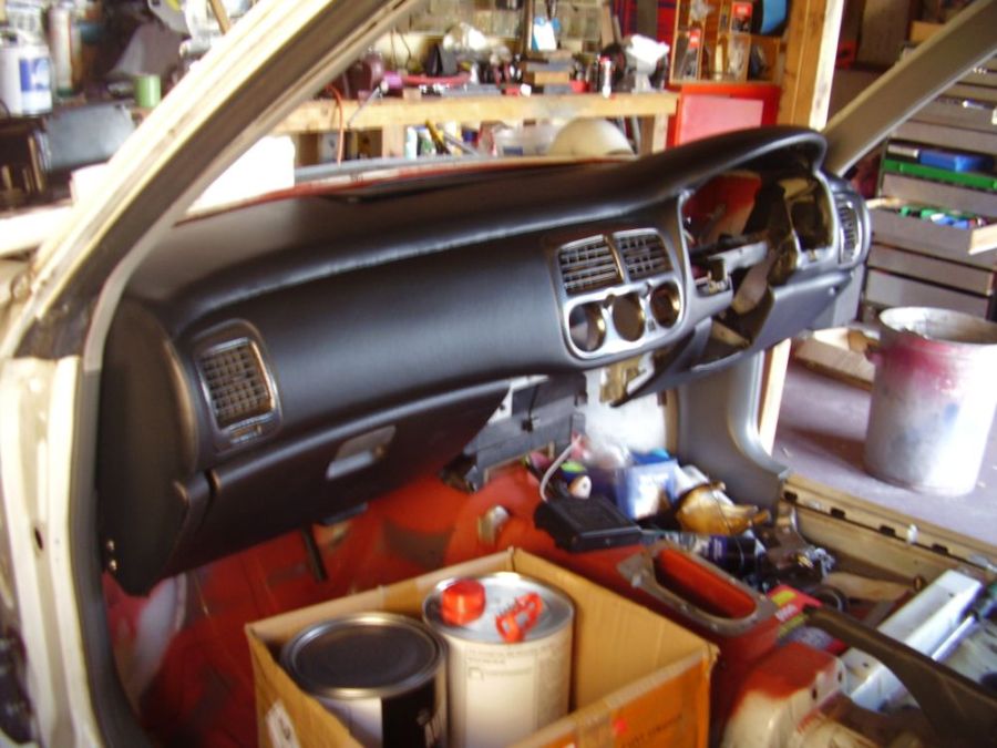

Post by 85wrx » Sun Sep 21, 2008 7:05 pm
Here is the latest pictures of the completed dash pad recovered and temp fitted. Not much has changed. Just completing alot of the little things that will tie the whole project together when it is done.

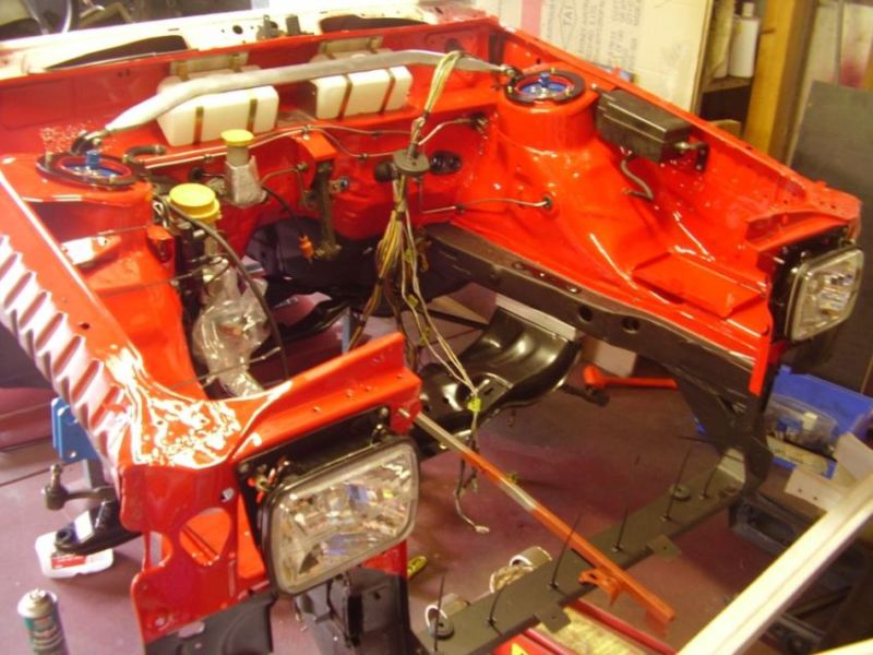

Post by 85wrx » Sun Nov 02, 2008 6:15 pm
Started the painting of the engine bay and assembly of some of the components. Today I fibreglassed a copy of a series 1 scoop to the bonnet. All the scoop ducting matches up perfect and will be removable. This is thanks to stainless ducting from zerosports. This will be it for a month off to work up north. Still aiming to get the engine in for good by christmas. This depends on the amount of work with the loom.

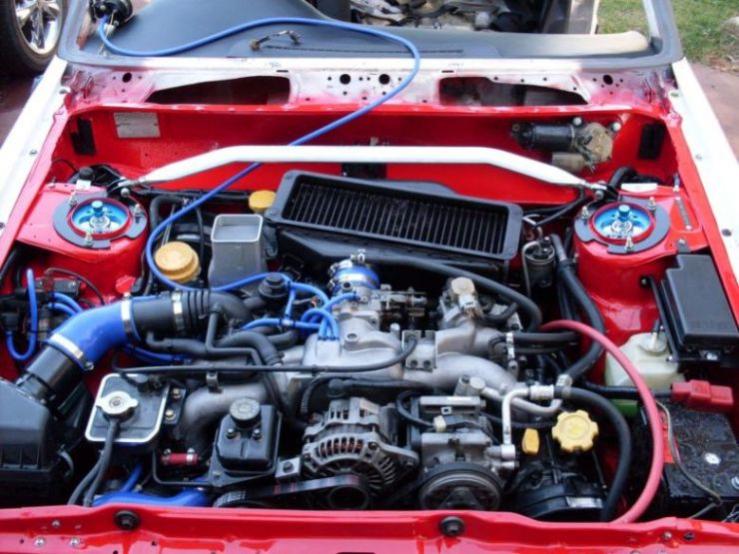

Post by 85wrx » Wed Dec 24, 2008 6:04 pm
I have completed alot in the last 2 weeks. The engine and gearbox is in, the wiring is 98% complete on the car, the engine bay is 95% complete and i have started the car and had it running. It is a tad noisy with just dump pipe and cat finishing at the back of the gearbox.
The climate control and dash is in, wiring is completed under the dash. All the switches and items work.
Today I started on finishing the front spoiler and started on the body work and prep ready to start and paint. I am aiming to have it finshed in another 6-8 months.
I will post some pics over the weekend showing where it is up too.

Post by 85wrx » Fri Dec 26, 2008 6:36 pm
As promised. Here are the latest pictures of the car as it stands.
dash new.jpg (63.25 KiB) Viewed 6922 times

nice...looks like its all ment to be there and thats the secret to a great conversion.....top effort
lovey80
Posts: 218
Joined: Sat Jun 09, 2007 4:54 pm
Post by lovey80 » Fri Dec 26, 2008 11:47 pm
Really good effort there mate? How long do you thin until it is finished. That dash looks really good was there a big problem getting it to fit? How long was the install?
