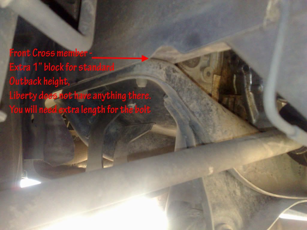

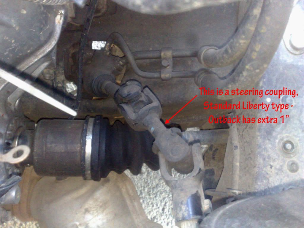

Thanks heaps for the photos AP!
Is a block actually fitted between those front rear control arm bushes in the Outback (second photo)? The Outback bushes I have are offset to bring the control arm down by approx 1".
I have a feeling that the steering coupling I have been given is from a Gen III Outback rather than Gen II. With the standard outback blocks fitted between the chassis and crossmember it seems too long. It's almost 2" longer (230mm) than the Liberty item (185mm).
Does anyone know 'for sure' whether or not the outback steering uni is a direct swap with the Liberty item?
