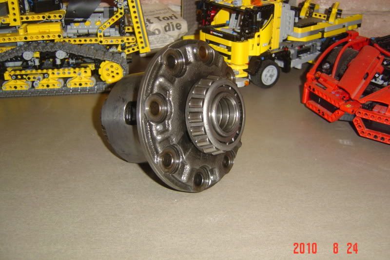

Okay so a little overzealous on the picture taking but the car is away for a week having some minor front end damage repaired and i got a little exited by the mail today.
Scored from RSLC forums, apparently suits pre-99 WRX driveshafts.

hehe Good find mate, I have one exactly the same only done 35,000kms straight from Japan, that diff is VLSD. not CLSD. Lovely Lego in background.. i miss lego days!

I was under the impression i was buying a plated LSD, i assumed that meant clutch pack, as clutch = plate. Took some more pictures to confirm. Looks like the clutch plates i have seen on the internet, although apparently the VLSD has some too?
Grooved plates stacked on top of eachother, compressed together with a concave washer thing that i'm holding in my hand.
Also i could have a VLSD already in the rear? Shouldn't these behave as an open diff untill the liquid is heated sufficiently to engage the mechanisms inside? Thats what i just read on USMB anyway. So could this mean when its cold that both rear wheels turn in opposite directions? Not fussed if this is the case since i won't have to machine the diff housing to fit my latest purchase.

Yep that is definitely a plated diff or CLSD
The viscous centre diff looks identical because the outside case is the same as the clutch type unit.
The viscous centre cannot be dis-assembled like the clutch one can

That's great news for you Rhys. Make sure you "shim" the springs that clamp the plates for extra pressure on the plates = a tighter LSD :twisted: You do this by adding the same number of washers of a certain thickness to the springs - that's what I've read on quite a few forums while looking into Hilux diffs... Don't ask why...

El_Freddo wrote:That's great news for you Rhys. Make sure you "shim" the springs that clamp the plates for extra pressure on the plates = a tighter LSD :twisted: You do this by adding the same number of washers of a certain thickness to the springs - that's what I've read on quite a few forums while looking into Hilux diffs... Don't ask why...

LSD shim might be on the cards. Will start with it as is and see what it is like.

Thanks for clearing that up mate, i was getting a bit worried!

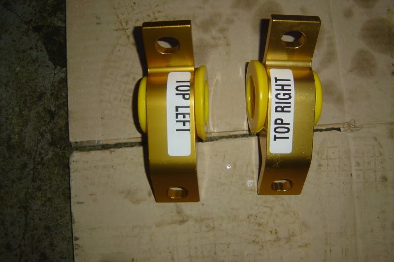

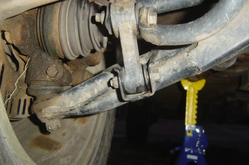

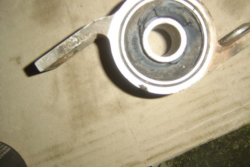

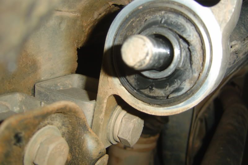

So i've had an annoying knock in the front end ever since i first took the car off-road nearly a year ago now. Finally took it to a suspension shop the other week and they pointed and pried at a few bushes that were doing sweet FA.
So i made a few whiteline purchases
Also bought front and rear swaybar links. Fronts links went in, still waiting on buying an Outback swaybar to fit the rears.
So much play in this...
Cactus.
Cactus.
I stopped taking pictures because it started pissing down and i had to get everything finished so i could move the car. I live behind a shop so i can only work on my vehicle in the carpark when the owner isn't at work. PIA.
The anti-lift/caster kit actually improved the turning circle because they moved the tyres away from were they were fouling inside the wheel well. Interestingly it also stopped my vehicle pulling left at the slightest hint of road camber. So anyone with that annoying pull left should consider checking these bushes.
Alignment to come after I need to replace the steering rack boots. Will post a comparison of before/after the antilift caster kit.

did you release the control arm bushes when the new taller suspension went in? Thats most likely why they are torn
Venom
Posts: 1044
Location: Ballarat
Post by Venom » Wed Nov 03, 2010 10:58 pm
vincentvega wrote:did you release the control arm bushes when the new taller suspension went in? Thats most likely why they are torn
No i didn't even think of it, makes sense now that you've mentioned it.
vincentvega
Posts: 2446
Location: Brisvegas
Post by vincentvega » Thu Nov 04, 2010 8:33 am
always a good idea to back off the nut on these, install new suspension, then nip the nut up with the car on the ground.
