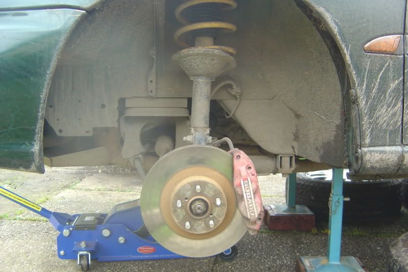

4 pots!

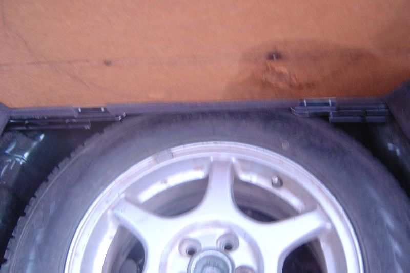

27" tyre in the spare wheel well.

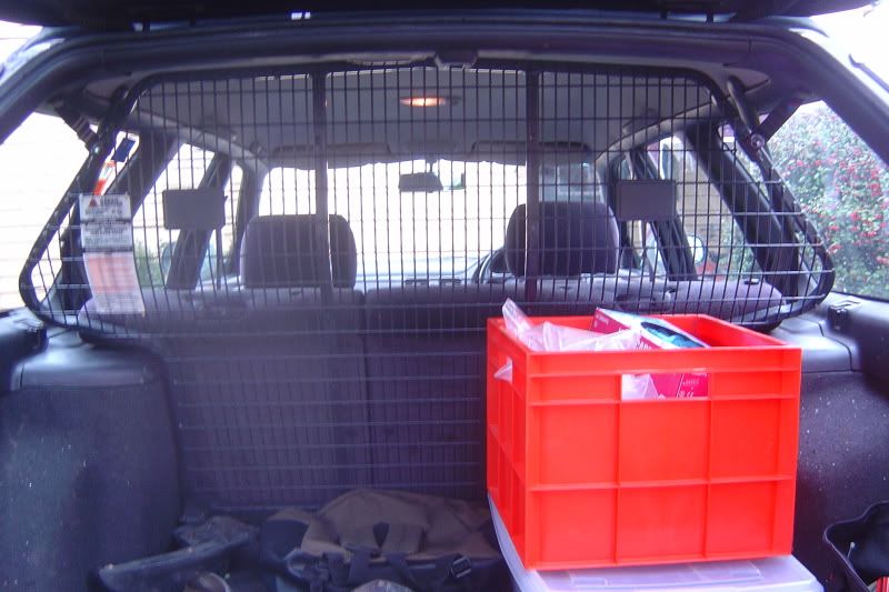

Ebay cargo barrier with freebie fitting kit.

Vented rears.
