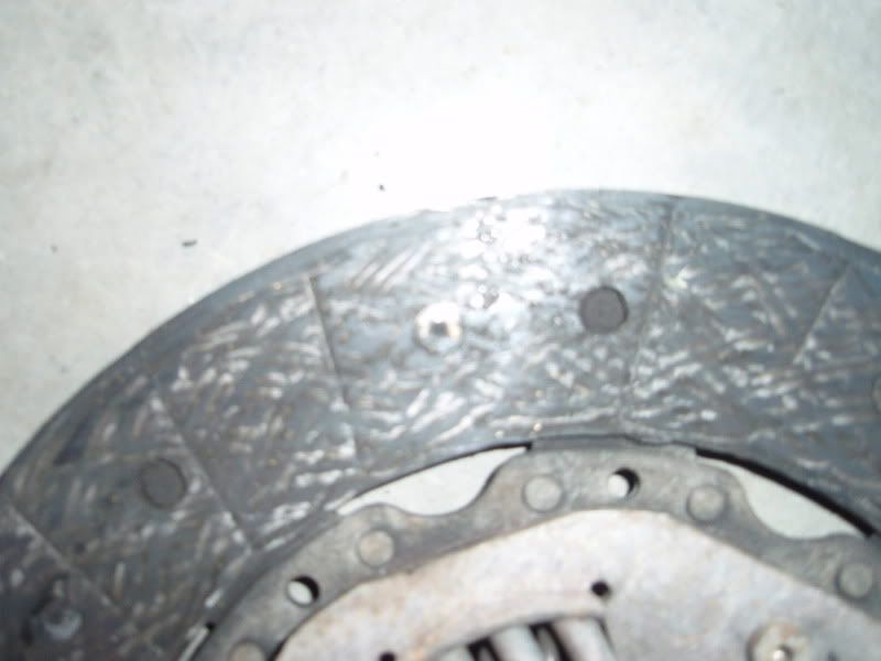

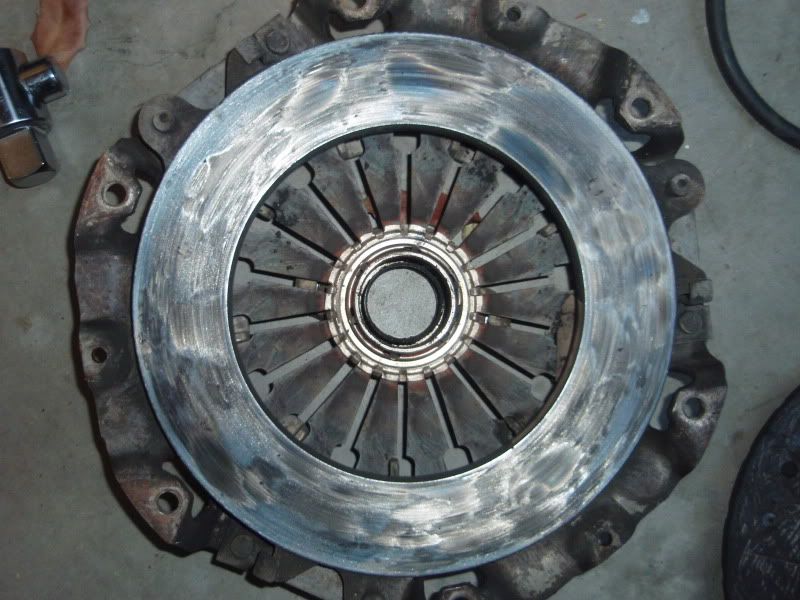

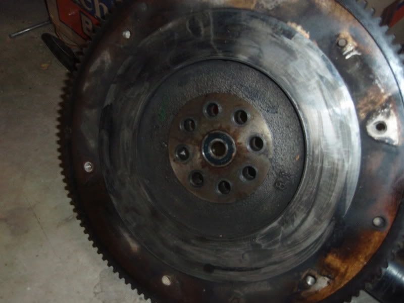

This is what happened to my clutch/flywheel/pressure plate after copping a H6 hiding with no low range for the past 18 months. Going with a new standard EJ22 pressure plate and clutch to make sure the new box doesn't break.

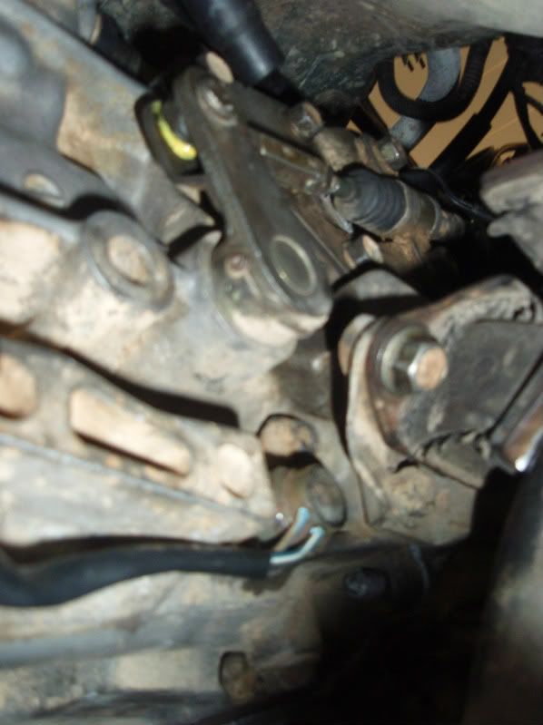

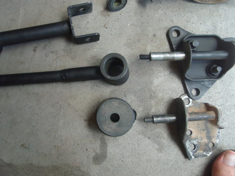

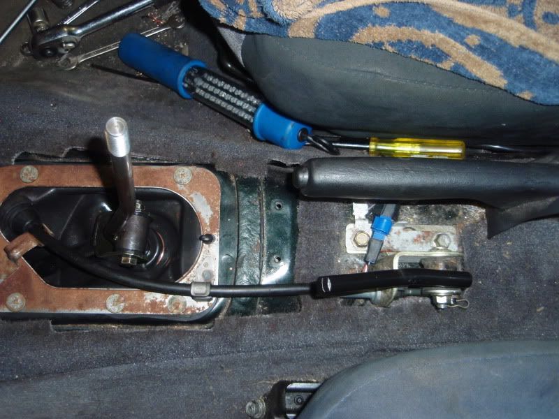

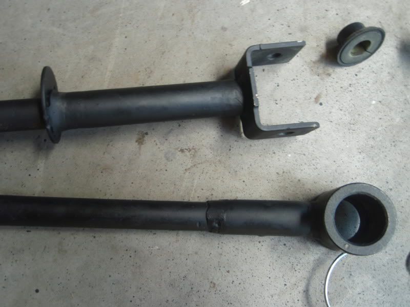

Liberty shifter linkages with L linkage bush on the end. The liberty one fouls on the L series rear casing thats on this box.
Where the linkages have been extended.

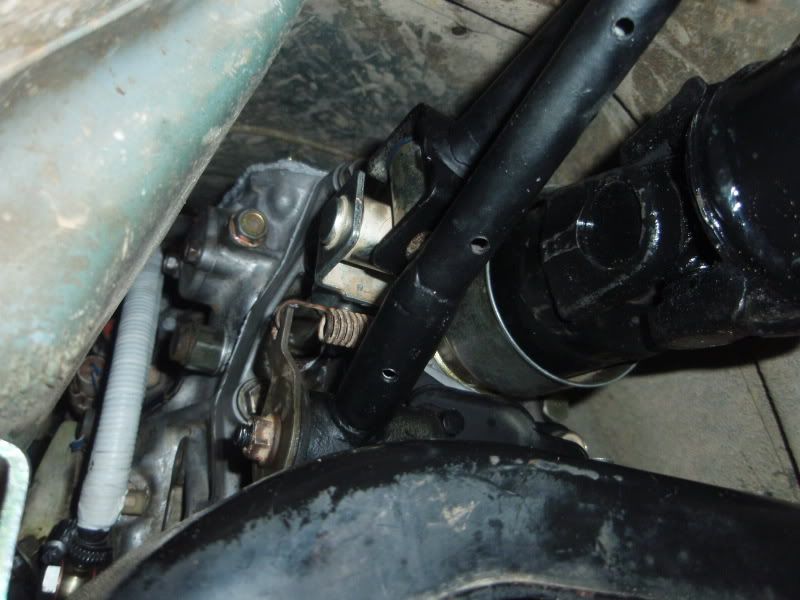

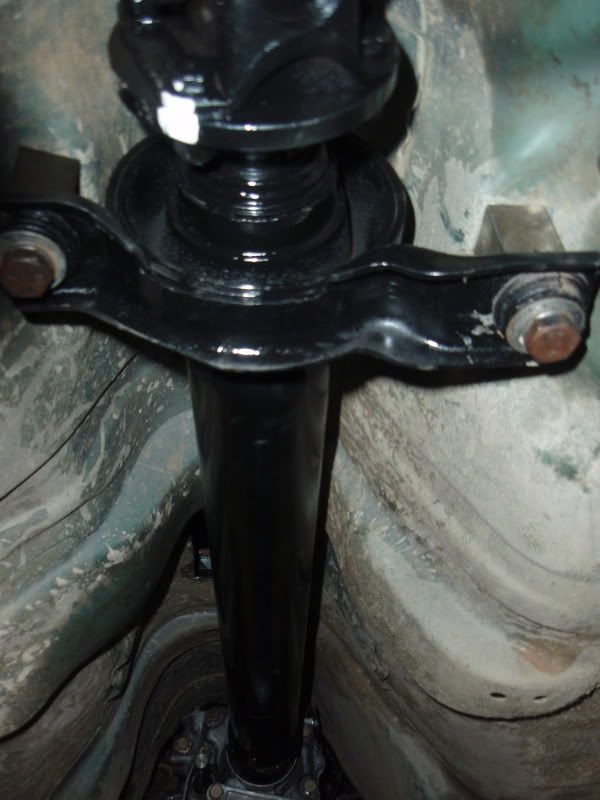

Custom driveshaft/tailshaft. L series centre bearing carrier with two MY driveshafts cut down for new front and rear sections. Uni joints replaced with new greasable items.
New gearbox is 62mm shorter, so the front driveshaft section had to be lengthened to suit.

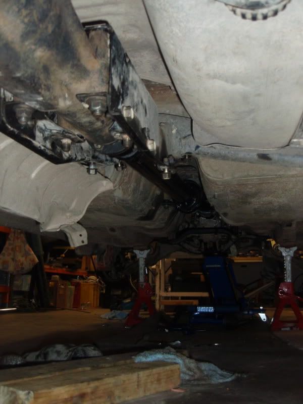

L series gearbox mounts fitted to the Liberty gearbox crossmember. Not perfect, will see how they hold up.

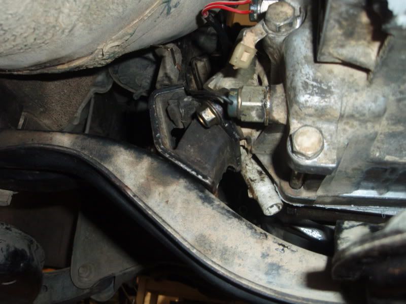

Servo's to operate the centre diff lock.

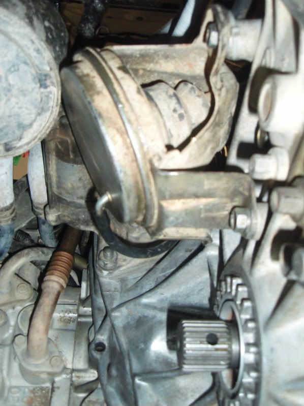

Centre diff lock vacuum/diaphram thing.
Diff lock lever on the side of the gearbox

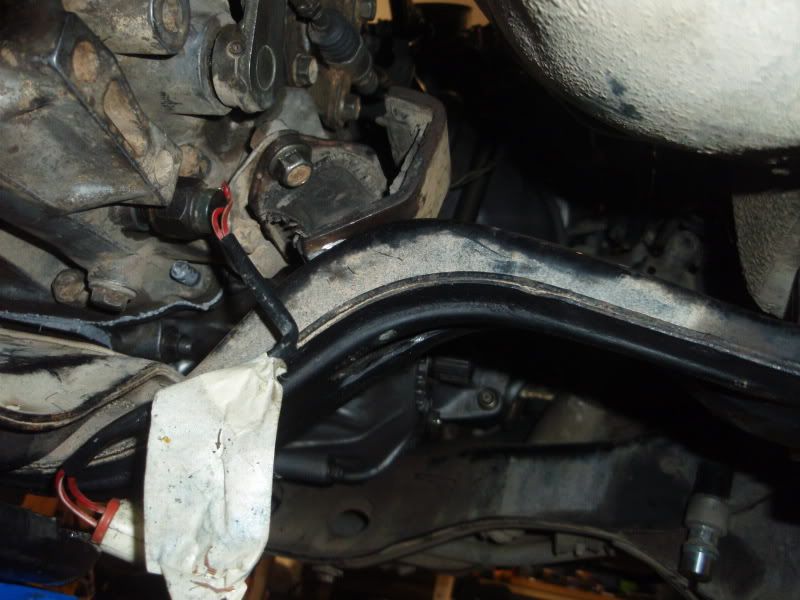

Linkages in placeImage
You can see the holes we used to screw a plate to the cut up linkages to hold them in place untill we got them to the bloke who made up my tailshaft. He Mig'd it for me for nothing and with 30 mins notice on a Saturday morning, good bloke!
Liberty shifter linkages fit perfectly snug inside L series linkage tube, which were used as the tubing to cover the extension.

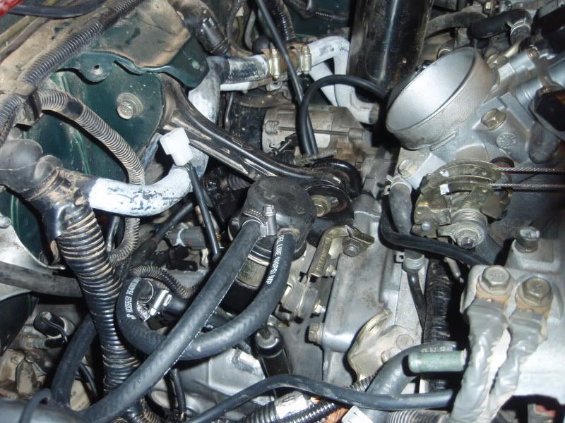

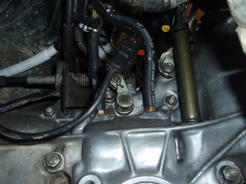

Currently in the process of plumping up the oil lines which will drip feed onto the low range gearset. They are plumed into a banjo bolt on the rear of the gearbox to a MY fuel pump in the engine bay and onto two barbs fittings welded onto the gearbox casing (just over the low range gearset). It's been a bit of hamfisted fabricating to mount the fuel pump. More pictures as things get done.

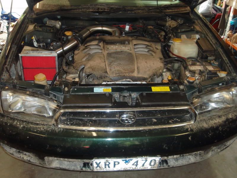

7 days of work and its finally done. Beer time.
MY fuel pump mounted on the gearbox, this is running the oil feed for the low range. Sort of in the way of the dipstick, but i can put oil in and check the dipstick easily enough.
Here you can see where the oil feed goes into the gearbox for the low range.

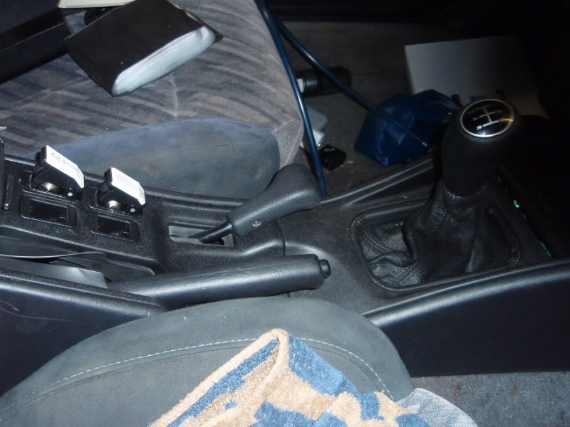

Rocket switches for centre diff lock and the oil pump. They look OK, mainly i needed to idiot proof it for the G/F if she takes the car.
Dirty H6 PORN.

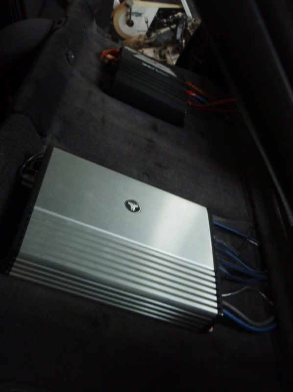

I put a cargo barrier in a while ago. It left some space between the back of the seat and the barrier, perfect place for some noise machines. 4 channel for the speakers and a monoblock for the amp.
