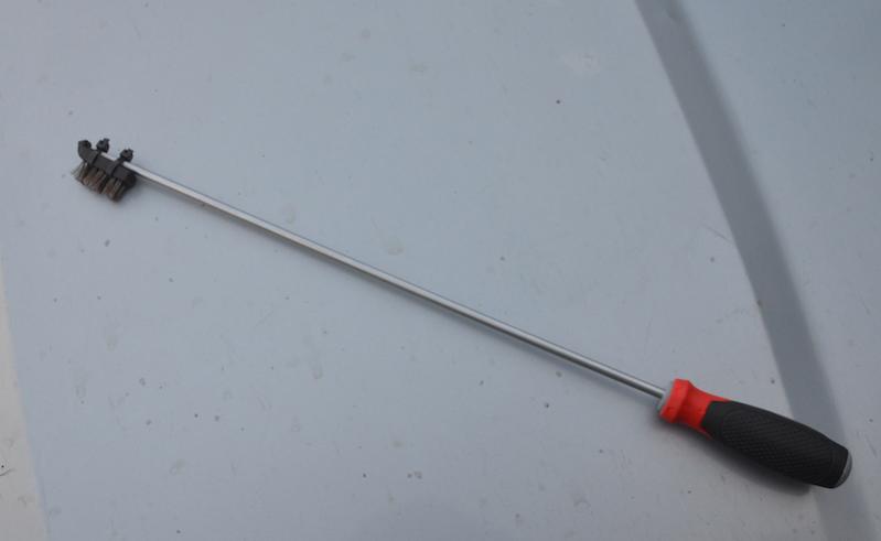

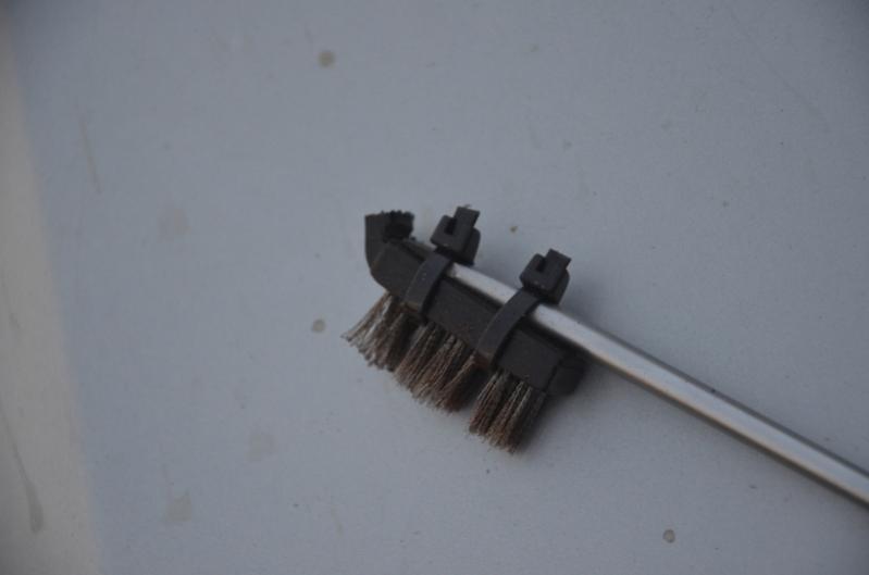

I knocked up this little beauty tonight to help out in a very hard to get to place:
And this is what I've needed it for:
- Scrubbing rust before it got an acid treatment :D This brush will be cleaned and used to scrub the acid before it get's a sealing coat of red oxide paint.
Good times. Total cost ~$11. Made a difficult job easy!
